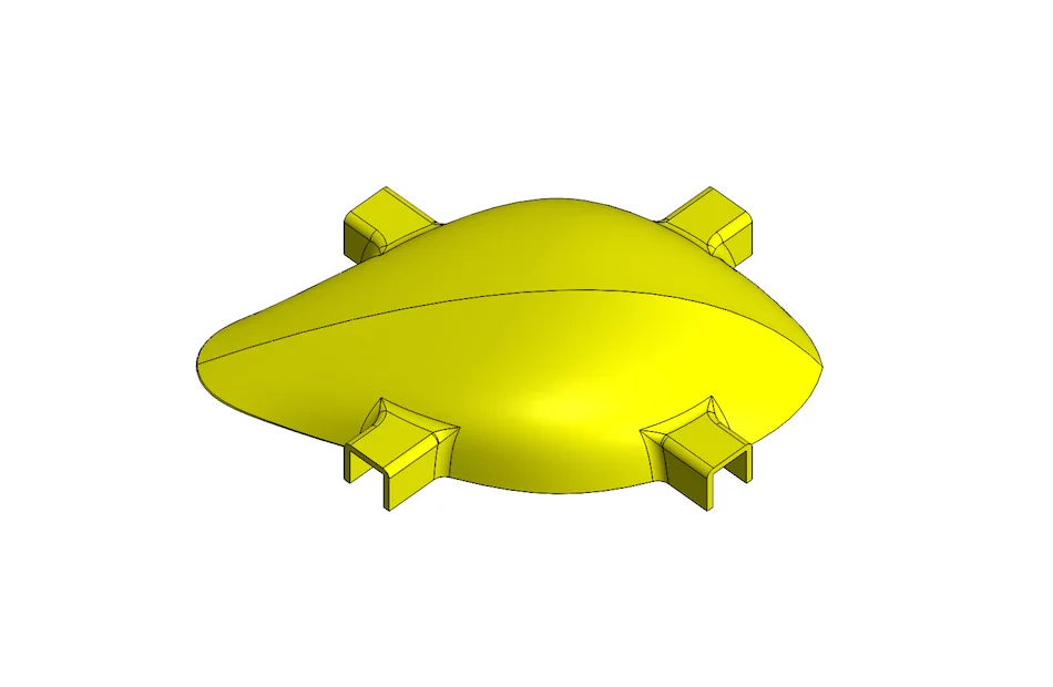

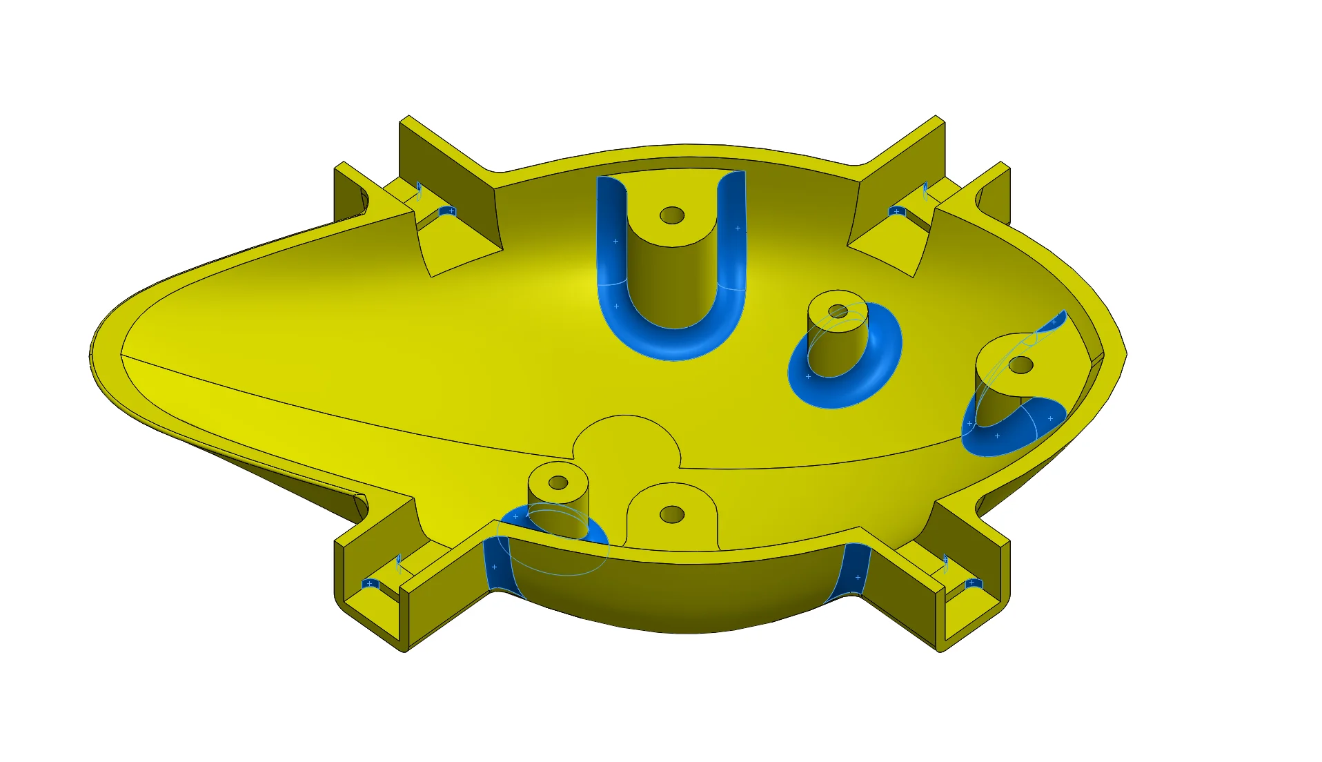

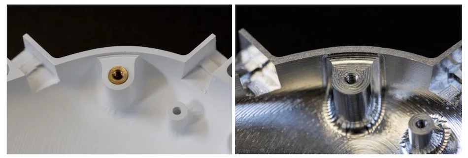

The top half of the drone body, though organically shaped (which should generally be avoided to save costs in CNC, unless it is absolutely necessary), is otherwise simple in design. On its underside are three large screw bosses, used to attach the bottom half of the body, and two small screw bosses, to which the control board fastens.
In the 3DP and CNC ABS versions, the large bosses were designed to have press-in and heated inserts, to create robust threading that could be used repeatedly (plastic threads tend to wear over time); on the CNC aluminum version, these bosses were tapped directly.
In each leg attachment point, the four rectangular u-channel features around the perimeter of the top, there is a small rib. This is a mating feature for the snap-fits on the legs to hook onto, a mechanism that is discussed more in the section below, about the leg design.
A third design aspect to notice is that every internal edge on this part, where two faces meet at an angle less than 180°, has a fillet added (see image above with fillets highlighted). Though unnecessary with 3D printing, this is absolutely critical when CNC is to be the final process, as this type of machining uses round tools that are unable to cut sharp corners.

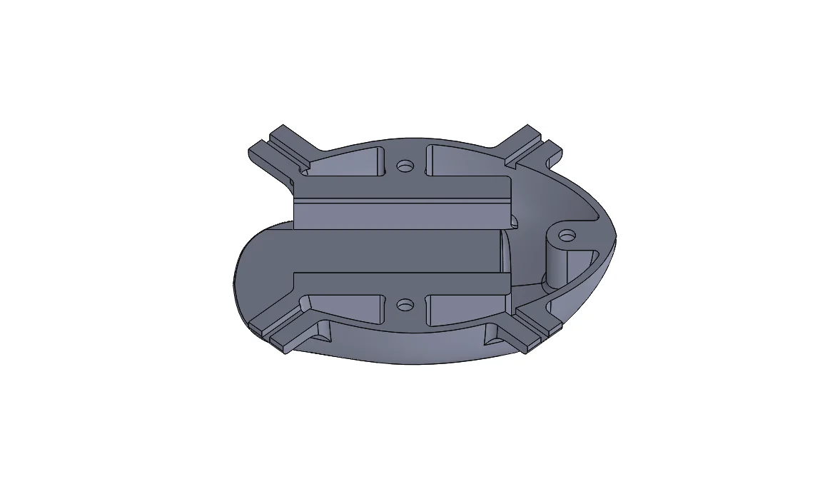

From the outside, the drone’s bottom half is quite similar to the top half. Again the design is organic, which 3DP processes tend to handle with few issues (other than visible build lines), but is usually expensive and time consuming to produce with CNC.
The most prominent area inside the bottom is the rectangular battery pocket. Instead of being a closed box, it is open to above, and an undercut ledge on either side helps constrain the battery vertically. This design eliminates the need for an extra set-up to machine the pocket from the side. While undercut features require a special CNC tool called a keyseat cutter, they are achievable, as long as the cut depth is not too extreme. Harvey Tool is a good resource for commonly available cutters, so you can make sure your design can be produced.
Around the battery pocket are several more pockets (again, filleted to account for CNC tooling) that follow the contours of the part’s shape. The only function here is for weight reduction, since this baby is destined to be airborne! If this was not a requirement, these pockets really only add complexity to the structure and should probably be left out.

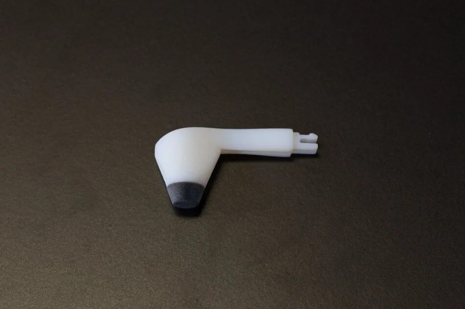

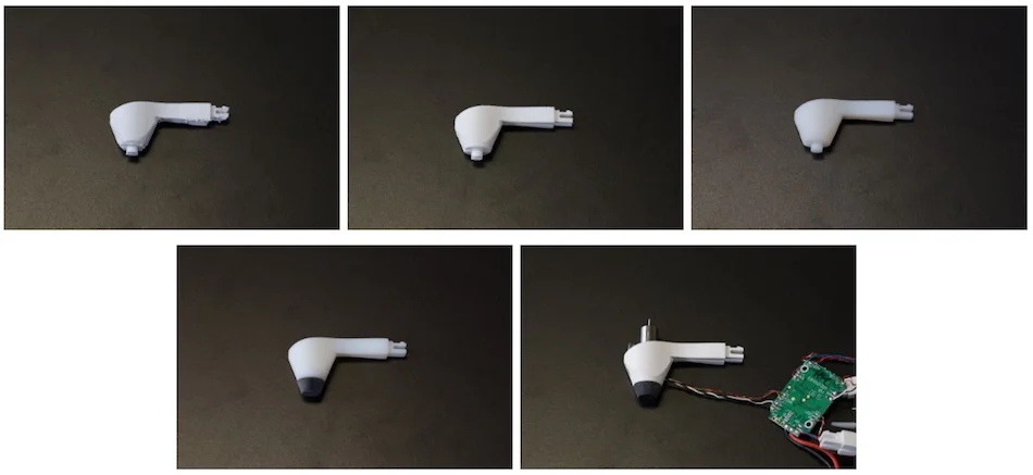

Moving away from the body, the legs were the next part we designed. These were created in a wide variety of printed materials but only machined in ABS, due to weight concerns of aluminum (doing everything in metal would have been far too heavy for the tiny motors).
The most challenging feature on this part is the snap-fit tab, the geometry of which had to be carefully tweaked over several printed revisions (see above), to ensure a tight fit with the drone body before moving to CNC. If the fit was too tight, we’d risk tab fracture upon assembly.
Producing the motor pocket at the correct size was also somewhat tricky. 3D printed materials, even high resolution ones, tend to produce slightly undersized holes, so in CAD, they must be bigger than needed. Conversely, CNC can produce extremely precise features, so after the overall leg geometry was confirmed in VeroWhite, the motor pocket again had to be resized, to ensure it wouldn’t be too loose when the ABS plastic was cut.
A third fun feature that was only present in the printed version of this part was overmolding a Rubber-like foot onto the VeroWhite leg (in the CNC version, the foot was press fit over the leg). Multi-material prints like this are a great way to simulate multi-shot injection molded parts, without having to cut expensive tooling.

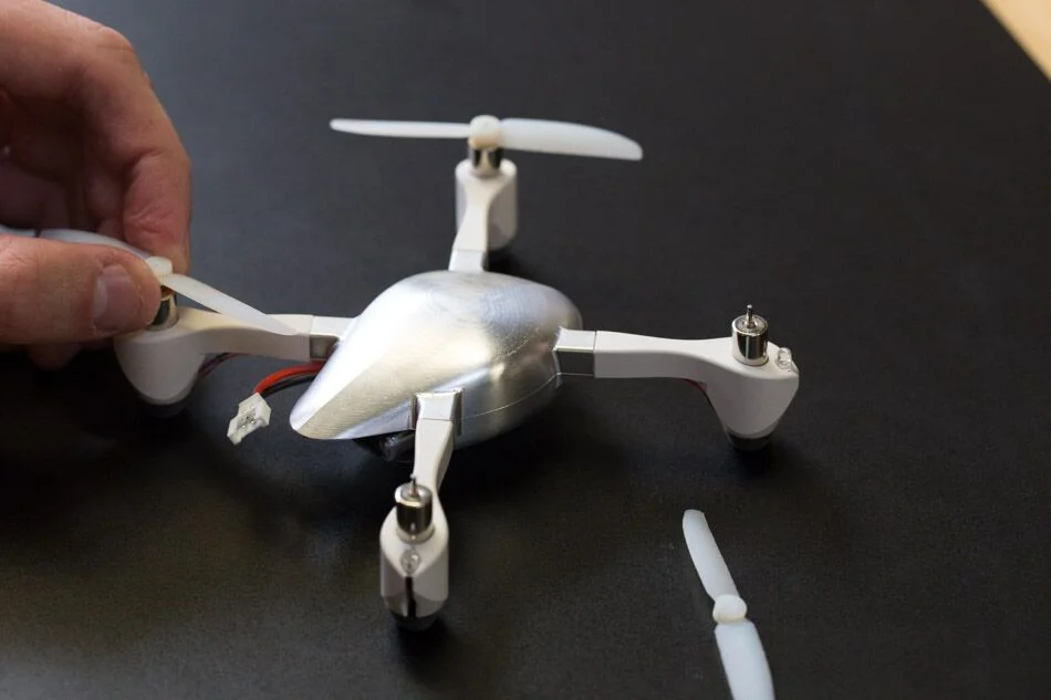

Final assembly
Once all parts had been refined to a satisfactory design point, and the CNC versions of the body and legs were cut, it was time to assemble everything! Most mating parts had already been test fit during the design phase, so assembly was a breeze (mostly).
All the electronic components fit inside the body without a hitch, as did the motors and LEDs in the legs. The holes in the propellers were slightly undersized, as planned, so they press fit smoothly onto the motor shafts. The biggest challenge was carefully routing the wiring from the legs through the channels underneath the snap-fit and into the body, then snapping the legs into place without pinching the wires. This took multiple sets of hands and would definitely be reconfigured in a future revision.With the drone assembled, the real question was, would it fly? The answer: Sort of.
The first test resulted in the Fictiv drone gliding across our test bench, more than actually flying. Everything was functioning, so why weren’t we airborne? There are likely a few contributors (more robust propellers would definitely help), but the easy answer is weight. Using electronic components sourced in a design than has been scaled up by roughly 20% from the original pushes everything to the limit of its operating capabilities. Add to that the fact that the body is aluminum, rather than plastic, and it seems surprising that there was any movement at all. Indeed, replacing the aluminum body with the machined ABS one resulted in slightly better performance—pretty darn good for a first fully assembled prototype, but still room for improvement.
