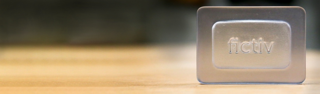

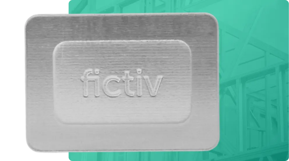

Material Finish
VeroClear has a translucent finish. The part printed as-is prints clear enough that light and the shape of objects can be made when looking through the part, but is not ideal for glass-like clarity. This is a high resolution print, however, so you won’t see build lines when looking at the part directly on the surface that was printed laying flat on the print bed.
Sanding + Clear Coat for Increased Transparency
If you need slightly more transparency than what the standard print achieves, sanding the part and adding a clear coat will help. Here are the steps:
  1. Sand part using 180 grit sandpaper until build lines aren’t visible.
  2. Move to 400 grit sandpaper and sand again until surface become smoother.
  3. Move to 600 grit sandpaper and do a wet-sand until you start to see through clearly.
  4. Apply a Polyurethane Clear Coat layer and let dry for 20 minutes to 1 hour.
  5. Apply another Polyurethane Clear Coat and allow it to dry.
  6. Repeat steps 5 & 6 until desired transparency.
