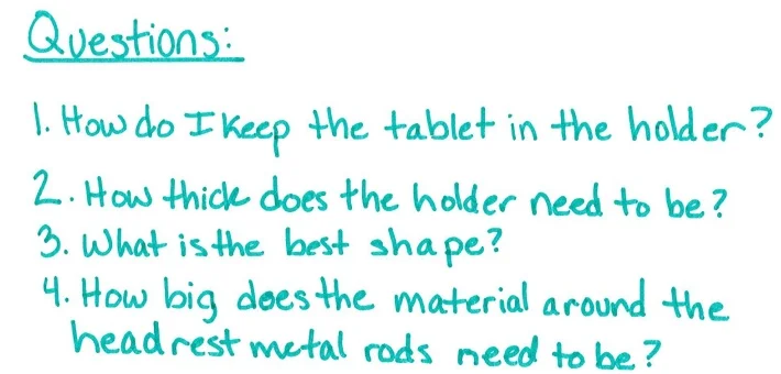

- Question: Ask why this problem needs to be solved. What do we hope to solve? I put the answers into a desired or outcome column.

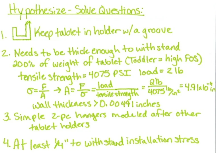

- Hypothesize: Make a hypothesis or an educated guess as to which design works best. Answer your problem questions to finalize the design conceptualization, involving any hand calculations for things like minimum material thickness needed to withstand loading. Now’s a good time to make some hand sketches and share the preliminary design concepts with team members to get initial feedback. Once I have a clear understanding of the project’s requirements, I start conceptualizing the design. Factors to consider here are form, fit, and function to create an aesthetically pleasing and functional design.

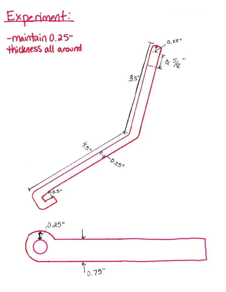

- Experiment: Utilize all information gathered in steps 1-3 to start modeling. This involves sketching rough ideas on paper and brainstorming with colleagues to create a draft version of your 3D model.

Here’s an example of the design process for a tablet holder for my toddler’s kindle fire to attach to a headrest in my car:

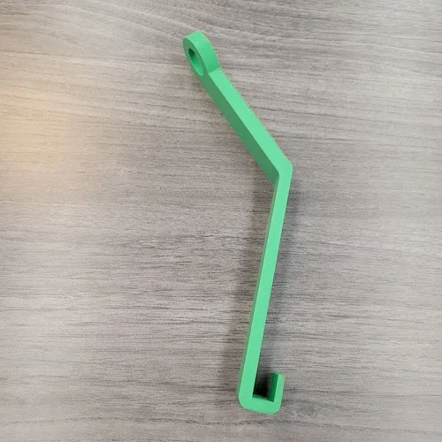

Result:
And here’s what the 3D printer produced:
It’s rigid and tough, and fits the tablet perfectly, so the project was a success! No further iterations are needed.
