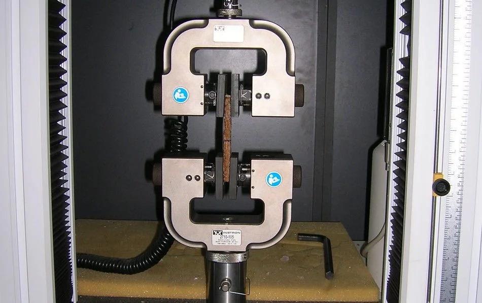

Tensile strength is the most common measure of strength in materials and also the most likely number for the nerds in your life to have memorized, and for this reason, it appears at the top of most data sheets. For older engineers, such as all of our professors, any study of strength of materials used to focus on the tensile test for all the useful information it provided, especially in looking at metal properties. With polymers taking over in design, we need to perform other tests to get the same depth of information on plastic materials, but this remains the best starting point for deciding if a material is right for your application.
The tensile strength test is straightforward: A small piece of material is held between two clamps on a hydraulic press, and one of the clamps pulls on the material until it breaks. From this simple test, we can find the ultimate tensile strength (UTS—how much stress it can take when it breaks), the tensile strength at yield (how much stress the material can stand before it starts to deform permanently), the modulus of elasticity (also called Young’s Modulus, meaning how much it deforms under stress), and the elongation at yield (basically, how much it stretches before it snaps).
Oh, no! We can hear the yawns from here. What do these terms mean, and why should you care?

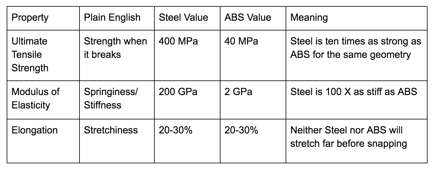

In their direct form, they give you an easy way to compare strength between materials. For instance: ABS is a nice strong plastic and has a UTS of 40 MPa. Steel is a nice strong metal and has a UTS of 400 MPa. Wow—steel is ten times as strong as ABS for the same size. I didn’t know that. (See! I’m not that nerdy!) Now, of course that doesn’t mean that you should abandon plastics for steel, but it does mean that parts of the same strength will need to be much thicker.
Similarly, the modulus of elasticity allows us to have an at-a-glance idea of how “springy” the material is, whether very stiff (steel – YM of around 200 GPa) or quite flexible (ABS —around 2 GPa), and the elongation at yield (or sometimes at break) will give you an idea of just how far you can pull the material before it becomes an issue (here steel and ABS compare well, with 20-30% for each, depending on the specific material). See? Useful. You should definitely keep a nerd around for interpreting these things.

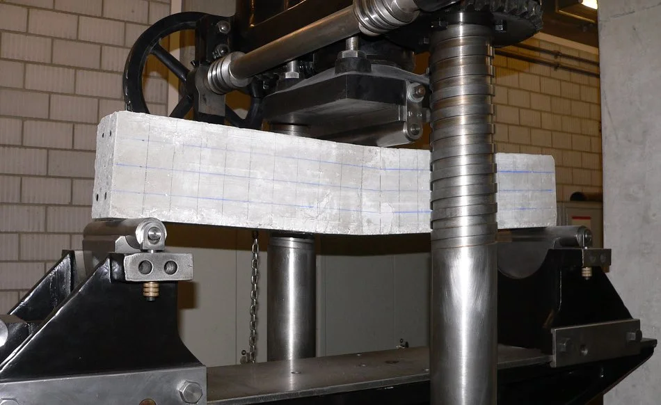

Flexural properties are similar to tensile properties, and in many materials can be approximated from the same measurement. However, for accuracy, especially in plastics, it’s best to perform a three-point flexural strength test, where a bar of the material is placed across two supports, with a hydraulic head pressing in the center, which gives us flexural strength and flexural modulus, which in homogenous materials are the same as the tensile strength and modulus, but…wait, wait, come back!
Let’s break that down a bit. Essentially, if a material is perfectly the same all the way through, the way most steel is, then the flexural test will give you the same numbers as the tensile test. But plastics are almost never the same throughout the cross section—because of injection molding, the material will form a skin of material that doesn’t match the rest of the material.

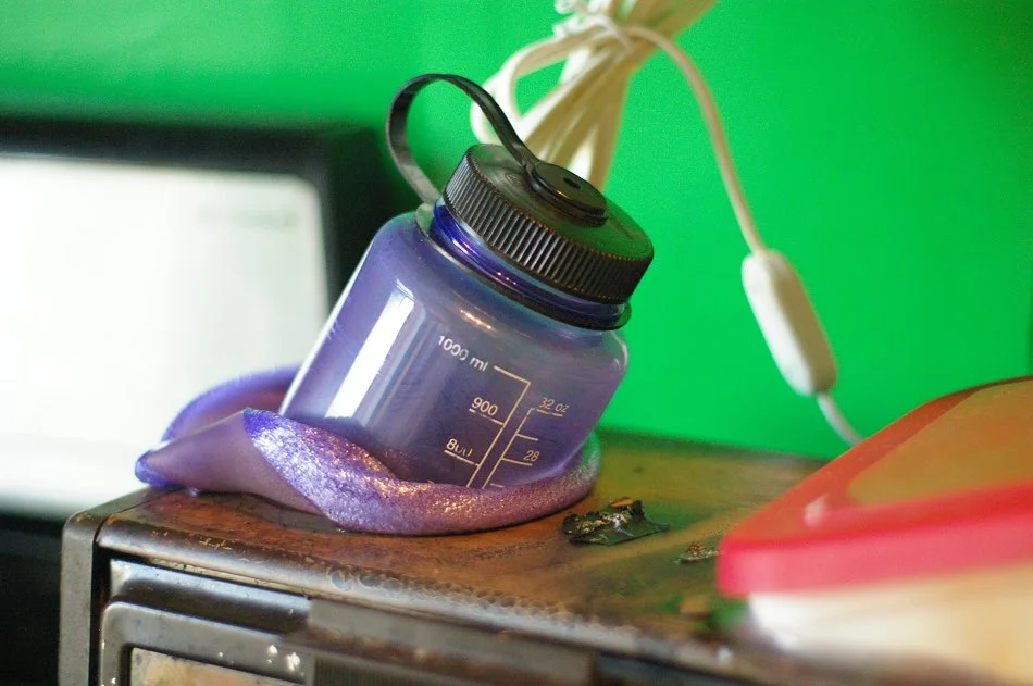

In the same way you have to worry about materials becoming brittle when it’s cold, or snapping when a load is sudden instead of gradual, for some applications, you’ll also need to think about what happens when it’s really hot. You know what I mean if you ever came back to the car from shopping with your parents to find that the car had melted your favorite Barbie.
While this is less of a concern for metals, plastic properties dictate that for the most part, when they get hot, they get soft. Fortunately, this is covered on material data sheets, too, under the thermal properties section, where you’ll typically find several notes on heat deflection temperature, and sometimes a glass transition temperature.

Glass transition is a little more complicated, and only applies to amorphous materials: materials that don’t have a crystalline structure (such as polycarbonate and polystyrene, as opposed to crystalline polymers like nylon and polypropylene). Basically, when an amorphous material gets warm, it goes from being brittle to being rubbery, and that happens at the glass transition temperature.
You’ll have to care about this for two reasons: You don’t want your rubbery parts to become brittle, and you don’t want your hard parts to become rubbery. For instance, if tire rubber gets much below minus 100 F, you have to worry about shattering it; if ABS is heated above 220 F, it starts to behave like flubber (minus the dancing). And speaking of rubbery materials…
