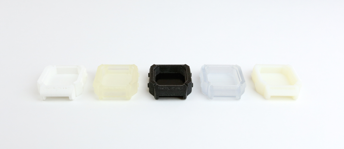

In the world of plastics, there are a lot of different options for a designer to choose from. There are so many plastic materials, in fact, that the process of selecting the proper 3D printing plastics for prototyping and subsequent manufacturing plastics for production may seem intimidating. This article seeks to clarify the main types of plastic materials available, as well as applications for each.

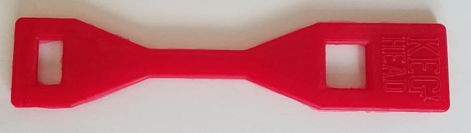

The image below details a plastic component in its original state, and again after it has been loaded past its yield strength.
As we can see, the part is now permanently deformed, due to excessive force. We could not expect this part to perform as it was designed because we have exceeded the yield strength of the material.
Ultimate Strength
Ultimate strength is much like yield strength, except it’s the stress at which the part fails completely. The image below shows the same component from above that has been loaded even further and completely separated.

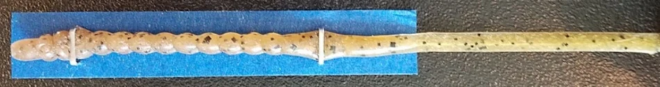

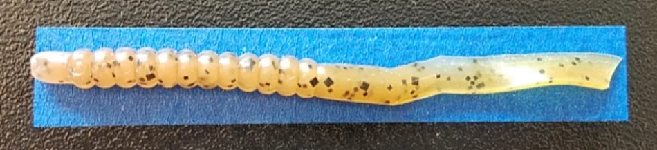

Also known as elastic modulus, this is the amount that a material will “stretch” when a load is applied. If we remain below the yield strength, the part will return to its original shape after the load is removed. More details of this concept are detailed in the article mentioned above.
The image below shows a fishing lure that is made of an elastomer in two conditions: the original state and stretched.

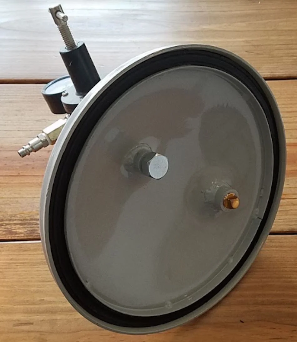

While the material has stretched quite far, it will return to the original state when the load is removed. Elastomers are also commonly used for gaskets and seals. The image below shows an elastomeric ring gasket on the bottom side of the lid for my pressure chamber.
This elastomer holds 60 psi while the chamber remains pressurized and prevents the captive air from leaking off. Gaskets similar to this can also be found on blenders, travel coffee mugs, and many other items.

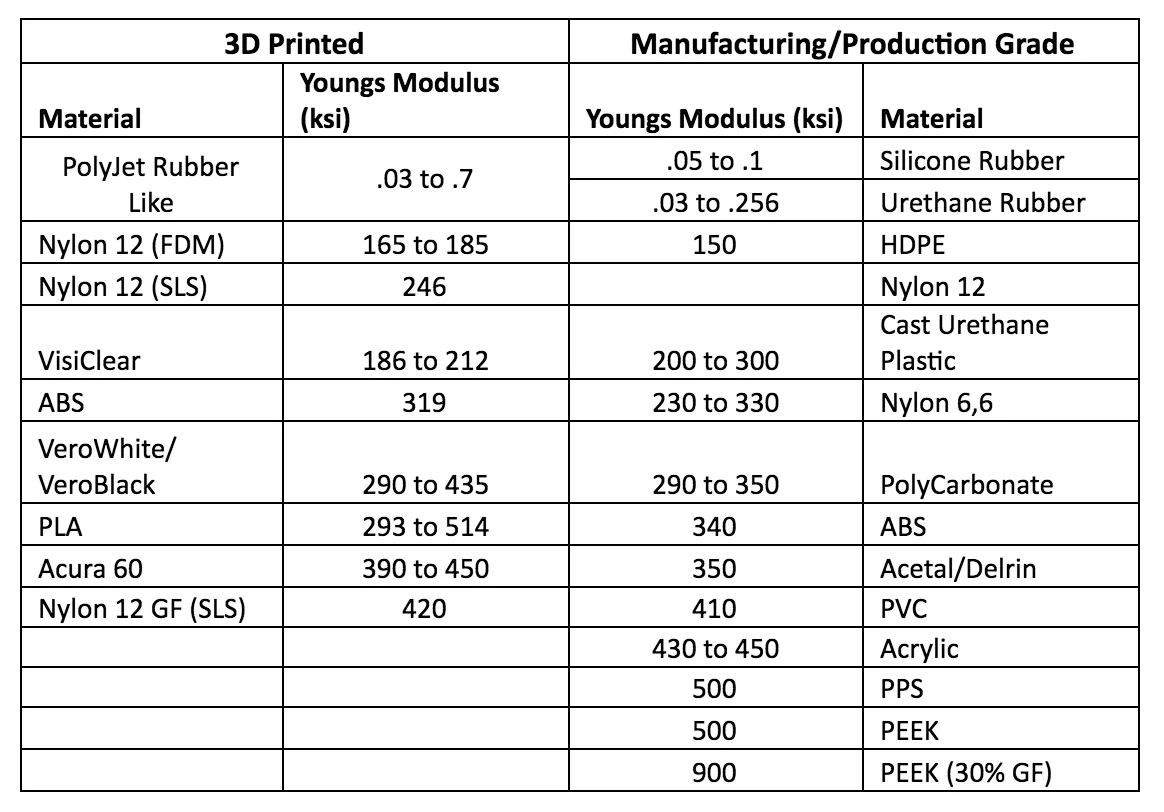

Say you want to design a light pipe, created based on the product need for light transmission. Because you need light transmission, your material choices will be limited to plastics like VeroClear.
If you’re looking at a structural application, the key properties you will be concerned with are young’s modulus and yield strength because you want to replicate both deflection and failure point.
If we return to the light pipe example, let’s assume that you plan to use acrylic for the production parts. In that instance, Acura 60 is a closer match than the VisiClear, as shown in the table below:
This table is not fully comprehensive, but hopefully it gives you a greater indication of how to match the modulus of a 3D printed component with the manufacturing/production grade counterpart. Additionally, note that this table simply orders the materials by increasing modulus and does not place the best matches side by side. That is to say: If we want to simulate production grade ABS, we will most likely use 3D printed ABS and not the PLA that is listed next to it.
Furthermore, this table omits additional mechanical properties such as elongation and yield strength. As an example, VeroWhite has a modulus close to that of PolyCarbonate (PC), but the elongation is much different. The elongation of VeroWhite is between 10-25%, while unfilled PC has an elongation of between 60 and 100%. That means the materials may behave the same up to the yield strength, but VeroWhite will fail much sooner after the yield point because it’s not capable of the same elongation.
