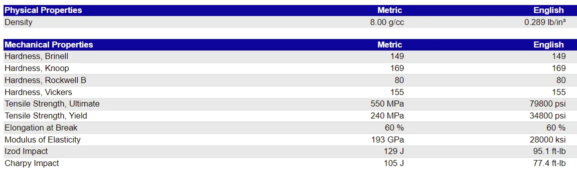

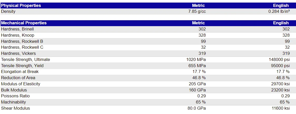

Next, let’s compare the tensile modulus of two commonly utilized stainless steel grades (4140 and 316) materials from MatWeb Material Property Data.
As you can see, 316 Stainless Steel and 4140 Steel are nearly equal in stiffness. And while 316 S.S. has high anti-corrosion properties and excellent stiffness, it may not be the right choice. Depending upon the steel market and location of manufacturing, 316 S.S. is likely to have a higher cost to procure, which drives up project design costs and lead times. Meanwhile, not only does 4140 steel offer superior stiffness, but it’s also more cost effective to heat treat.

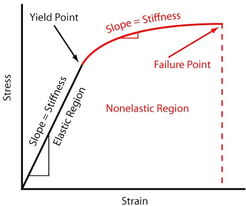

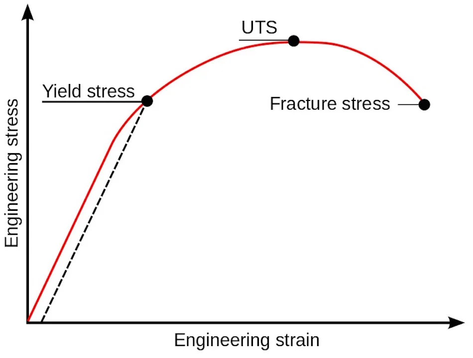

The Stress-Strain Curve
Now that we’ve defined stress and strain, we can talk about the stress-strain curve, which is utilized to determine the elastic modulus. Such a curve is typically developed through testing materials by “stretching” them with specialized machines. The x axis of the curve is the strain value, while the y axis is the stress value. The figure below from the University of Texas at Arlington details the main components of a simple stress-strain curve.
The slope of the elastic region of a stress-strain curve is equal to the stiffness of the material represented by the curve. A material with a steeper slope (concrete) will be stiffer than a material with a shallower slope (brass). This slope of the black line segment is the tensile modulus. Up to the yield point, the material behaves elastically, which means that it will return to its original shape and size after a sustained stress. If we exceed the yield point, the material will be permanently deformed after a sustained stress.
As an example, ABS has a much steeper slope than a rubber band. If we were to examine a stress strain curve for a rubber band the slope would reflect a very small change in incline under a load. Compared to ABS, a rubber band can elongate under a small load without permanent deformation of the material.
Permanent deformation is typically unwanted unless the part is designed to deform such as a rivet or torque value on a fastener. So for the purposes of this article, we’re going to ignor the slope of the non-elastic region of the stress-strain curve because it isn’t used in the formulas or FEA (Finite Element Analysis) studies we’re going to investigate below.
Yield and Ultimate Tensile Strength
Now that we understand the basics of a stress-strain curve, let’s review two of the most important stress values from these curves. The first is the yield strength of a material, which is the highest stress we can place on a material without permanent deformation (indicated by the yield point above). Next is the ultimate tensile strength (UTS) of the material, which is defined as the maximum stress the material can support. The stress-strain curve below has these values labeled. For reference, the failure point is the place where the material physically separates (irrepairably). The proportional limit is the highest stress value for which the stress-strain curve is a straight line; this is the highest stress for elastic deformation. Once the material reaches it’s yield strength (set stress and strain) the material has already started to undergo yielding prior to plastic deformation.

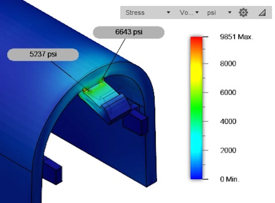

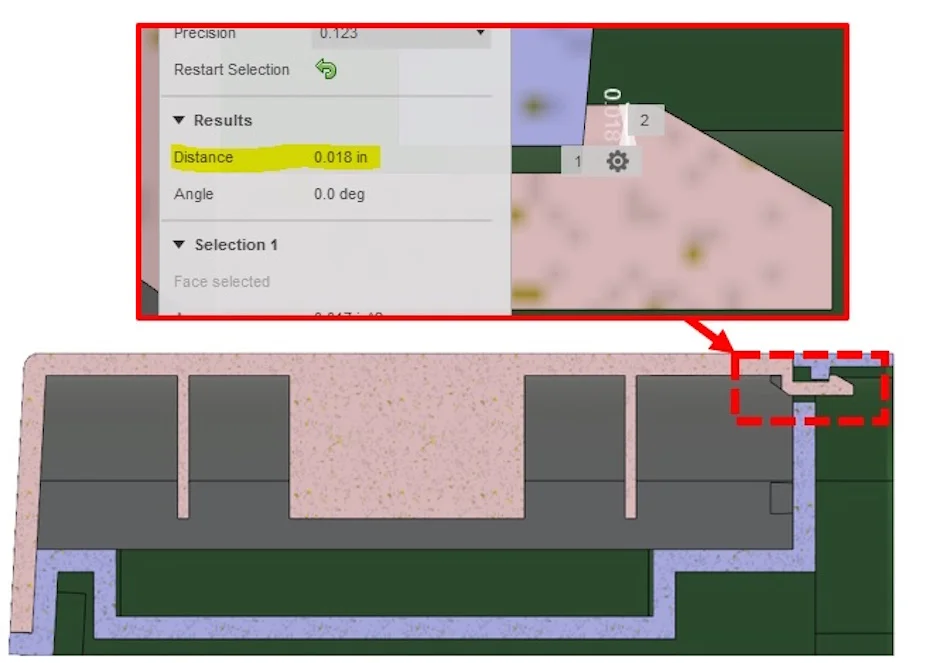

In this next example, we’re going to look at a case in which we may want to reduce a part’s stiffness. Consider the snap-fit example from our article on Mechanical Fasteners, shown below.
In this image, we can see that the snap-fit must deform 0.018 inches to clear the feature that retains it. However, if the material is stiff, the stresses will be too high in this component when it does undergo 0.018 inches of deflection. Let’s see what the stresses are when the snap deforms this much and the part is made of Nylon 12 GF with a 420,000 psi modulus. The first FEA depiction below demonstrates a 4.136 lbf load generating the 0.018” of deformation.
Once we have achieved the deflection we need, we can look at the stresses that will be present when the part deflects this much. The image below is of the same simulation, but looks at the stresses in the part.
This analysis indicates that we are seeing stresses well more than our 5,250-yield strength, so we will likely damage the part by simply installing and removing this cover. We would almost certainly see stress cracks forming in the corners after a few uses.

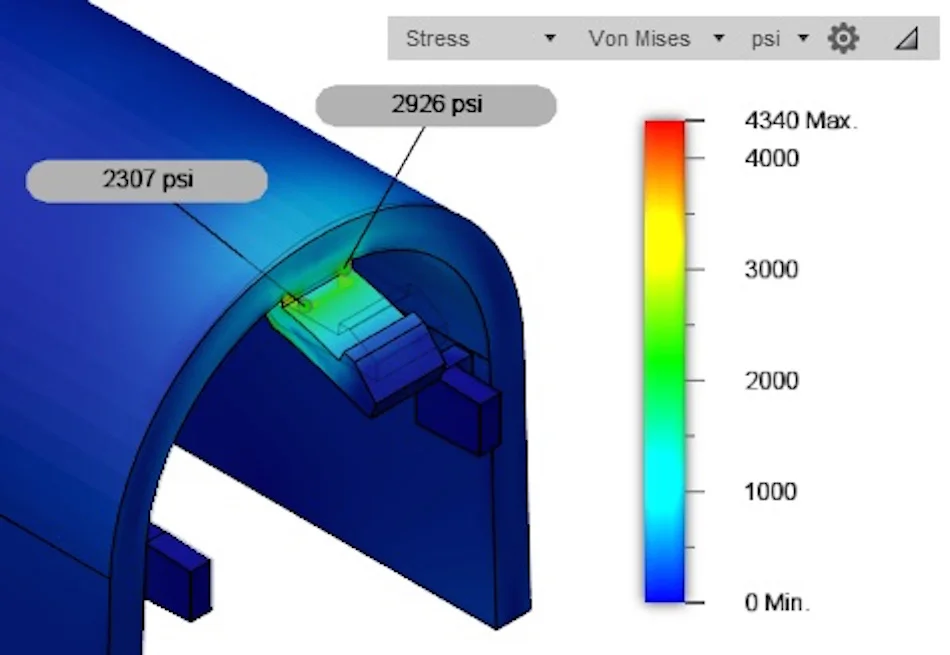

But what if we used a material that had a lower elastic modulus, like our original Nylon 12 (185,000 psi)? If you recall from the stress-strain curve, a material with a lower elastic modulus will undergo more strain for a given stress value. In simple terms, that means we can expect the snap to move the same 0.018” with much lower stresses.
When we run the same FEA study with our lower elastic modulus Nylon 12, the load on the snap has been reduced to 1.822 lbf because the lower modulus material requires less force to deflect the same amount.
We have achieved the 0.018” of deflection we need, so let’s look at the stresses with which we’re concerned in the image below.
The area that was stressed to 6,643 psi before is now only at 2,926 psi. (And yes, if you do the math, you’ll discover that the stress in the Nylon 12 GF remains exactly 2.27 times as much as the standard Nylon 12.)
This concept can be further expanded to allow for different insertion and removal forces for snap-fit parts, so I encourage you to play around with materials with varying elastic modulus values to get a feel for how they behave.
