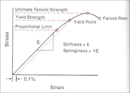

Young’s Modulus
Young’s Modulus stress-strain curve is a great reference tool for understanding the relationship between stiffness and strength. Young’s Modulus (aka elastic modulus, shear modulus, or bulk modulus) defines a material’s ability to resist elastic deformation while under loading conditions and is the ratio of normal stress to normal strain. In basic terms, this tells us how easily a material can stretch and deform.
Stress vs Strain Curve
Stiffness
Stiffness is a material’s ability to return to its original form after being subjected to a force. Strength is how much stress can be applied to a material before it goes into plastic deformation or fractures. Stiffness and elastic modulus are related: as the elastic modulus goes up, the stiffness of a material also goes up. Since stiffness and strength are related to the elastic modulus of a material, you can look up the elastic modulus in a material properties reference handbook to determine the strength and/or stiffness of a given material.
The stiffness of a material can be quantified by the slope of the stress-strain curve, as illustrated in the graph below. There are many types of stiffness to consider, depending upon your application, including tension/compression stiffness, axial force ratio, axial linear strain (EA), torsional stiffness, bending stiffness, beam stiffness, spring stiffness, and shear stiffness. In general terms, the stiffness of a material is calculated by using the following equation:

The Young’s modulus stress-strain curve shown above is a good way of graphically demonstrating stiffness. The ratio of stress to strain is the elastic modulus (stiffness), but the way a material responds to stress, and only the stress, defines the strength of the material.

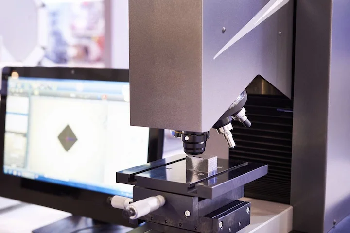

Hardness
Hardness Tester
Hardness is a measure of a material’s ability to withstand plastic deformation or a material’s resistance to penetration by a pointed tool. This is a critical characteristic to consider in applications with two materials impacting each other — the harder one will scratch or cause plastic deformation on the other material. Hardness is dependent upon ductility, plasticity, strain, strength, toughness, viscosity, and viscoelasticity. It’s an important measure when considering the wear resistance (abrasion or erosion resistance of a part) since harder materials typically have higher wear resistance.
Hardness testing is accomplished by lowering a probe with a hard (typically diamond) tip onto a material at a set force and measuring the amount of indentation that the probe (the indentor) produces (depth of plastic deformation). Hardness testers also operate by measuring the size of the impression left by the indentor.

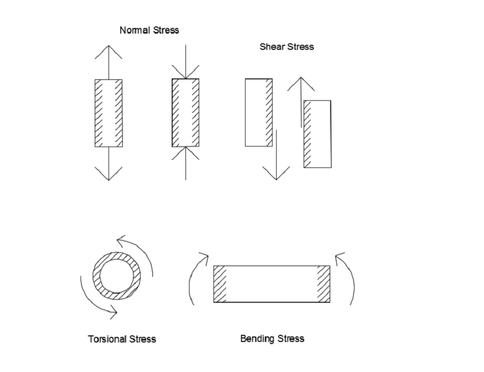

Understanding Stress and Strain
Stress is an internal force resulting from an applied load; it acts on the cross-section of a mechanical or structural component. Strain is the change in shape or size of a body (deformation) that occurs whenever a force is applied. There are two types of strain that correspond with the two types of stress:
  • Normal Strain: deformations that occur perpendicular to the cross-section; normal strain is caused by normal stress
  • Shear Strain: deformations that occur parallel to the cross-section; shear strain is caused by shear stress
axial load, shear stresses, torsional stress, and bending stress
Top left: axial load causing tension or compression. Top right: shear stresses within a member. Bottom left: torsional stress about a circular cross-section. Bottom right: Bending stress caused by a moment.

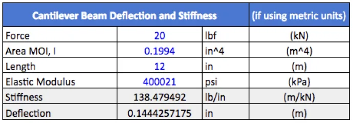

Area Moment of Inertia Calculator
If you’re looking for a simple way to calculate the Area Moment of Inertia for a round tube, solid tube, or rectangular beam — or to calculate deflection and stiffness for a cantilever beam — you can use our Area Moment of Inertia Calculator. This tool also allows you to play around with geometry to understand how the cross-sectional shape of a part impacts stiffness and deflection.
Download Free Calculator

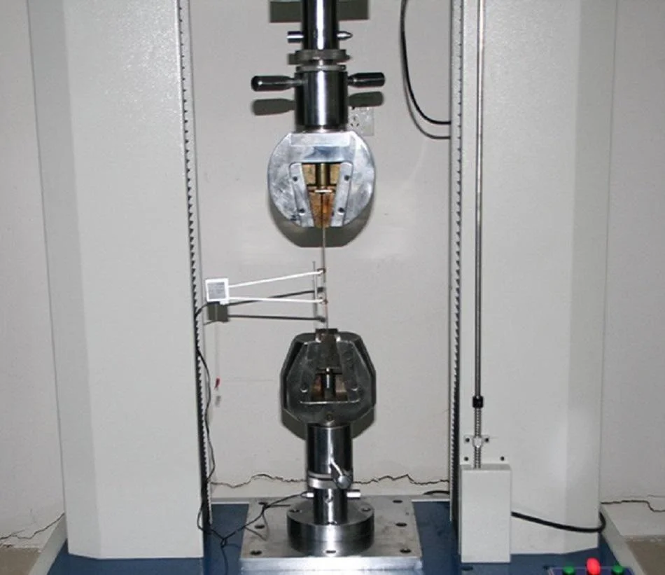

Axial Loading on a Straight Member – Stiffness
To further understand stiffness, let’s consider a metal bar in tension, subjected to an axial load (bending moment). The internal stresses cause a deformation of 1% of the metal’s original length when it breaks at 100 lbf.
Next, consider a rubber-like rod-shaped polymer that’s subjected to the same force but deforms 5% of its original length and breaks at 100 lbf. Both materials are equally strong, but the metal is stiffer than the polymer, which means that it deflects less for the same given loading condition. This thought exercise is a great way to show that as stiffness increases, the amount of deformation for a given load decreases.
tensile strength test
Tensile strength test.

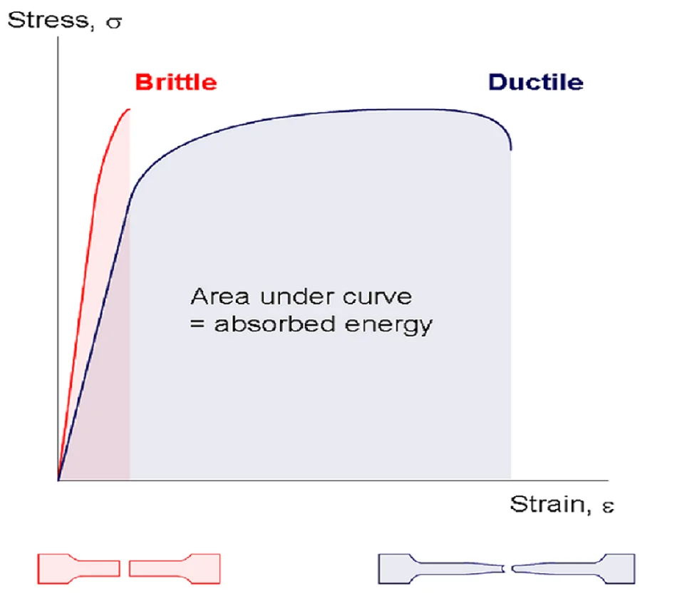

Ductile vs. Brittle
Figure 7. Ductile vs. Brittle
The fracture process for ductile metals normally occurs in several stages (ductility and brittleness in polymers depend on temperature). For raw materials, determine which manufacturing processes will provide you with the desired material properties. Testing of materials should conform to ASTM standards, so consult engineering handbooks to obtain reliable material data.
