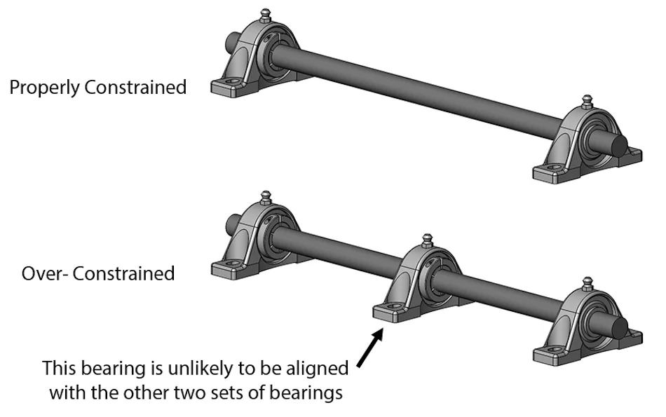

The most common example of this situation is a drive shaft that is held by three sets of bearings. There is a set of bearings on each end of the drive shaft and another set of bearings somewhere near the middle of the shaft. The intent of the third set of bearings is to help reduce flexure near the center of the drive shaft, in order to reduce vibration in the system.
In reality, the third set of bearings is the most likely source of vibration in the system. After all, we just learned that the center of each set of bearings is almost certainly not in perfect alignment. So, while the intent of the center set of bearings is to constrain the drive shaft so that it is always in perfect alignment, it is actually the reason the drive shaft is in a constant state of misalignment, which will cause excessive and unnecessary vibration. This is a clear example of over-constraint.
Pro Tip:
If you would like to design a drive shaft that operates with minimal vibration and minimal driveshaft flexure, do not try to use a third set of bearings in the center of the drive shaft. Instead, shorten the drive shaft, and/or increase the diameter of the drive shaft, and/or use a stiffer material for the drive shaft.

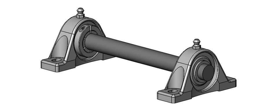

The image above shows the same drive shaft, but shortened to increase stiffness.

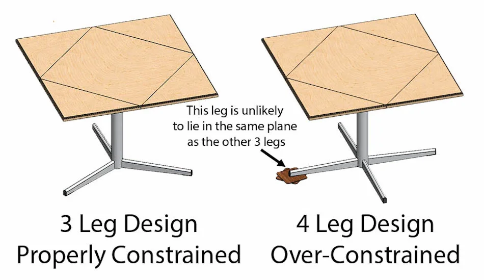

The most common example of this situation is a restaurant table with four legs. Ever wonder why the restaurant table ALWAYS wobbles? Well, over-constraint is the culprit.
The contact point of any three of the four legs already makes a plane. The fourth leg’s contact point almost certainly doesn’t fall on the same plane that the first three legs have already created. That misalignment results in the wobble and the resulting need to place one to three coasters underneath. This is yet another clear example of over-constraint.
Side Note:
If engineering principles dictate that a table should really only have three legs, then why do most tables have four legs? Well, a table with three legs might not wobble, but it sure isn’t very stable.
Most tables are either circular, square or rectangular. They are rarely triangular. That means that there is likely a surface of the table itself that rests outside of the triangle that the three legs make with one another. Result: unless those three legs are spread far out from the center of the table, it can fall over easier than you would like.
