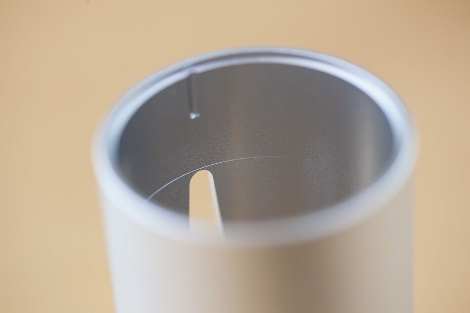

The cnc machining aluminum shell slides off the internal subassembly easily. It’s is essentially the same as that found on the Outdoor Module, just stretched axially. We even find the same post-machined alignment notches.
