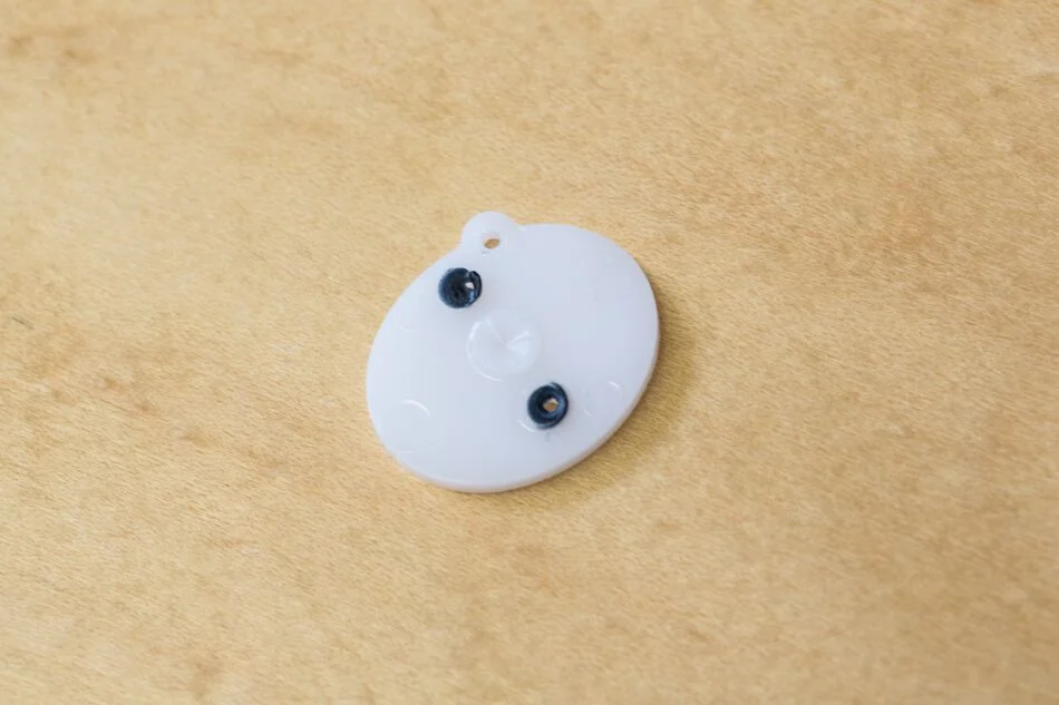

Example 1: Illuminated Logo of Under Armour Heart Rate Monitor
The UA heart rate monitor’s front cover features a sizeable logo. The engineers behind this product managed to light up this logo evenly, with just one tiny top-firing LED at the center of the main PCBA. This LED doesn’t have much reach by itself.
Enter the light pipe: It’s made of a milky plastic that could be polycarbonate resin (normally transparent) with added titanium dioxide. The more titanium dioxide that’s added, the more milky the plastic, which improves diffusion.
The cone-shaped cavity feature at the center of the light pipe is designed to match the LED; the angular wall of the cone helps to direct the emitted light into the light pipe.
The cone is the entry point of the light pipe, and the entry point should always be placed as close to the light source as possible, to minimize loss.
Let’s see the actual effect of the light pipe:
- Without the light pipe, there is a strong hot spot in the center of the logo and not much light elsewhere.
- With the light pipe, the light emitted by the LED is spread out more evenly and the extreme hot spot is gone.
