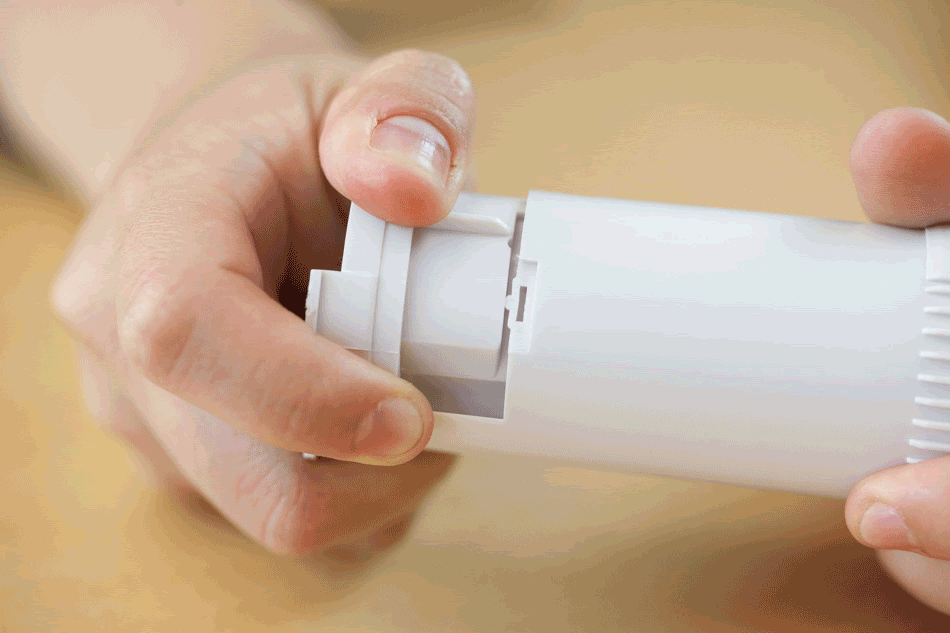

Netatmo advertises that the modules have “one-piece aluminum body”…that’s only partly true. What I’d call the “body” has both cnc machining aluminum and plastic components. A ten-degree twist separates the inner sensor module from the aluminum tubular housing and upper plastic cap. The upper plastic cap pops out, too.
The upper cap and sensor module do all the hard work work of keeping this thing together. The aluminum housing is simply encapsulated between these plastic pieces. The twist & lock mechanism has great tactile feedback when it clicks into place. You can see the plastic “leaf spring” on the upper cap deflect as you rotate it.
