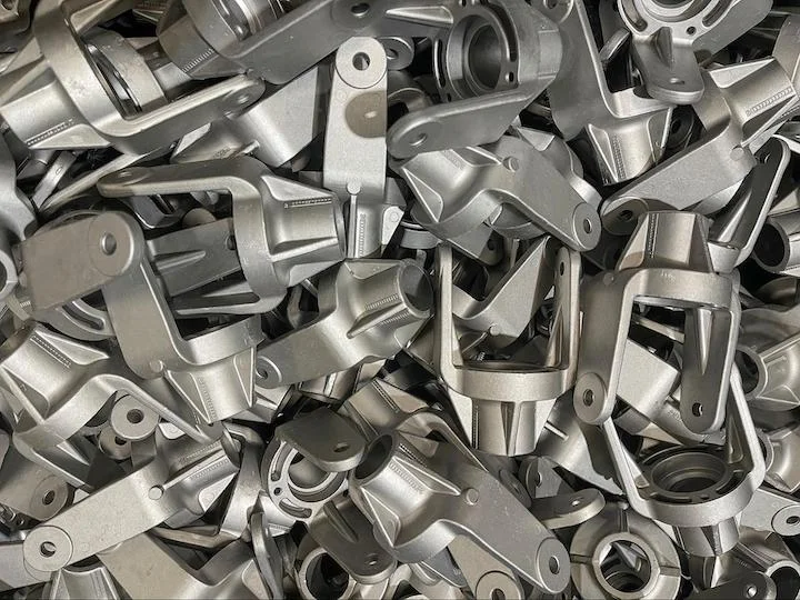

High-Pressure Die Casting (HPDC)
The process starts with heating the meticulously crafted steel mold (or die), followed by the swift injection of molten metal. The molten metal injection happens at an impressive speed and high pressure, usually between 1,000 to 20,000 psi. It’s safe to say the pressure’s on, but this high pressure is precisely what is needed to form complex parts. After the mold is filled, the pressure is maintained until the metal solidifies, making it perfect for ‘smooth’ operations! Parts are often cleaned up, with excess material removed, machined (typically CNC machined), and finished after the die casting process.

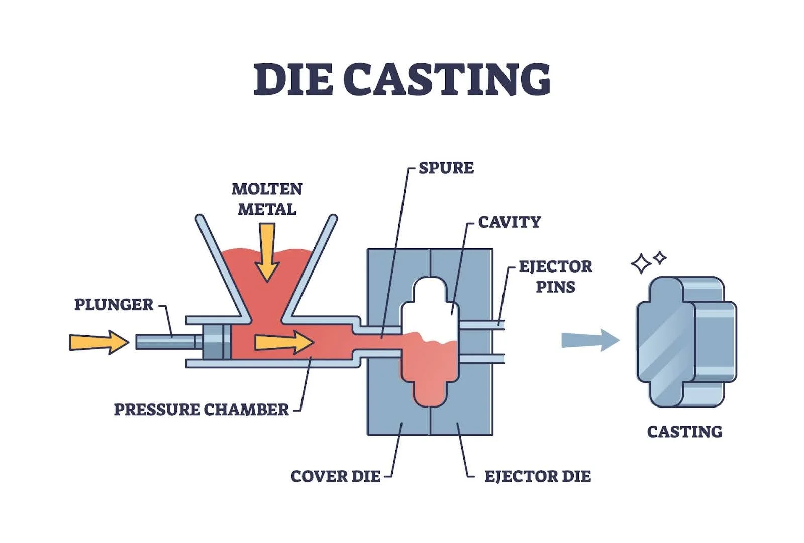

Cold-Chamber Die Casting
Cold-chamber die casting involves introducing molten metal at room temperature into a separate shot chamber using a ladle or pouring method. The shot chamber contains a ram that vertically forces the molten metal into a steel mold (die) with movable and fixed sections. The ram applies pressure ranging from 2,000 to 20,000 PSI to propel the molten metal into the die. The pressure is maintained until the metal cools and solidifies, after which the finished product is ejected from the die. This method is suitable for high-melting-temperature alloys like aluminum.
Hot-Chamber Die Casting
Hot-chamber die casting is a metal casting process specifically designed for low-melting-point alloys like zinc, tin, lead, and magnesium. This process is the most common and faster method than cold-chamber die casting. In this method, the metal is melted in a furnace within the casting machine. A hydraulic system injects molten metal into the die under high pressure. This process is efficient for producing intricate shapes. It is not suitable for alloys with higher melting points due to the risk of damaging the pump that injects the molten metal.

Die casting involves the following steps:
- Preparing the Die: The first step is to create the die. Dies are typically made from steel and are designed to endure high temperatures and pressures. The mold design starts with a CAD (computer-aided design) drawing of the mold. This file is used to make the mold using CNC (computer numerical control) machining. After the die is made, it is prepared with a releasing agent or lubricant. This helps release the cast part. The die is then clamped and closed with high pressure.
- Metal Preparation: In the next step, the metal is prepared for the injection process. The metal, typically an aluminum, zinc, or magnesium alloy, is melted using a furnace and poured in a ladle.
- Metal Injection: The molten metal is poured into the shot chamber. This chamber is hot for hot-chamber die casting and cold for cold-chamber die casting. After that, the molten metal is injected into the die using high pressure.
- Cooling: The mold is allowed to cool and solidify into the shape of the mold.
- Ejection: After cooling, the part will be completely solid and can be removed from the die.
- Trimming: The final step of die casting is the trimming step. This involves removing any excess metal found on the product. This is done by using a saw or trim die.

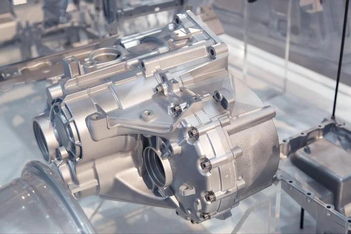

Aluminum Die Casting
Aluminum alloys are widely employed in die casting due to their unique properties. Notable alloys such as 380, 360, 390, and 413 exhibit high operating temperatures, outstanding corrosion resistance, low density, excellent strength, and good thermal conductivity. Additionally, aluminum alloys offer good stiffness, a favorable strength-to-weight ratio, EMI and RFI shielding properties, and recyclability. They can also withstand high temperatures and retain dimensional stability with thin walls.

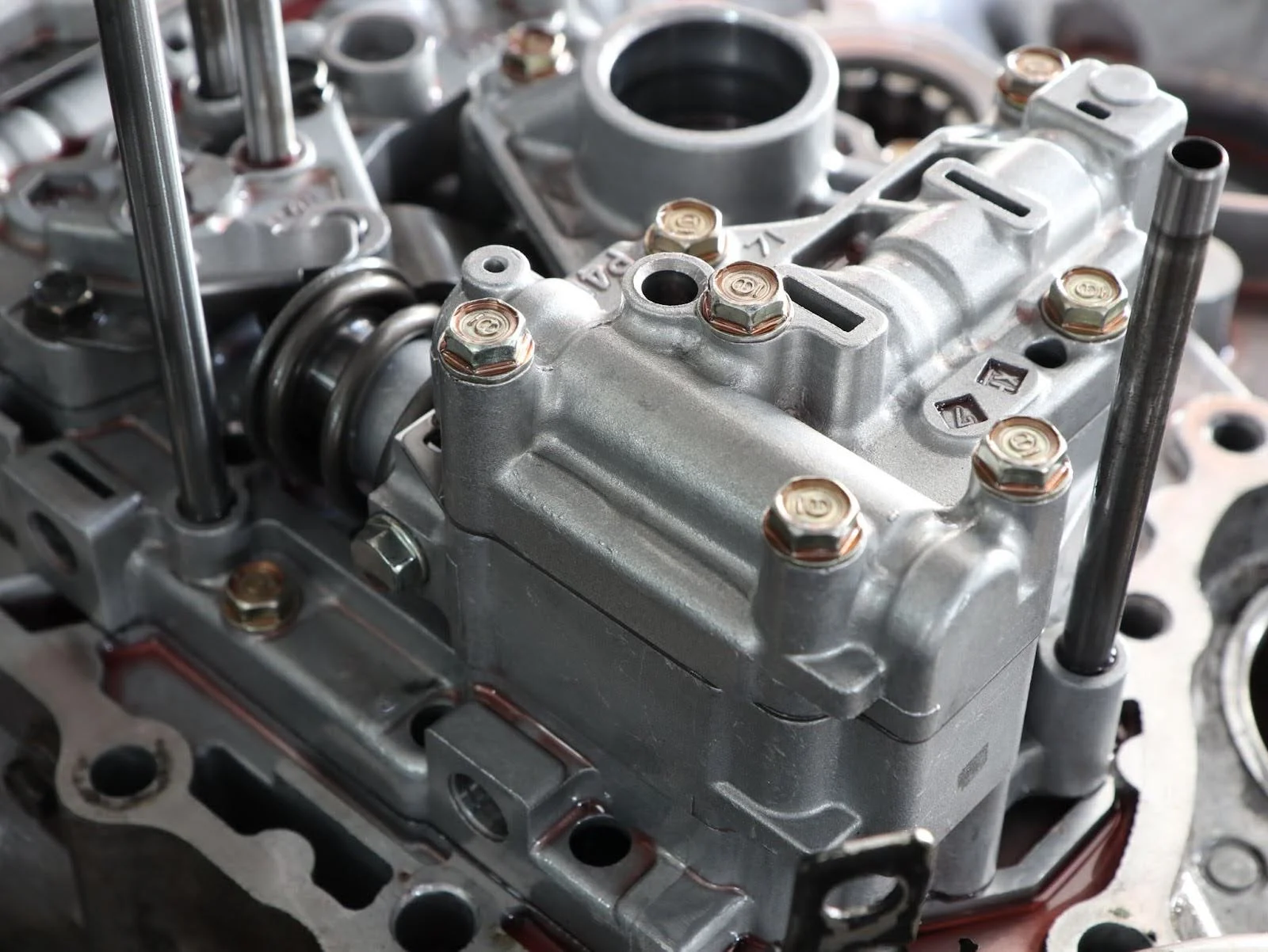

- Automotive: Many automotive parts, such as gears, pistons, and housings, are made using die-cast parts.
