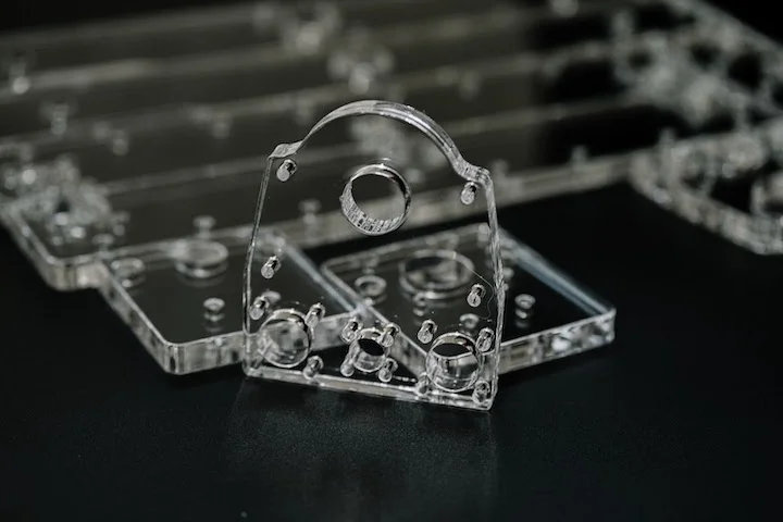

Acrylic (PMMA)
Acrylic is a strong, clear thermoplastic that provides a lightweight, shatter-resistant alternative to glass. This injection-molded material also offers excellent optical clarity so that a high percentage of light passes through. Acrylic resists ultraviolet (UV) light and weather, and is also known as PMMA, or by its full chemical name: poly(methyl methacrylate).
Properties
Unlike some plastics, acrylic can withstand exposure to water and hold tight tolerances. PMMA won’t absorb odors, but it cannot resist solvents and is easily stained by greases and oils. Although injection-molded acrylic has high tensile strength, it’s prone to stress cracking under heavy loads.
Applications
Applications for acrylic injection molding include windows, greenhouses, solar panels, bathroom enclosures, and other transparent components for architectural, lighting, and outdoor applications.

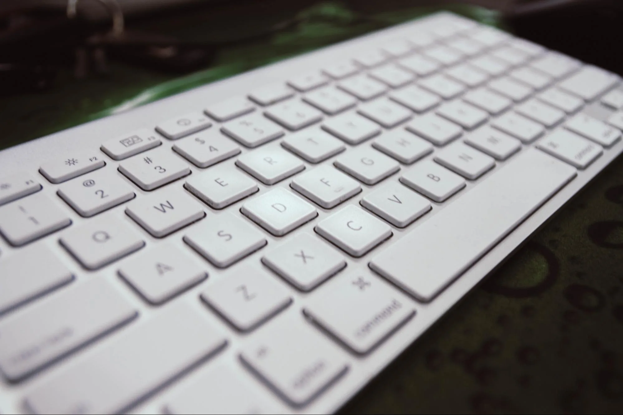

ABS injection molding is used to produce many types of plastic parts, including:
- keyboard keys
- protective headgear
- electrical outlet wall plates
- automotive parts like wheel covers
- consumer goods
- sports equipment

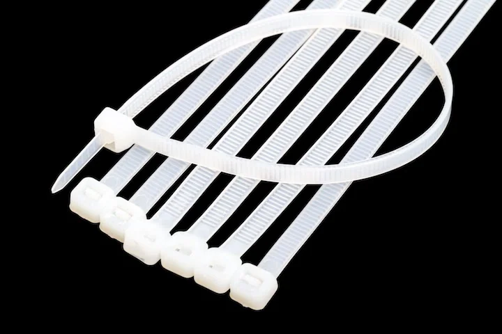

Nylon Polyamide (PA)
Nylon is a synthetic polyamide (PA) that combines toughness and high heat resistance with high abrasion resistance, good fatigue resistance, and noise-dampening properties. Nylon isn’t inherently flame-resistant, but flame-retardant versions are available. Similarly, although nylon can be degraded by sunlight, a UV stabilizer can be added to improve outdoor performance.
Properties
Compared to other plastics, nylon provides poor resistance to strong acids and bases. Nylon is not as strong as polypropylene and can’t match polycarbonate for impact resistance. Injection molding nylon is challenging because it’s prone to shrinkage and is subject to inadequate mold filling.
Applications
Applications for nylon injection molding include:
- strong mechanical parts such as bearings, bushings, gears, and slides
- casings and snap-fit closures
- threaded inserts and kinetic parts
- jigs and fixtures
With its low coefficient of friction, nylon is also well-suited for applications with high-friction and wear.

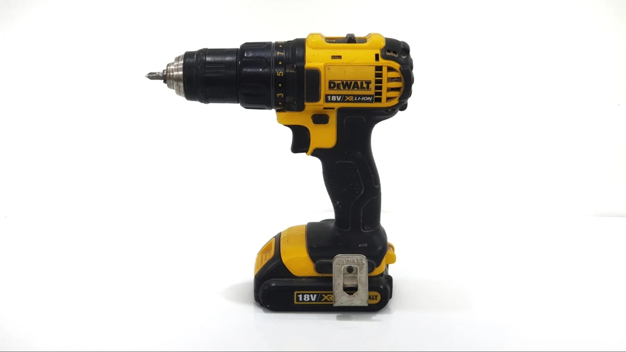

- power tool bodies
