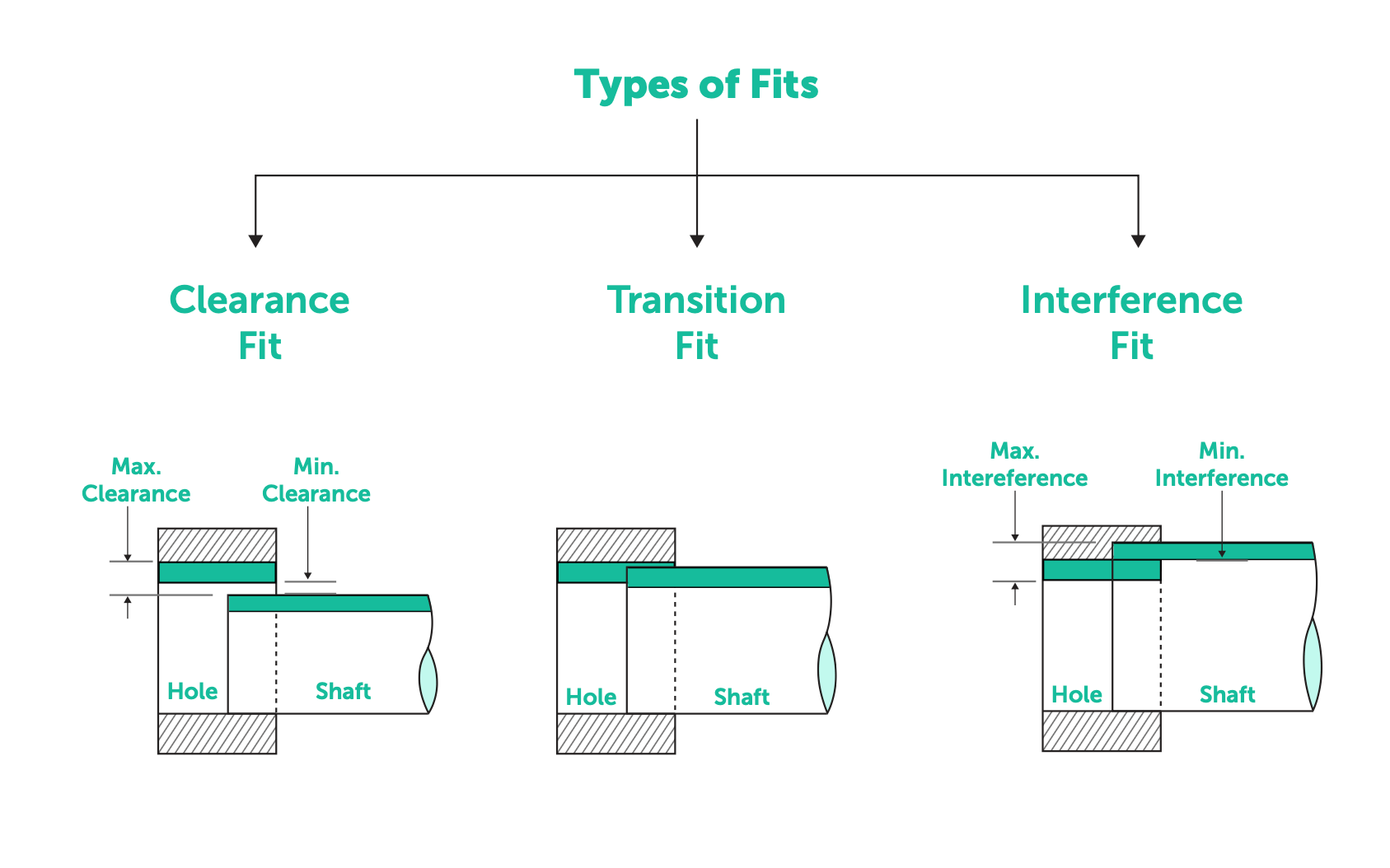

The Three Primary Fit Types
Types of engineering fits for assembly.
Clearance Fits
Clearance fits are designed so that the hole is always larger than the mating shaft, ensuring that parts assemble easily with minimal force. This type of fit allows relative motion between components and is the most forgiving option when it comes to manufacturing variation. Because clearance fits tolerate dimensional variation well, they are often preferred for high-volume production and manual assembly operations.
Common applications include rotating shafts, sliding mechanisms, removable covers, and non-critical alignment features. When ease of assembly, serviceability, or movement is required, clearance fits are typically the safest and most economical choice.
Clearance:
  • Hole is always larger than the shaft
  • Allows easy assembly and relative motion
  • Most forgiving for variation
Common uses include rotating shafts, sliding components, and non‑critical alignment features.
Transition Fits
Transition fits fall between clearance and interference fits and may result in either a small clearance or a slight interference, depending on actual part dimensions. They are used when controlled alignment is required, but permanent retention is not. For example, transition fits can help align mating components during assembly while still allowing disassembly if needed.
Because transition fits sit on the edge of interference, they are more sensitive to tolerance variation than clearance fits. Small shifts in process capability can change how the parts assemble, so these fits should be used intentionally and validated with real manufacturing data rather than nominal dimensions alone.
Transition:
  • Can result in either slight clearance or slight interference
  • Used when controlled alignment is needed without permanent retention
Transition fits are sensitive to tolerance variation and should be used intentionally.
Interference (Press) Fits
Interference fits are designed so that the shaft is intentionally larger than the hole, creating retention through friction once the parts are assembled. These fits require force, thermal assistance, or both to assemble and produce joints that resist movement, vibration, and shear loads.
While interference fits can be highly effective, they are also unforgiving. Excessive interference can crack brittle materials or distort thin-walled components, while insufficient interference can eliminate retention entirely. Successful interference-fit design requires careful control of tolerances, material properties, and assembly methods.
Interference:
  • Shaft is intentionally larger than the hole
  • Requires force or thermal assistance
  • Produces high friction and retention
Interference fits are powerful but unforgiving if not designed correctly.

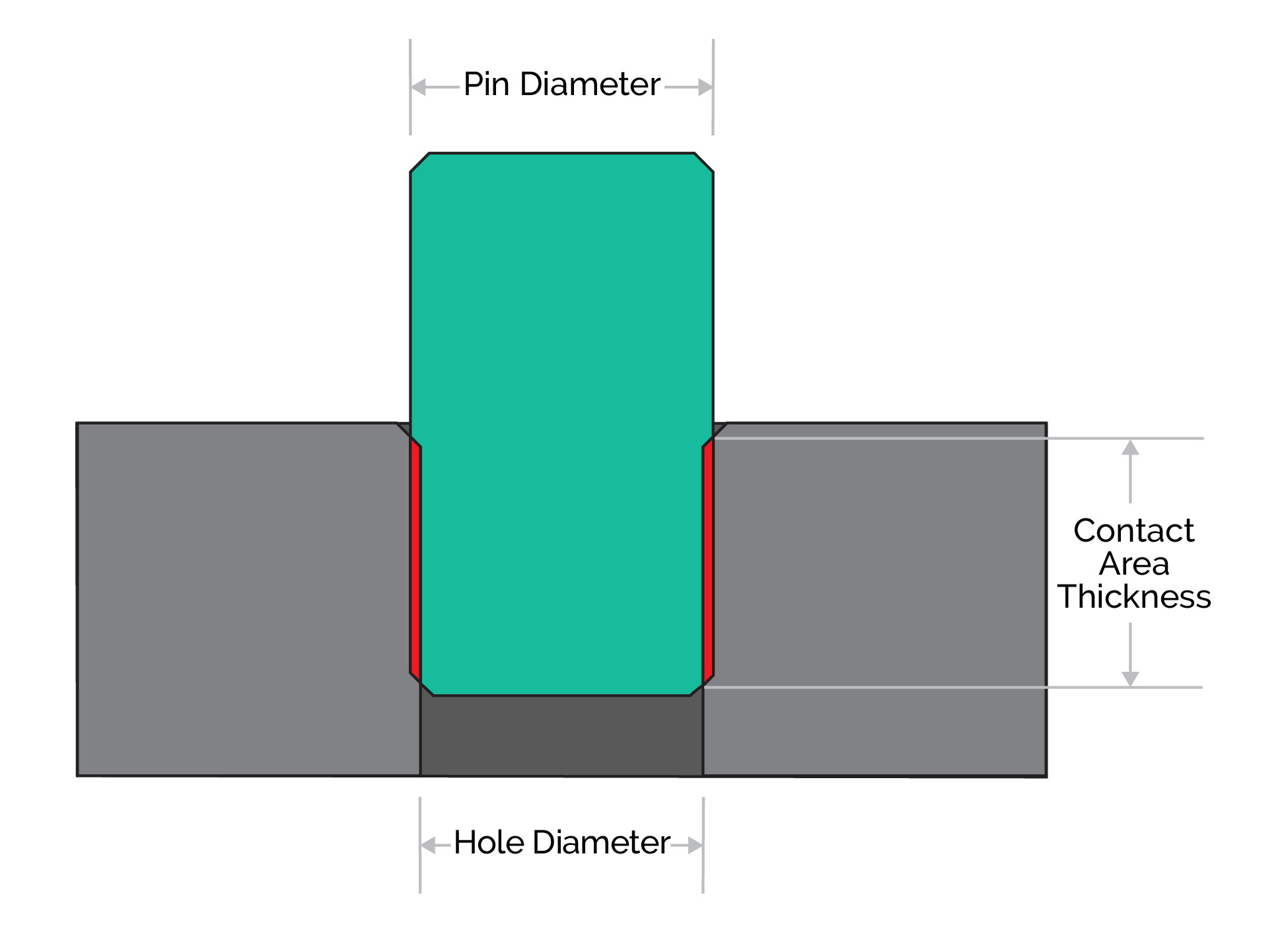

Press (Interference) Fits
When to Use Press Fits
Press fits are well-suited for applications requiring high positional accuracy, compact joints, and resistance to shear and vibration without additional hardware. Because they rely on friction rather than fasteners, press fits can reduce part count and enable clean, space-efficient designs.
Typical applications include dowel pins for alignment, bearing installation, and shaft-to-hub connections. In these cases, the press fit provides both location and retention in a single operation.
Design Risks
Press fits introduce several risks:
  • Small tolerance changes can eliminate interference
  • Excessive interference can crack materials
  • Thermal expansion mismatch can loosen or overstress joints
Best Practices for Press Fits:
  • Avoid more than two press‑fit features per assembly operation
  • Combine one press fit with one slip‑fit locator when alignment is required
  • Validate with real manufacturing process capability
  • Consider service temperature range and effects carefully
Cross-section of a press-fit assembly.

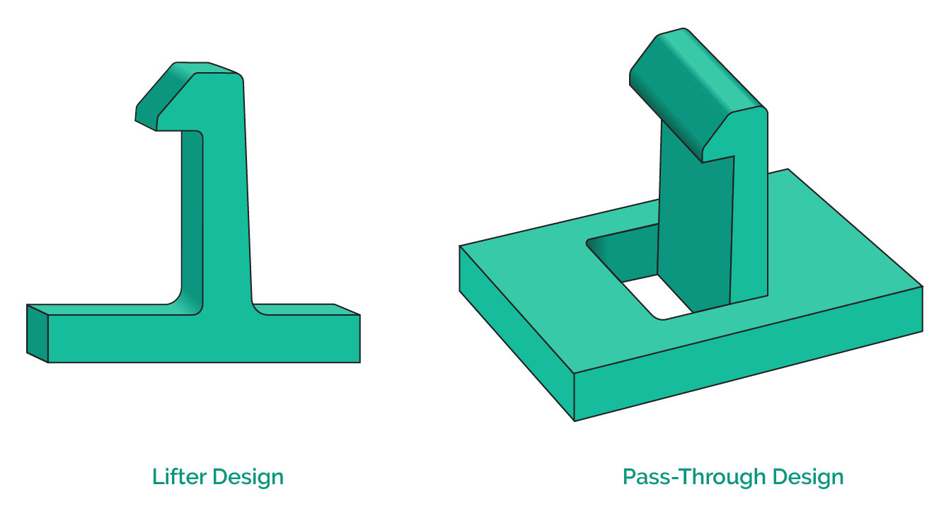

Snap‑Fit Design for Fast Assembly
Why Snap‑Fits Can Be a Great Option
Snap-fits replace traditional fasteners with integrated part geometry, allowing components to lock together during assembly without tools or additional hardware. This enables rapid assembly, reduces part count, and lowers overall bill-of-materials cost. Snap-fit assemblies also support clean external aesthetics, which is why they are widely used in consumer products, enclosures, and internal subassemblies.
When designed correctly, snap-fits can dramatically reduce assembly time and simplify logistics, making them especially attractive for high-volume production.
Snap‑fits replace fasteners with part geometry, enabling:
  • Rapid, tool‑less assembly
  • Lower part count
  • Reduced BOM cost
  • Clean aesthetics
Snap‑Fit Types
  • Cantilever snap‑fits
  • Annular snap‑fits
  • Torsional snap‑fits
Each type has different stress behavior and retention characteristics.
Material Considerations
Snap‑fits rely on elastic deformation. Key considerations:
  • Allowable strain of the material
  • Long‑term creep behavior
  • Manufacturing process (injection molding vs. 3D printing)
Tough, ductile thermoplastics generally perform best.
Design Tips:
  • Add generous radii at the snap root
  • Control deflection length to reduce strain
  • Provide lead‑in chamfers for assembly
  • Design for disassembly if required
  • Plan for fixtures to help guide assembly
Cantilever snap fit designs.

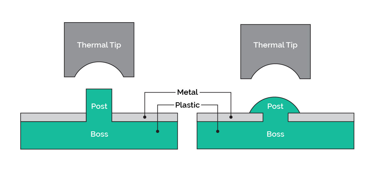

Heat Staking
What Is Heat Staking?
Heat staking reshapes thermoplastic bosses using controlled heat and pressure to mechanically lock another component in place. Rather than melting an interface, the plastic deforms to create a retaining head.
Common Applications
  • Capturing PCBs
  • Plastic‑to‑metal joints
  • Installing threaded inserts
Pros and Cons
Pros:
  • No added hardware
  • Reliable retention
Cons:
  • Slower cycle time than ultrasonic welding
  • Permanent joints
  • Visible stake heads
Thermal heat staking assembly of a plastic post to sheet metal.

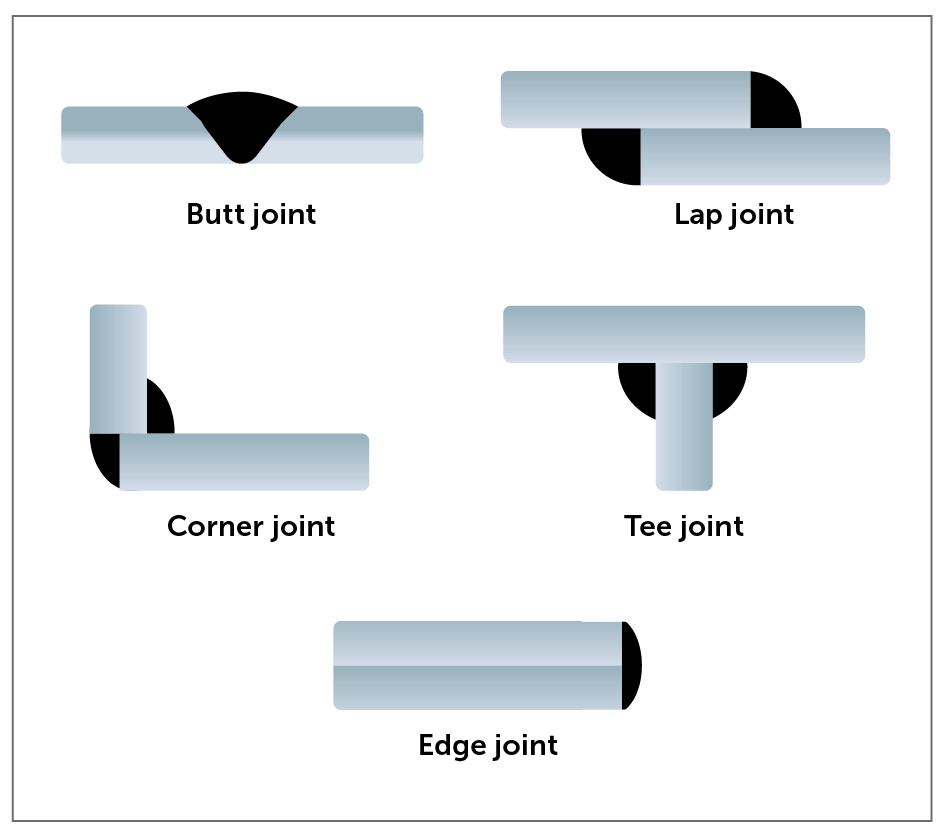

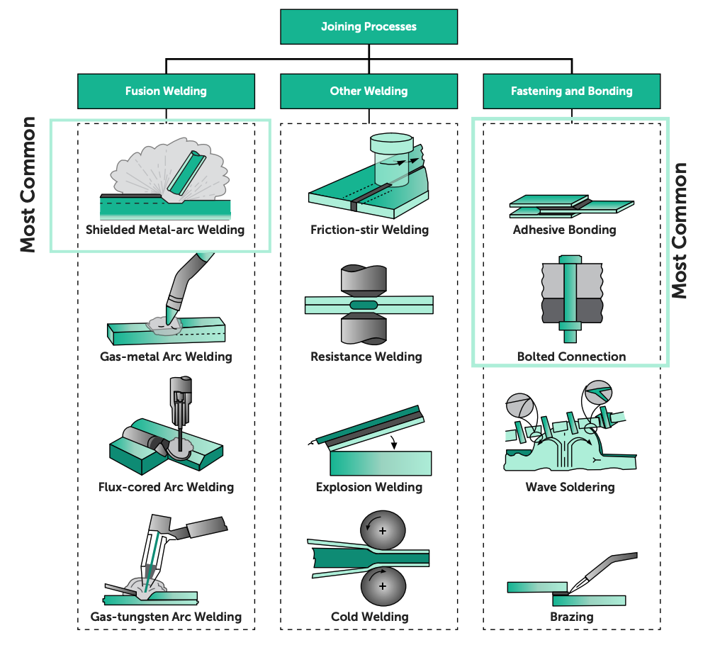

Sheet Metal Welding and Weldment Design
Welding in Assembly
Sheet metal welding is used when high structural integrity and permanent joints are required. Because welding introduces heat and distortion, assembly-friendly weldment design is critical.
There are many ways to assemble metals, as pictured below, but common welding types include:
  • MIG welding
  • TIG welding
  • Spot welding
  • Laser welding
Various metal assembly techniques.
Design for Weldability
  • Match welding process to material thickness
  • Avoid excessive heat input
  • Design joints that minimize distortion
Joint types for sheet metal welding.

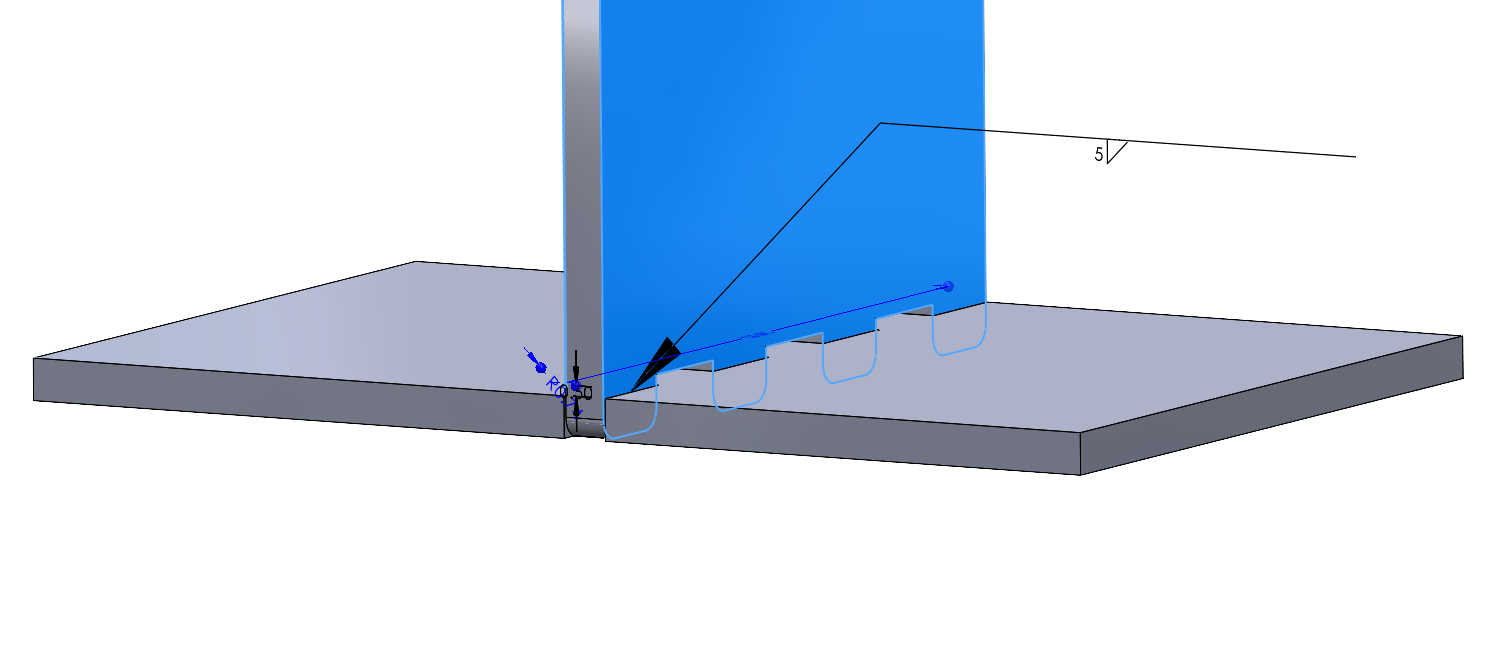

Tabs and Slots
Laser‑cut tabs and slots can:
  • Improve alignment
  • Reduce fixturing
  • Speed assembly
They must be designed to avoid stress concentrations.
Tab and slot design for a sheet metal weld joint.

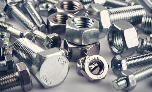

Mechanical Fasteners
Why Fasteners Persist
Mechanical fasteners remain common in product design because they offer predictable strength, broad availability, and straightforward serviceability. They are often the safest option when loads are high, regulatory requirements apply, or disassembly is expected over the product’s life.
That said, fasteners add bill-of-materials cost, assembly time, and access constraints, making them a frequent target for DFMA optimization.
Mechanical fasteners remain common because they offer:
  • Predictable strength
  • Easy sourcing
  • Serviceability
  • Design flexibility
However, they add BOM cost and assembly time.
Common Fastener Types
  • Screws and bolts
  • Nuts and washers
  • Rivets
  • Dowel pins
  • Threaded inserts
  • Clips and retainers
Assembly‑Focused Fastener Design
  • Design joints so fasteners provide clamping, not alignment
  • Ensure tool access in the assembled state
  • Avoid over‑specifying fastener grades
  • Consider galvanic corrosion between materials
Fasteners in Plastics
  • Use inserts for repeated assembly and reliable pull-out strength
  • Use self‑tapping screws to reduce cost, but avoid them for long‑life joints
  • Design adequate boss wall thickness
Types of mechanical fasteners.
