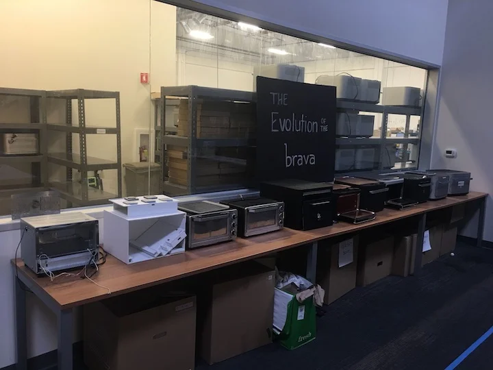

The P# milestones reflect significant prototype builds of increasing integration and resolution, each with its own nested threads of supporting prototypes converging on the major P# build. Those nested threads comprise independent, singular resolutions of the subcomponents in the larger P# assembly or system.
Each domain – like electrical, mechanical and industrial design – is responsible for contributing validated solutions to the integrated whole for each major build. And those domains perform their own series of rapid prototypes, so there are iterations inside iterations. The key for every domain is to advance through rapid iterations using materials and fabrication techniques in line with the level of resolution appropriate for the objective of that particular prototype.

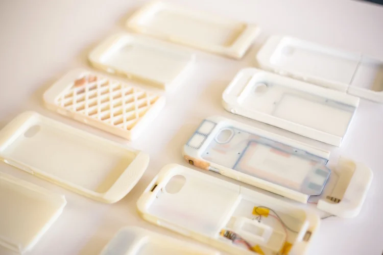

For example, a first order prototype is fast, gestural, and only one step removed from sketches on a whiteboard. Such prototypes are crafted from materials like foam-core, popsicle sticks, hot-melt glue, Lego®, and modeling clay, and are essentially 3D sketches for ideation, used to help visualize a concept quickly enough to keep up with a train of thought.
Second order prototypes are used to refine, test and validate specific features of a product, and so require more intent and design effort. They’re typically used for buttons, latches, snaps and other simple mechanisms on the mechanical side, or an assemblage of dev kits and off-the-shelf components on the electrical side. For industrial designers, these prototypes are volume studies and interaction mock-ups. The point of a second order prototype is to independently validate each element before introducing them to one another.
Third order prototypes bring together multiple elements from different disciplines that have been refined to a high degree of resolution. Each of the P# milestone prototype builds, including the “final” prototype prior to production, is a third order variety. P0 validates that solid foundation built in the initial drawing, with subsequent P# builds adding increasing levels of integration and resolution.
