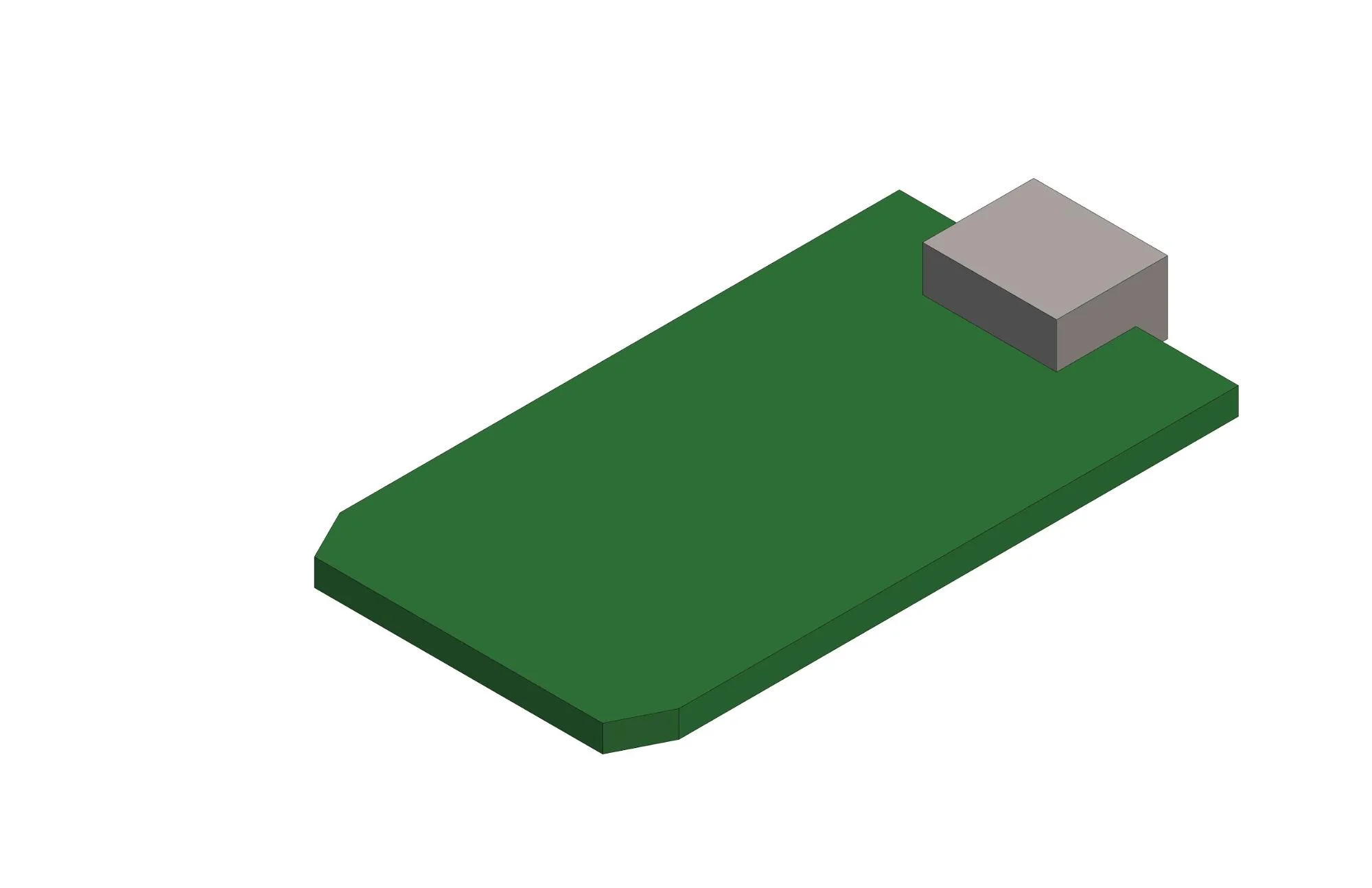

Step 2: Model the Internal Components
Now on to the enclosure. I generally start a design such as our plant monitor example by thinking about how the innards will be held.
Ideally, you have a good idea of what’s going inside the enclosure so you can accurately design around it. In our case, we have a Photon Particle board, a temperature sensor, and a soil moisture sensor.
Modeling the larger parts—the Photon board and the soil moisture sensor—will make the 3D design easier and more relevant. You can often find some sort of dimensional drawing from the manufacturer, if not an actual 3D model.
I was able to find dimensions for both the Photon board and the soil moisture sensor, allowing me to create some simple 3D models.
The placeholder models don’t need to reflect every feature of the part. The outer dimensions and any mating features are important to model, but everything else can be left out.
For instance, my models of the soil moisture sensor and Photon board are pretty blocky, but the extents of the parts are accurately represented.

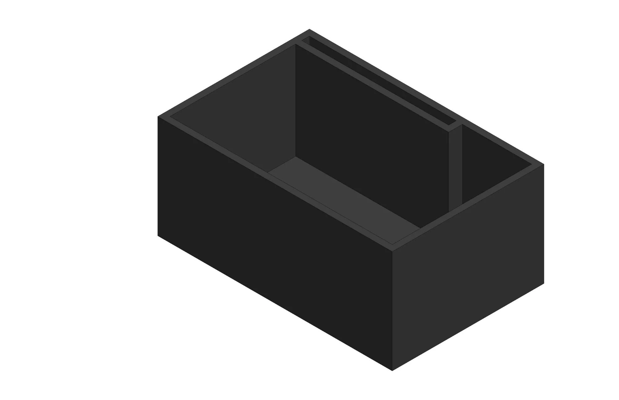

Step 3: Create the Shell
Now that we have models of the electronic parts, we can design our enclosure around them. I start by shelling out a rectangular prism, creating an open box shape.
As we create features, we are striving for uniform wall thicknesses because injection molding, the process we’d use for mass manufacturing, requires it.
I’m going to use .040” wall thicknesses because that will be 3D printable as well as injection moldable.

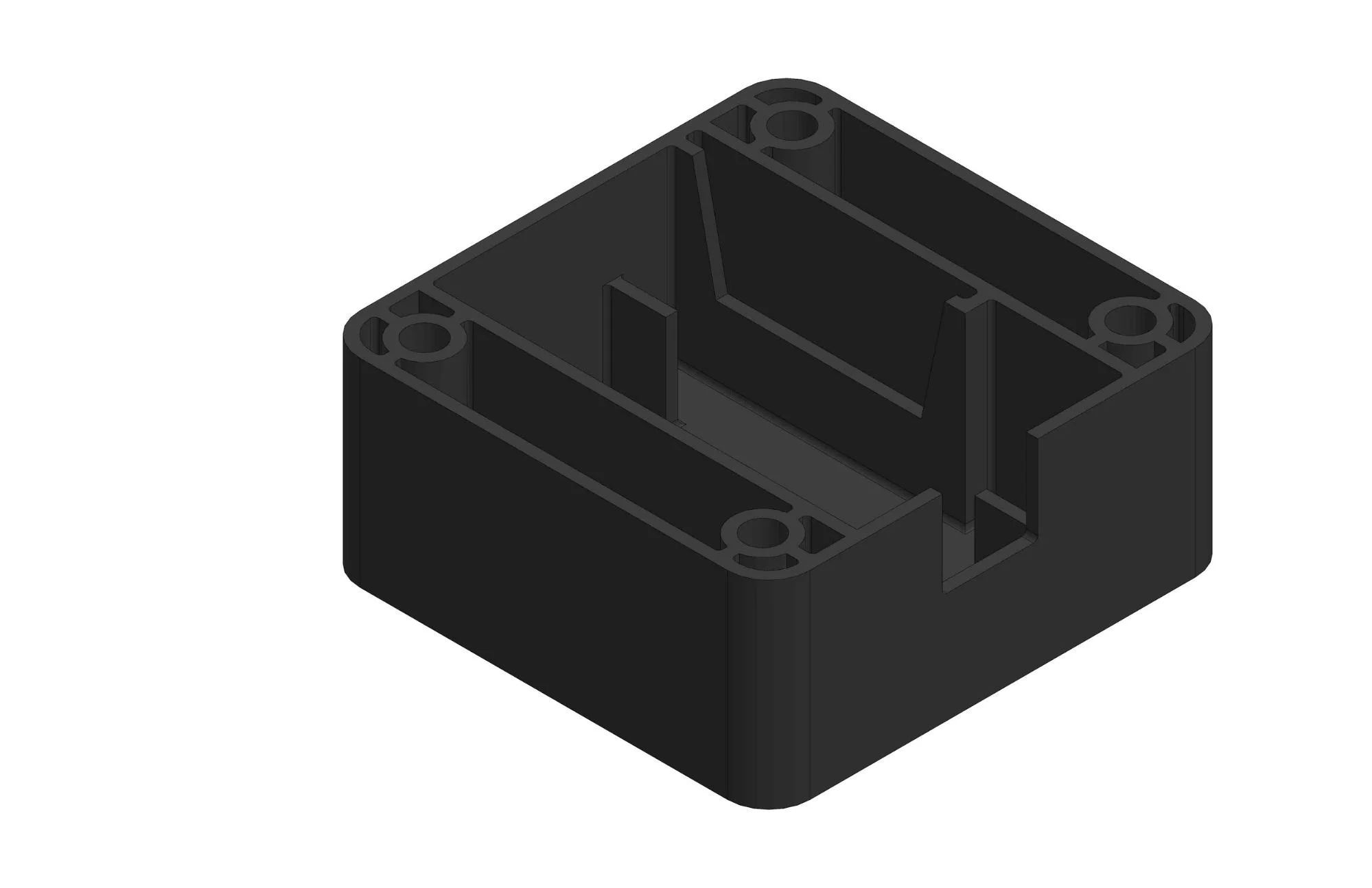

Step 6: Create Support Ribs for the Photon Board
The Photon board is currently being held on one side by its micro-USB connector, but we should add supports on which the board can sit.
Luckily, there is nothing mounted on the bottom of the Photon board, so we don’t have to worry about hitting anything. A pretty simple way to create supports is to add ribs of our uniform thickness, where the board can rest.
Here’s a current view of the assembly so far:

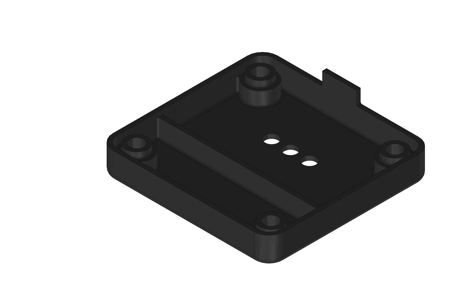

Step 7: Add Lid Fastener Features
Now we need to think about how the lid will be attached. I’m a big fan of the socket head cap screw, so let’s add some extra features around the outside of the enclosure to allow a fastener to pass through.
The features you see here are typical in injection molding. Bosses surround the fastener holes and have additional ribs to the outer structure for support. All geometry has our same uniform thickness of .040”.
Step 8: Add Nut Features
A trick for using metal fasteners in plastic parts is to countersink, or cut, the exact size of the nut on the bottom side of the part, keeping it from rotating while you screw in the fastener.
Step 9: Fillet Outer Corners
Finally, we’re going to radius the outer corners, which will decrease the stress concentration there and also make the enclosure look a little more friendly.
We are still keeping a uniform thickness, so for the outer corners the outer radius (0.140”) will be slightly larger than the inner radius (0.100”).
While we’re at it, let’s radius our internal corners, too. It’s important to keep these small to avoid adding too much material and increasing wall thickness.
Here is the completed bottom half of our enclosure:

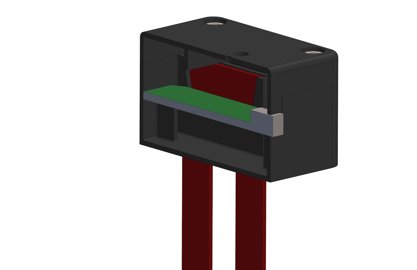

Step 15: Radius Internal Corners
The final step is to radius all of those sharp corners that are not only aesthetically unpleasant, but have large stress concentrations. Again, we’re going to keep the radii small (.005”) to avoid adding too much material.

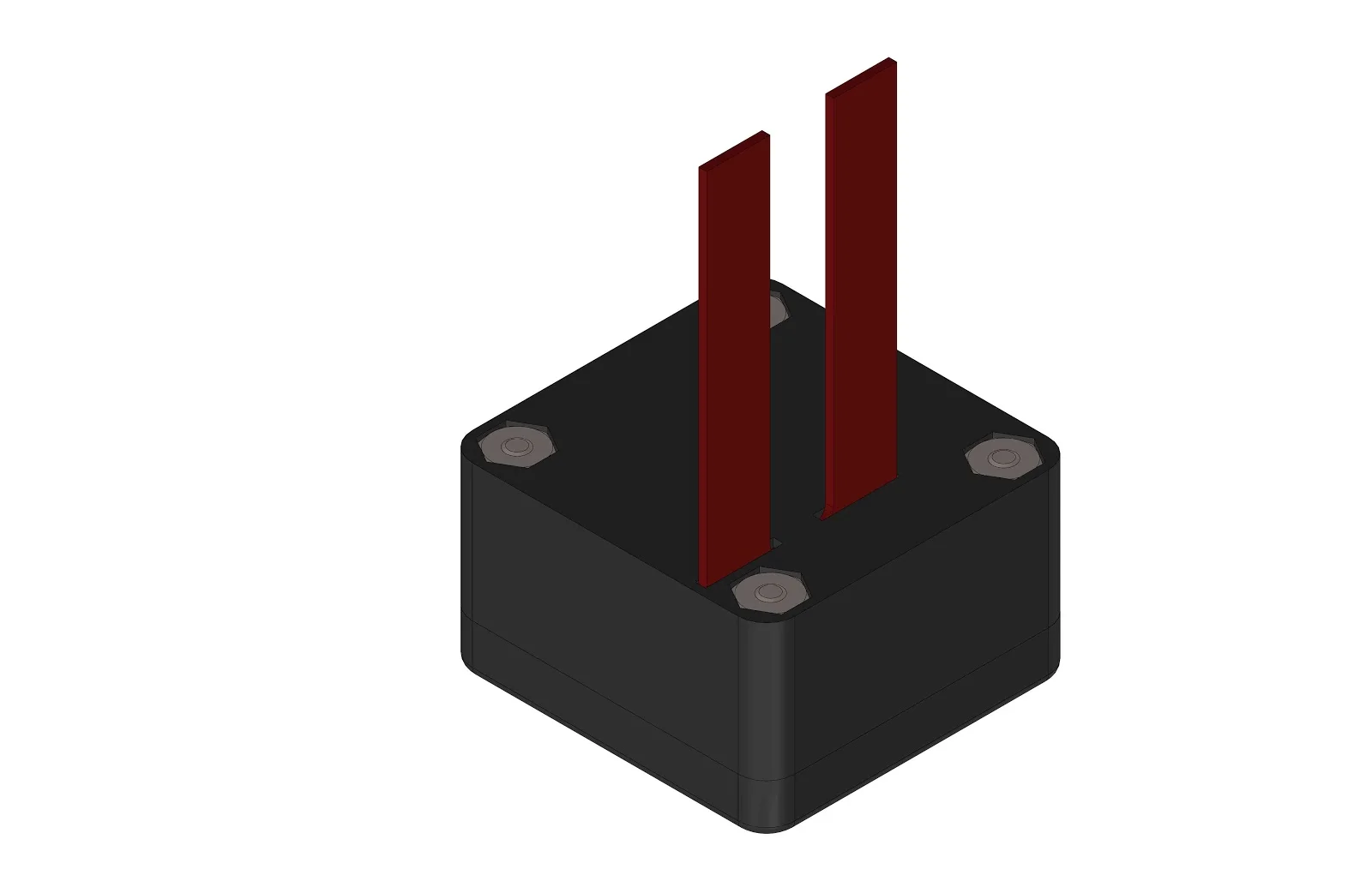

Now let’s add the lid to our full assembly and throw in some hardware.
Be sure to leave space for wires and their bends! It’s easy to forget about wire routing while you’re designing until you’re trying to assemble the product. You can see from the above section view that I’ve left plenty of room (nearly half an inch) above the board for wires and the small temperature sensor.
