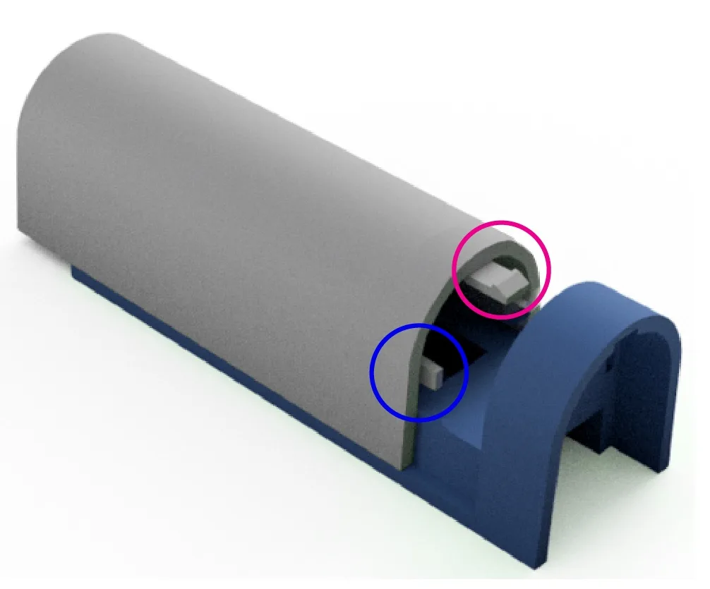

All joints have similar features and functions. In its simplest form, a snap-fit is a small protrusion — a male component (hook, bead, or bump) that is deflected during assembly to catch in a female component (a depression) on the mating part. The shapes of the male and female parts determine whether the joint can be separated and the force required to do so.
For this article, we’re going to focus on the cantilever snap fit, a simple yet effective cantilever-style joint. If you’ve reached the point in your career that you can admit you’ve “snapped,” well, entire books have been written (examples via Amazon here and here) about different types of snap-fit joint designs — other designs include annular snap joints and torsion snap joints. Yet, the cantilever style and its variations are both the easiest to design and the type you’re most likely to encounter.
As you can see in the diagrams above, the cantilever snap joint is modeled by a fixed-free beam with a point-applied end load.
