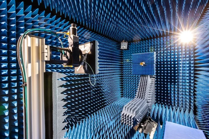

EMC Testing
EMC testing measures the strength of the electromagnetic fields that your product generates to see if it falls within limits set by the FCC. The requirements for different products vary, but you can determine applicable requirements by combing through regulatory documents. The simplest way to assess the requirements is to engage with FCC-accredited test labs and leverage their expertise.
A comprehensive list of test labs can be found here. To get timely and helpful feedback from test labs, you’ll want a signed NDA, so be ready to provide a breakdown of where you plan to sell your product and its expected use cases. The test lab representative can help you determine market and product-specific requirements.
It’s worth noting that some products are exempt from EMC testing, though these exemptions aren’t typically within the realm of consumer electronics. The Code of Federal Regulations, Title 47, Part 15 (47 CFR 15), Section 15.103 spells out the exempt devices, but the FCC still strongly recommends that all products meet the technical requirements of EMC testing. Regardless, the FCC can still stop the sale of your exempt product if it’s shown to produce harmful electromagnetic interference.
