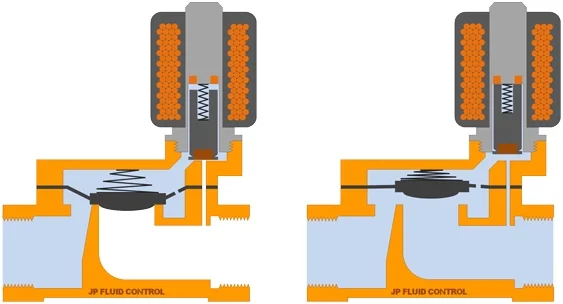

In pneumatic and hydraulic circuits, there are times when the forced needed to be exerted by the solenoid is too big (for example, to open or close the water supply pipe of a whole neighborhood).
In these cases, rather than having the magnetic field act on its own to perform the action, in what is known as a direct circuit, a membrane is used to take advantage of the fluid. The solenoid only acts over a small portion of the fluid, known as pilot, to control a pressure differential that uses the same medium to open or close the membrane. This is known as indirect control.
example of indirect control
