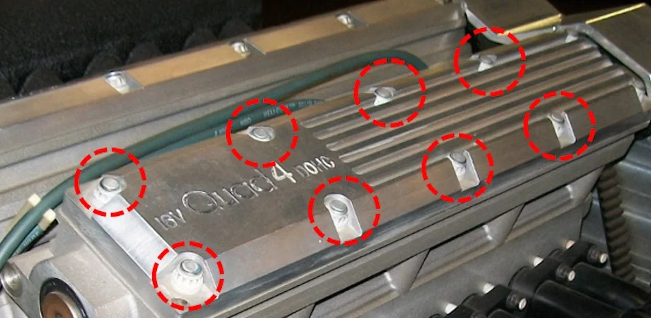

Threaded fasteners, such as bolts and nuts, are used in many applications, ranging from plastic toys to massive bridges. And all threaded fastener connections need to stay together when we want them to, but also come apart when needed. For example, the valve covers on an engine must remain in place while driving, but we also need them to be removable so we can service the engine components.

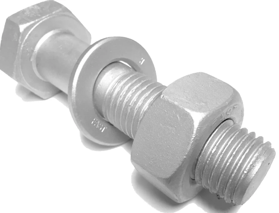

There are many types of threaded fastener connections, but the primary types are as follows:Bolt, Nut (Washer Optional) – Seen below, this is the most common and low-cost type of threaded connection. It’s used in applications ranging from automobiles to cell tower antennas.

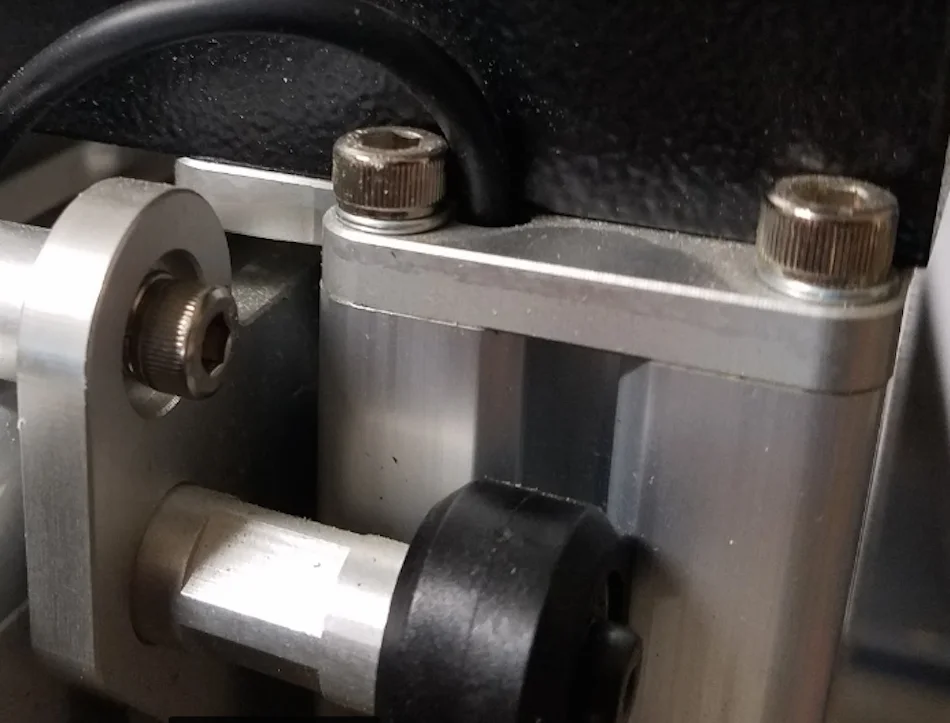

- Screw, Tapped Hole – With this type of connection, a screw is installed into a drilled and tapped hole in a housing or mechanical component. The most commonly recognized difference between a screw and a bolt is that screws typically go into threaded holes. In contrast, bolts go through 2 unthreaded components and fasten with a nut because screws have a tapered end and bolts have a non-tapered end.
We can see three cap screws installed in tapped aluminum components. Screws are used instead of bolts for precision, ease of assembly, and increased component rigidity — or likely a combination of those factors.

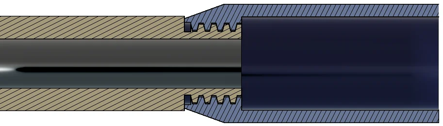

- Threaded Components – These are most commonly shafts or housings (typically cylindrical) that have both been threaded to fasten together. A flashlight bulb and battery tube is a good example.

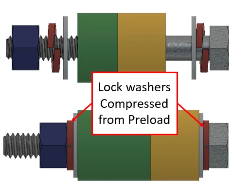

Since the purpose of a bolt is to clamp two or more parts together, the applied clamping load stretches/elongates the bolt. This stretching or elongation is the preload or clamping force and remains after tightening the nut to near its elastic limit as long as the nut doesn’t loosen. This preload is axial and puts the bolt in tension while the members clamped together are in compression.
The torque required to create this preload is measured in units, such as in-lbs or N-m, but is always just a force acting to “twist” the components together. With threaded components, this torquing together creates an axial force (the preload). The image below illustrates a before and after picture of a bolt being tightened. The red lock washers are in the expanded state, but when the assembly is torqued together, the lock washers are compressed and behave as springs.
Pro-tip: when tightening a bolt/nut/washer connection, hold the bolt head stationary and apply torque to twist the nut tight; this prevents the bolt shank from fracturing due to thread-friction-induced torque.To calculate the required pre-load -Fi (the force that is applied while tightening the nut), and ensure that the bolt can withstand the applied tensile load P, us the following equations:

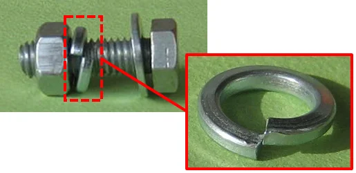

- Lock Washers – There are a few styles of lock washers, but they’re all placed under the head of a bolt or screw with the intent of preventing it from loosening and maintaining a preload.
This type of washer acts as a spring when the bolt is tightened. That spring action maintains some preload, even if the screw relaxes a little. However, these components don’t work well in high vibration conditions.

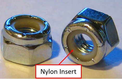

- Nylon Insert Lock (nylock) Nut – These have a circular nylon insert that locks the threads in place by deforming over the mating threads. These nuts may not hold the peak preload in all cases of vibration, but they typically retain the nut, even if it loses some preload.

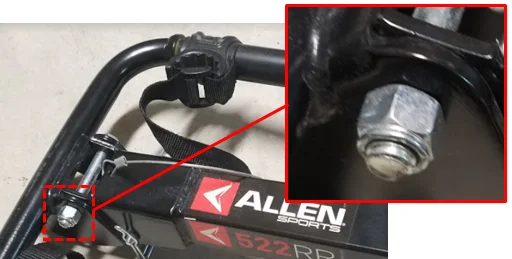

Nylock nuts are commonly used in high vibration environments on non-safety critical applications. For example, this type of fastener is used on my hitch mounted mountain bike rack, as shown below. In this application, there’s no immediate safety hazard if the preload is lost because the screw still supports the load in double shear.

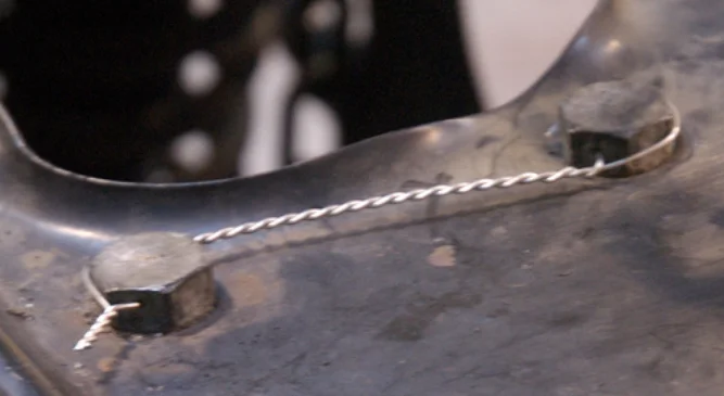

- Safety Wire – the use of safety wire is very common in aerospace, defense, and auto racing. It works by installing a steel wire through a hole in a screw, bolt, or nut and anchoring it to another item. For one nut to loosen, the other must be tightened because of the orientation of the wire. And that orientation is critical, because safety wire installed incorrectly is almost entirely useless. Safety wire is often applied between a series of fasteners to hold them all together, as seen below.

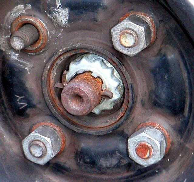

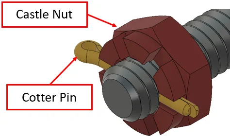

- Castle Nut/Safety Clip/Retainer Pin – There are several iterations of the castle nut, but they all behave in a similar fashion — a pin is placed through the threaded shaft or bolt to prevent a nut from backing off.
In this application, a hole is drilled in the bolt so the cotter pin can go through the slots in the castle nut. This prevents the nut from rotating in either direction to prevent loosening, but still allows for the pin to be removed and nut loosened if needed.
