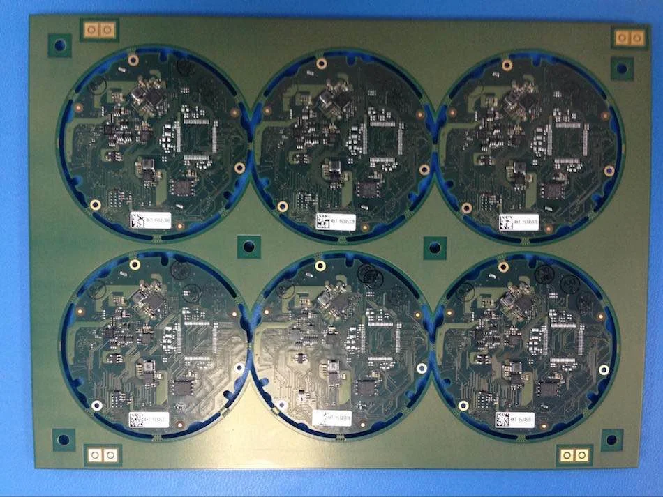

Panelize for Throughput
Here is a typical panel design you may see. The boards are held on by rat bites, and there are 4 through holes at the edges of the panels to register in the fixture. As you can see, there are no test points on the top of this board. The only exposed copper are the fiducials.
Optimize as early in the process, and then move on to the other low-hanging fruit before re-defining a process or even re-tooling. One way to do that is to assemble your main logic board several times over on one large printed circuit board. This is known as panelizing.
The main advantage of panelizing is that you can test and program units all at the same time. Another non- ideal option is to de-panelize each board and test separately, but this effectively batches testing time, creating a 6x or even 12x unit speed-up every time a test is executed.
Let’s do a quick back-of-the-napkin calculation to see the benefits here:
Time to test: 40 seconds
Time to place in tester: 10 seconds
Time to remove from tester: 10 seconds
So,
40+10+10 = 60 seconds per single unit
Let’s say your factory rate is $10 an hour, and you want to test 60 units. Your cost per unit is $10/60 = $0.16 per unit single up (yikes!)
Now, let’s panelize it.
We already know it takes 60 seconds to test, no matter what, and the factory rate remains unchanged. In this case, though, we have multiplied our testing rate by 6x (6 boards per panel), so our calculation looks more like this:
$10/(606) = *$0.027 per unit panelized (much better!)

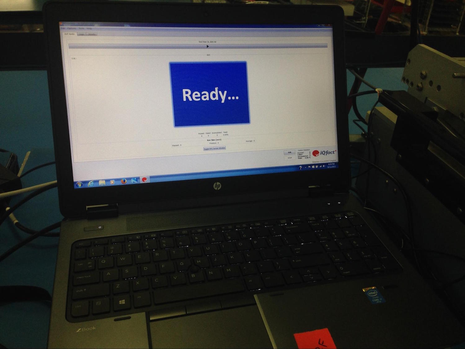

5. Use Functional Testers
Functional testers are at the core of figuring out along the assembly process whether or not you have a working product. I have seen processes using LabView, custom, and complex test fixtures, while in other cases, I’ve seen the most basic, bare bones test fixture, with a sketchy Chinese multimeter attached. The biggest takeaway from both ends of the spectrum is to avoid reinventing the wheel.
For instance, why is it necessary to design, fabricate, and assemble your own test PCB, when you can more easily purchase a Raspberry Pi or a Trinket Pro and install it into your fixture? They are pre-tested, well-used, and typically easy to program.

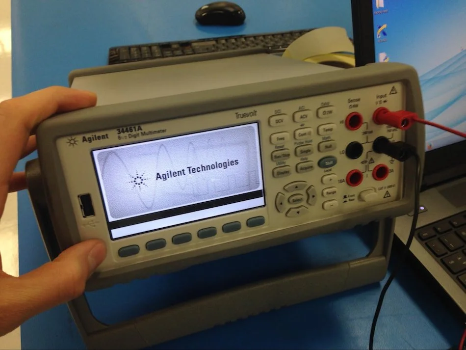

There are times, though, when using industry standard test equipment cannot be avoided. There are even some cases in which they may actually be recommended. For instance, if I wanted to measure a resistance or even a voltage on a device under test, I could:
- Build a custom PCB, firmware, etc., to measure the voltage, current, or resistance accurately
- Alternatively, I could use something like a HP/Agilent 33401A (the latest version is the 34465) to accomplish the same thing with greater accuracy.
- Or, as another alternative, have someone design the tester for you.
Test equipment exists for a reason, and sometimes it just makes sense to buy a used multimeter on eBay, rather than investing your time, energy, and cash in another unnecessary mini-project.
When searching for equipment, look for ones that allow you to send commands over GPIB, USB, and Ethernet. That way, you can utilize common Python libraries, such as PyVISA and PySerial to implement your test infrastructure.
