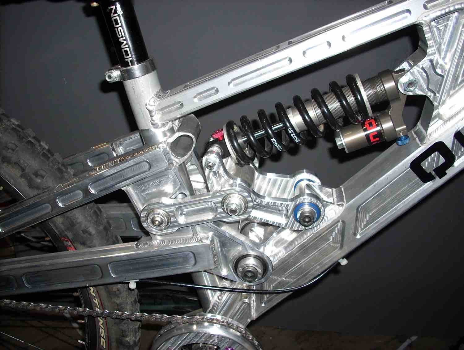

Machining, whether CNC or manual, is the process of removing material from an object, usually with rotating cutters or drills. The machining process can achieve extreme precision and is often used to place accurate holes and make smooth, flat planes. The more axes (no lumberjack) of a CNC machine, the more versatility it has. Machining is an expensive process and should only be used when the necessary precision (location, size, surface finish) of features cannot be achieved any other way. EDM is another machining method that removes material via electrical discharge (sparks). It’s great for extremely small, delicate features that a cutting tool would have difficulty achieving. However, EDM is also slow and expensive.
