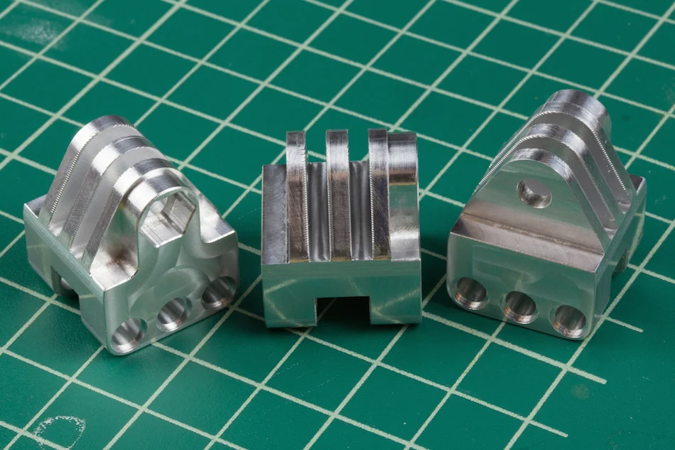

At Fictiv, all milled parts are produced using either a 2.5-axis, 3-axis or a 5-axis CNC machine. It’s wise to assume your parts will be made on a 2.5/3 axis machine, due to their common availability. With this machine type, aside from the part profile, features can only be machined on one side at a time.
Most parts can be machined in six setups or less, as they are made from a six-sided, prismatic piece of stock material, such as a sheet, bar, or strip, that’s held in place by a vice or vacuum table (or sometimes just double-sided tape!). You should try to reduce this number as much as possible—1 or 2 is ideal—as each setup requires its own CAM program and fixturing step.
