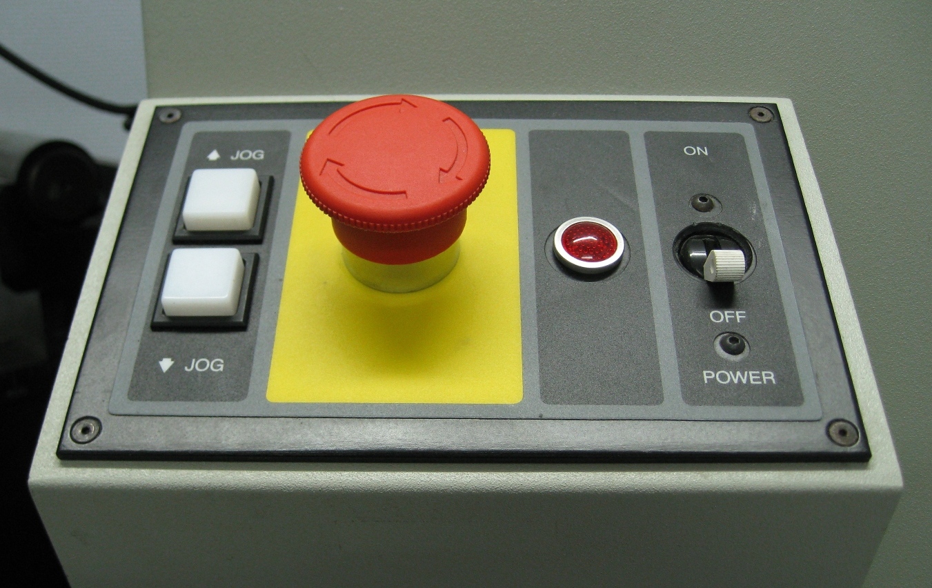

Buttons are a chance for both comfortable ergonomics and increased intuition in your product design. Large buttons surrounded by smaller ones indicate relative importance. A volume rocker button indicates a level going up and down. A single big red button says, “PANIC.”

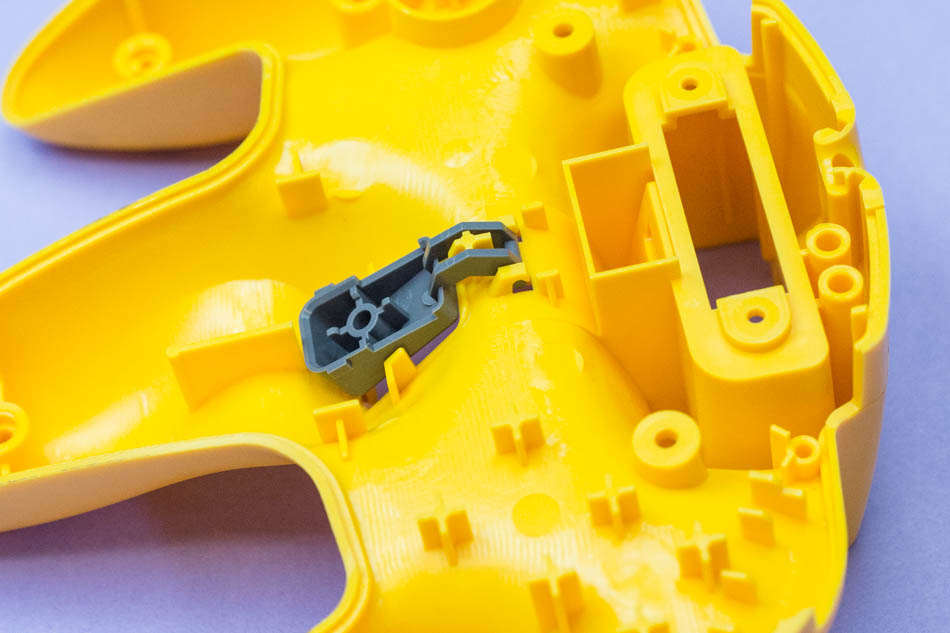

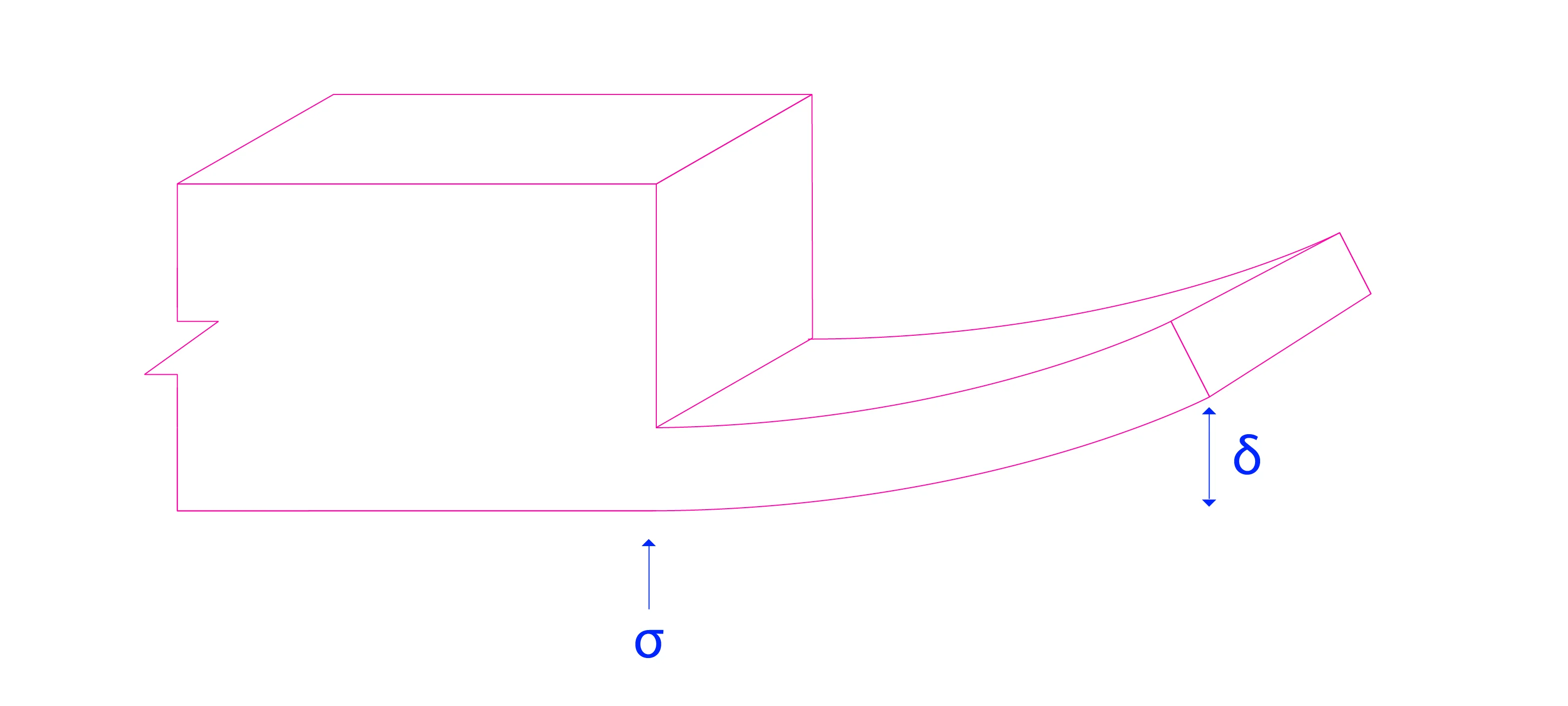

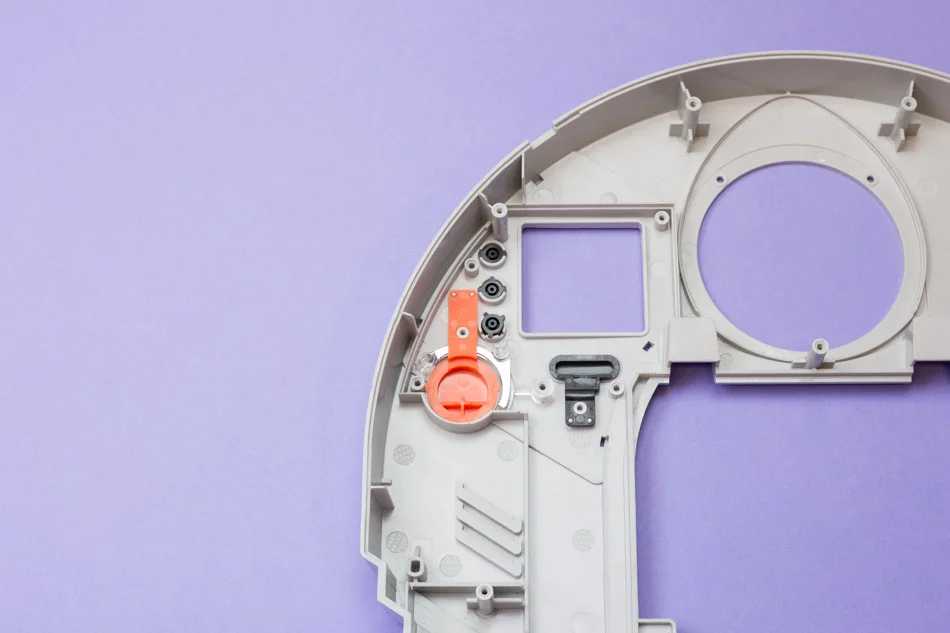

For most external buttons, the design will call for some type of mechanical spring to augment the one on the electronics component, and one of the most common ways to do this is with a plastic cantilever. The cantilever spring is a small finger of plastic that extends from the main body, flexing with each press, and pulling the button back to its rest position afterwards. There are two things to consider in cantilever design: strength and fatigue.

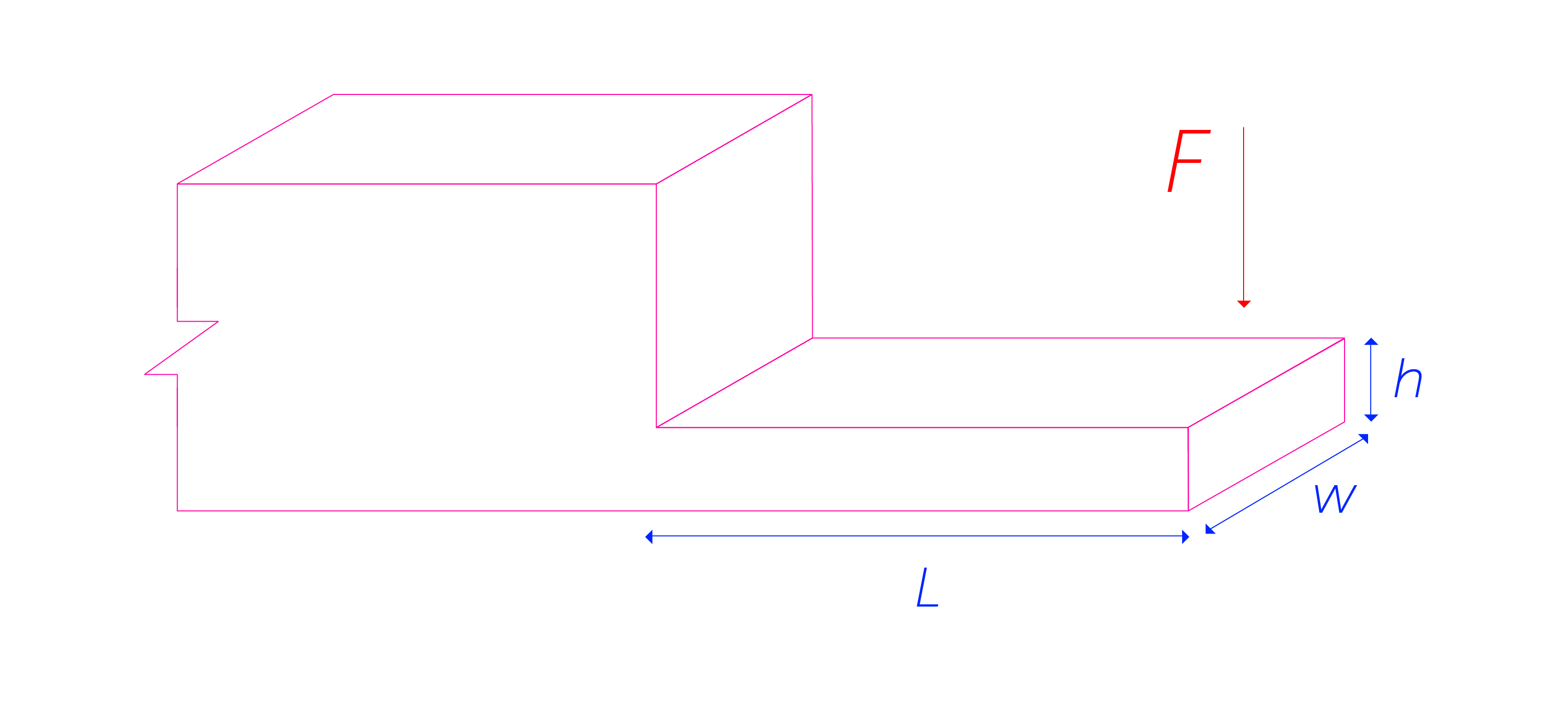

This is (roughly) what the drawings should look like:
In designing a cantilever button spring, first determine the depth of “throw”—that is, how much flex you’ll need from the button.

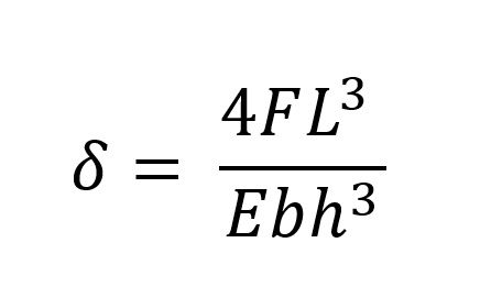

That press depth becomes the desired maximum deflection, δ. How hard the user presses is the required force, F. Look up your material properties to determine the modulus of elasticity, E.
With these factors determined, you can play with the other geometry as required for the length (L), width (or base, b), and thickness (or height, h), to balance out this equation:
(rectangular cross-section only)

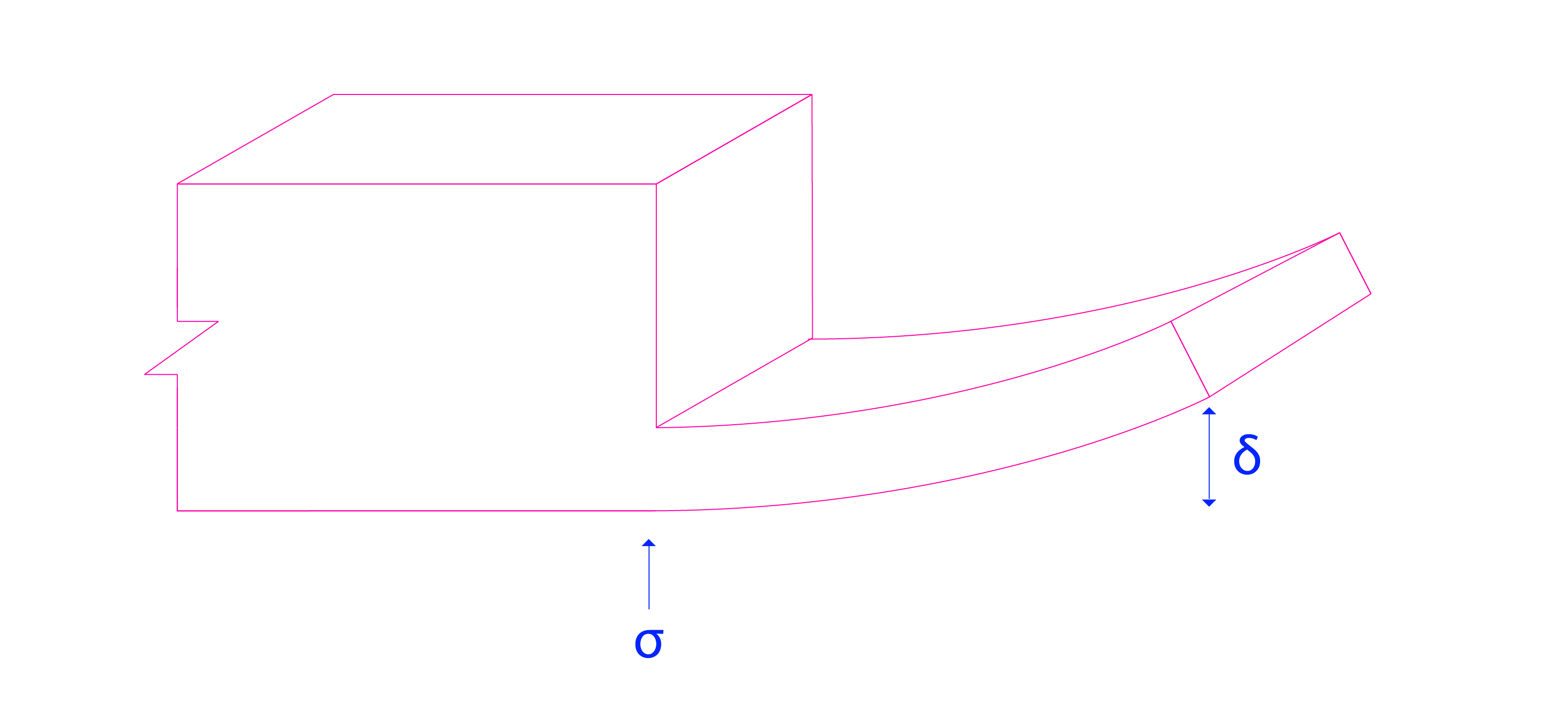

Overall, longer is better to reduce fatigue, the second part of the design to check. You don’t want a single-use button, and if your plastic cantilever-beam-cum-spring is bent too far, it’s going to snap more quickly than an office worker with a red Swingline stapler. You may remember from your Strength of Materials 101 class that the stress on a cantilever beam is highest at the origin, or in this case, where the material thickens stepwise.
The stress (?) at a cantilever beam origin can be calculated as:
Maximum stress for your material will tell you how far it can go before breaking, but for a spring like this, it’s important to stay well below that in the elastic region of the stress-strain diagram. This will vary widely from material to material, but as a general rule, you’ll want to ensure that your maximum stress is no more than 20 MPa for the toughest printed materials.

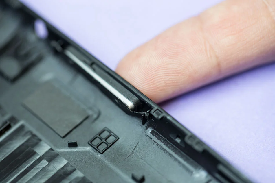

Buttons with integrated springs can either be mounted with a sliding mount, where the button is suspended between the two springs in the case, and the springs slide against their mounts, or by fixing the end of the cantilever to the housing with screws or heat stakes. Of course, when prototyping with 3D printing, you have options you won’t have with an injection molded design—essentially, any shape can be made without worrying about molding angles—so you can actually have the button printed as part of the case. Printing magic, baby!

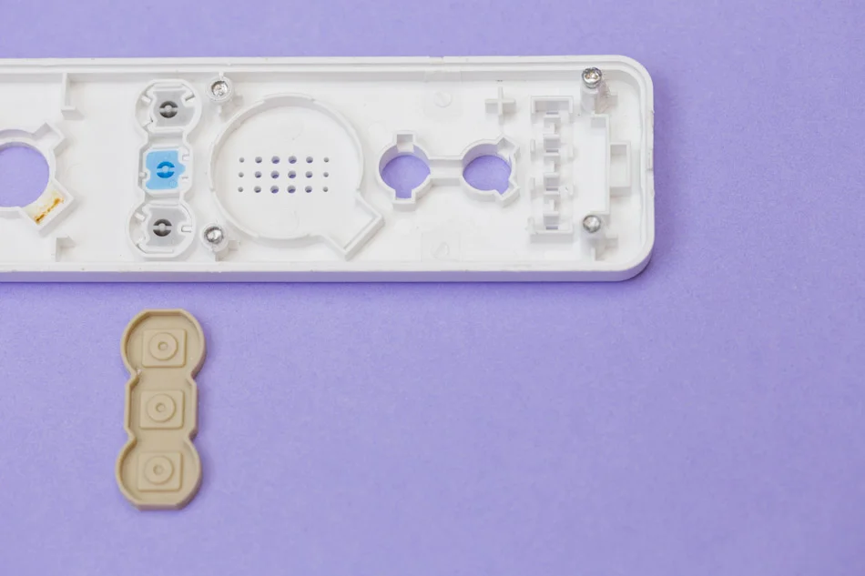

As an alternative to these unified designs, a rubber backing piece can be used as a spring. Typically, this is used in places where the plastic springs are impractical, due to button spacing, or when a large number of buttons is in a pad, like on a remote control.
A sheet with a series of rounded bumps can be printed, using the rubber-like material, and used as a backing spring for an entire control panel of buttons, freeing the shapes of the buttons from any required spring mounts.

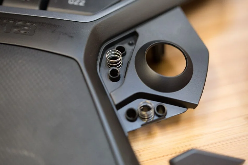

Of course, in looking for springs, a regular coil spring can be used beneath the button. This is ideal for situations with very deep press, such as a blender control panel. Long or deep-throw buttons like this indicate very deliberate action and keep the user from accidentally activating the switch.

Great for volume buttons (or any level that increases and decreases in opposition), this two-point button is a standard for most tablets and phones. Using a two-cantilever sliding design allows for each cantilever to act as a fulcrum, while the other side acts as a spring.

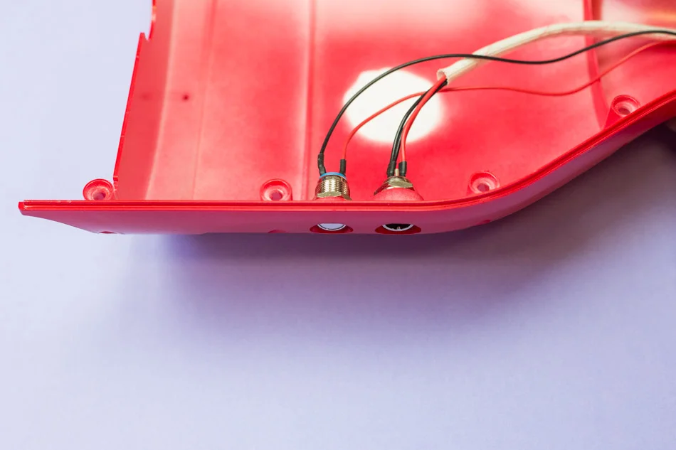

When you really have to use the off-the-shelf part, I suggest hiding a panel mount switch in a recessed area of the electronics enclosure, to retain a sleek, consumer-oriented feel.

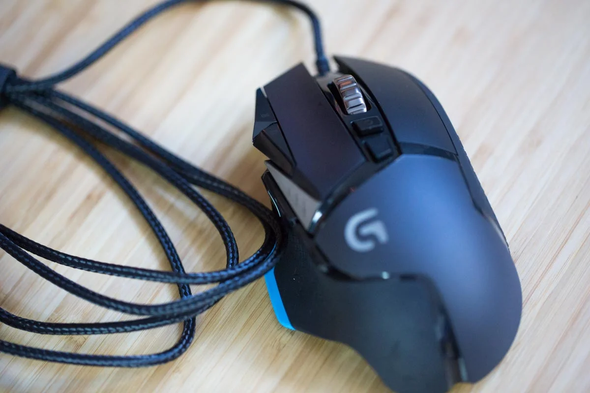

In places where the hand is fixed in relation to the device, like in an ergonomic mouse, a thumb button will often take more of a beating with hard stress presses. The thumb button is an opportunity for better ergonomics, recessing the button into a thumb-shaped indentation and providing a larger button area. Mechanically, the strength of a screw-mounted cantilever gives the solidity this type of button requires, and multiple attachment points can be used for a more solid press.

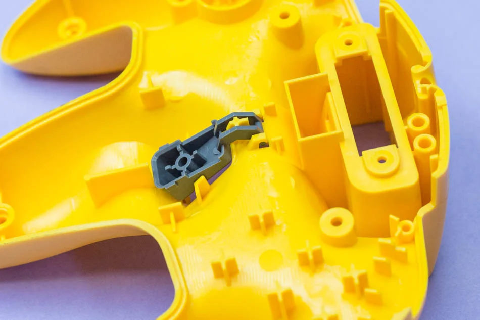

Another game controller standard, the trigger button should be easily felt and have a long throw. This unusual button is often hidden away out of sight, so it needs to be simple to identify by touch. The long throw can be accomplished with a rotating mount and either a torsion spring or coil spring for return.

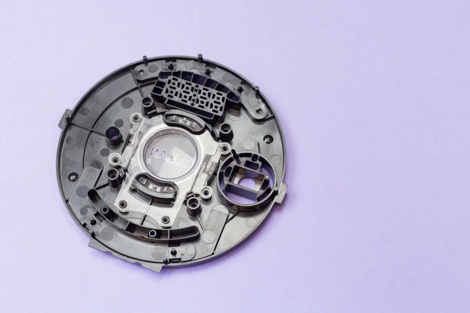

More unusually, you can also use the button as a window into the design with translucent materials. This can allow the buttons to glow, for easy use of the device in the dark (like a light pipe), or it can simply allow some of the electronics to be seen in designs showing off their technical aspects. Try the transparent material for prototyping and an acrylic or polycarbonate in production.
