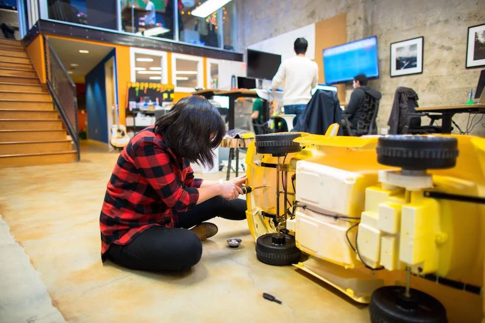

Since we were running on a tight deadline and a tight budget, purchasing the right components the first time was critical. The PRD allowed us to break into teams and have each team take on the responsibility of researching, calculating and choosing the right components for different systems of the car. In our case, we divided into three teams that were each responsible for the drivetrain, steering, and braking systems.
