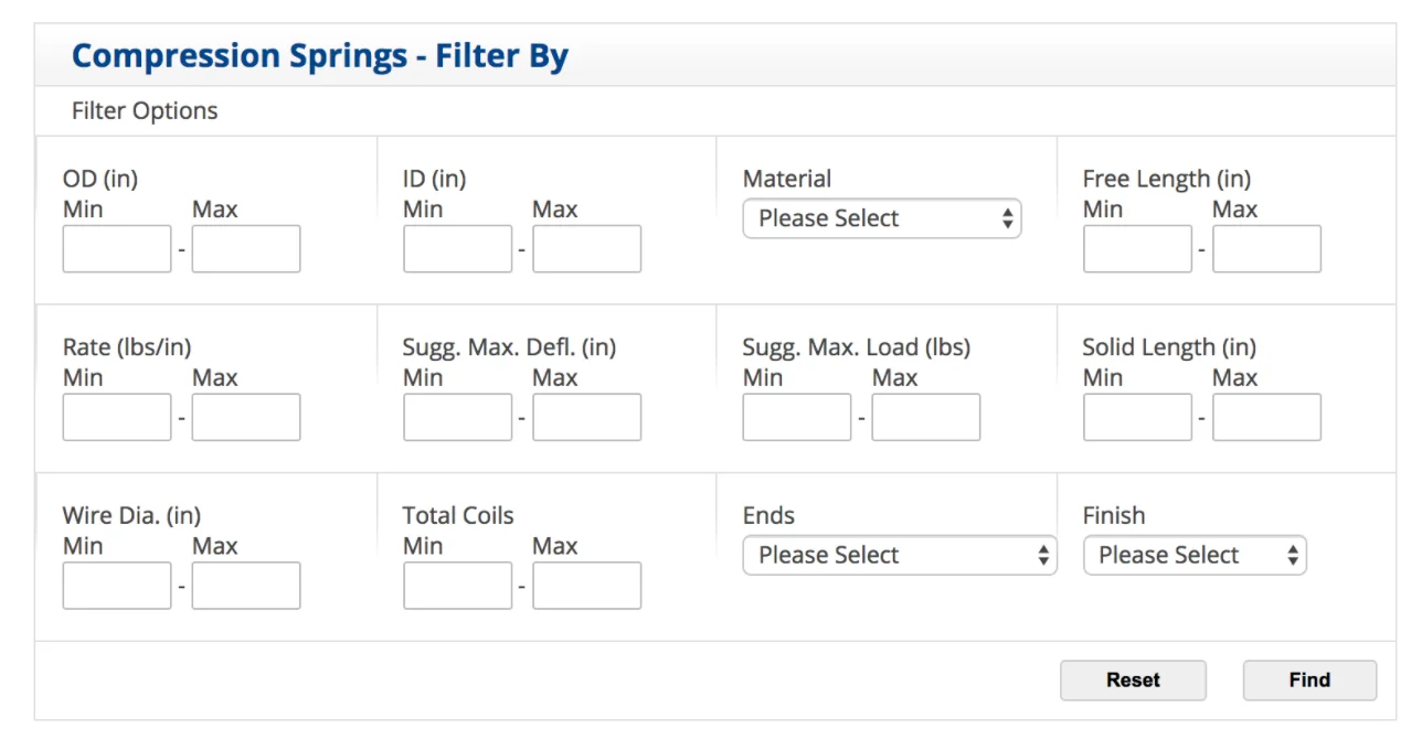

Major stock spring suppliers, like Lee Spring, Century Spring, and The Spring Store have lookup tools for their catalogues. You can usually search by geometry, by load condition, and by materials. I like to filter by maximum deflection and maximum load first, because those tend to be less negotiable.

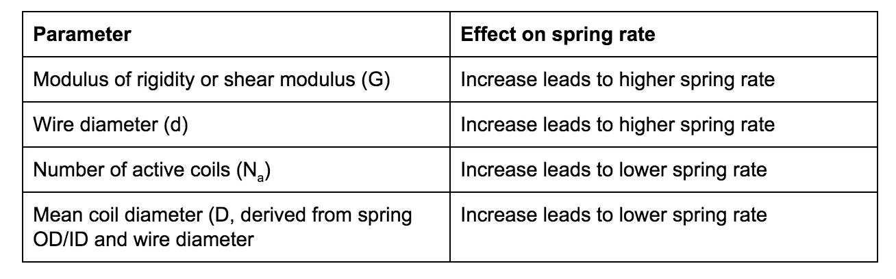

Here are four ways to tune an off-the-shelf helical coil spring’s spring rate (k), the amount of weight needed to compress a spring one inch:
One must be careful with the ratio of wire diameter and mean coil diameter. This ratio, d/D is referred to as “spring index”. The smaller the spring index, the harder it is to manufacture the spring, and the unit cost will increase accordingly. A spring index between five and ten makes an easy, economical spring.
