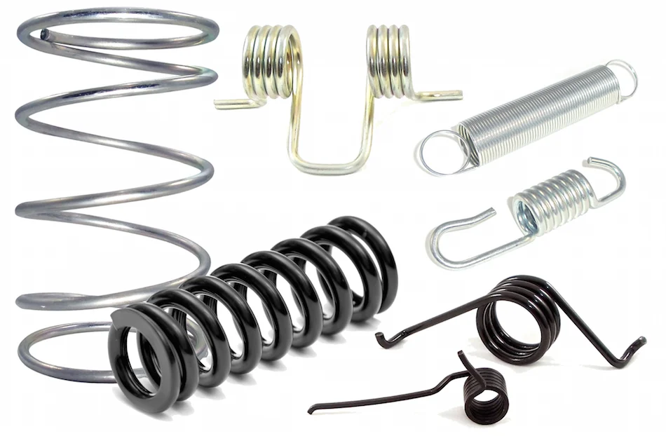

The most common way to classify springs is by how the load is applied to them. These are the most common classifications of springs:
- Compression springs: designed to operate with a compressive load. Found in shock absorbers, spring mattresses, mechanical pencils, and retractable pens.
- Extension springs: designed to operate with a tensile load. An archetypical example is a Slinky, but extension springs are also found in luggage scales and garage door mechanisms.
- Torsion springs: designed to operate with torque (twisting force). These springs power every clothespin and mouse trap.

Coil Springs
Lightweight coil springs are made by forming metal wires on a CNC coiling machine. The multi-axis CNC control allows you to create variable pitches and end conditions only limited by your imagination. Springs that come off coiling machines do not have springy properties. They need to be heated to a high temperature (typically 500 degrees Fahrenheit or more) to relieve stress, then quenched to create the shape memory.

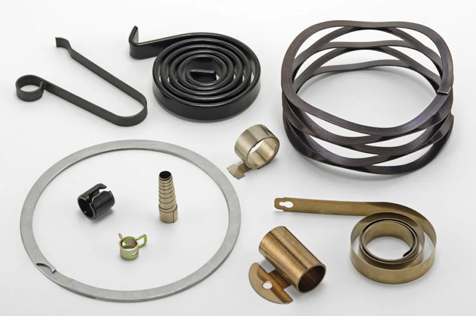

Flat Springs
Flat springs come in all sizes and shapes. Spring washers, PCB spring contacts, and retainer clips are all examples of flat springs. These springs are essentially sheet metal parts made by stamping. However, there are coiled flat springs as well, such as clock springs and volute springs — and all flat springs need be heat treated for shape memory.

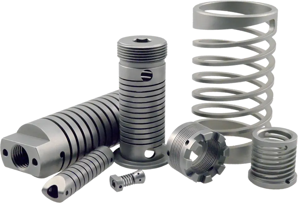

Machined Springs
Machined springs and die springs are used for heavy duty applications with high strength and precision requirements. As the name suggests, machined springs are made on CNC lathes and mills.
