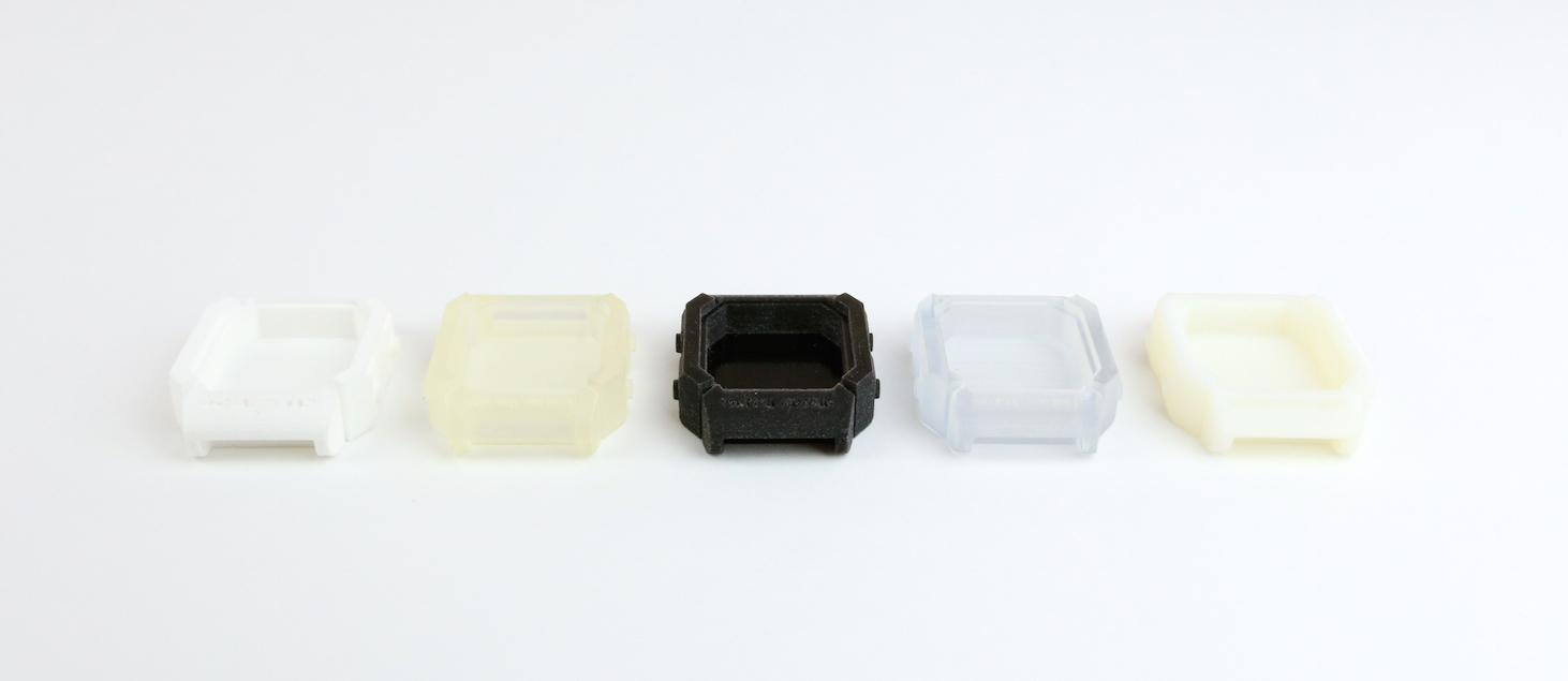

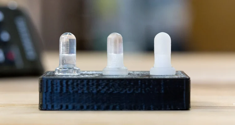

Also useful in the prototyping phase is the 3D printed transparent housing, which is a very helpful tool to gain insight (literally) into what’s happening inside an enclosed product, such as a gearbox. While commonly use for lube flow observation, a clear housing is also invaluable for observing physical mechanisms which are otherwise shrouded in darkness. A clear housing makes the understanding of a click or clunk as easy as looking through a window.
As an example, you can see the aesthetic difference between different clear 3D printing materials in our post about prototyping light pipes.

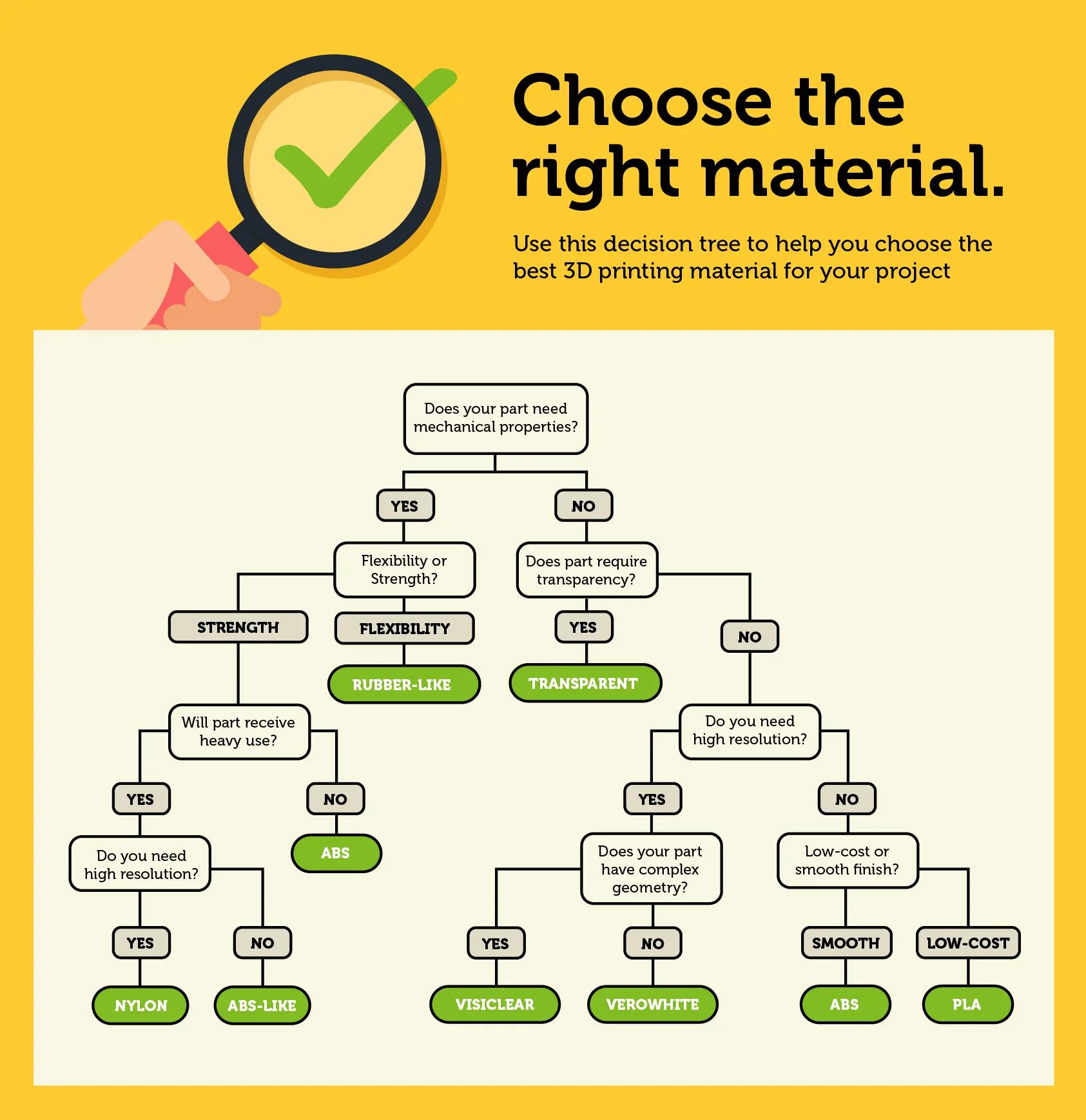

Choose the Right 3D Printing Material
There are many different 3D printing materials available. To find the right material for your prototypes, use this material decision tree to consider the most important features you’re looking for:
