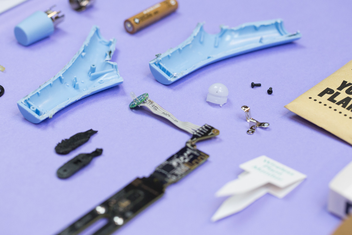

Moving on to the construction of the Flower Power itself:
You’re supposed to stick the entire black lower section into the soil near your plant. A closer look reveals that it’s actually a multi-layer PCB that extends out from the sprout-shaped blue section. It doesn’t quite look like a conventional PCB, because there are no exposed copper traces and pads.
There is a seam running along the blue “sprout,” but the plastic enclosure halves are ultrasonically welded together. This assembly method is commonly found on products that need to be watertight.
Nothing can stop our Dremel though!
After we bisected the enclosure, we found just two PCBAs, two screws, three polyurethane gaskets, and three sheet-metal parts. Jaw-droppingly elegant.
It’s worth noting that the only moving part in Flower Power is the twist-off battery compartment. The less components there are, the easier it is to waterproof. Moving parts can be a pain to waterproof.
Two sheet metal “barrels” are used to hold the battery. A third sheet metal part connects the battery’s positive terminal to a pad on the main PCBA. Sheet metal spring contact is a great way to conduct electricity without soldering or using expensive connectors.
This part is heat staked to the plastic enclosure, eliminating the need for messy adhesives, and fasteners would be overkill for this application.
The gaskets (pictured below) are placed where the plastic enclosures can’t be welded together, such as around the light sensor window, the battery cap, and between the enclosure and the main PCBA. Using gaskets is a tried-and-true waterproofing technique.
The main PCBA holds most of the goodies: MCU, antenna, and some of the environmental sensors. The finish on the PCBA indicates that there is a conformal coating, which is a super thin polymeric film used to protect circuitry against moisture and dust.
The system’s brain is a TI CC2540 Bluetooth Low Energy microcontroller.
There is also a thermistor for sensing air temperature on the other side of the board (bottom right; L202).
On the exposed section of the PCBA, the two PCB prongs measure moisture of the soil between them.

The ambient light sensor is mounted on a small peripheral PCBA. A ribbon cable connects the light sensor board to the main PCBA by through-hole solder. Again, no connector — that costs money!
