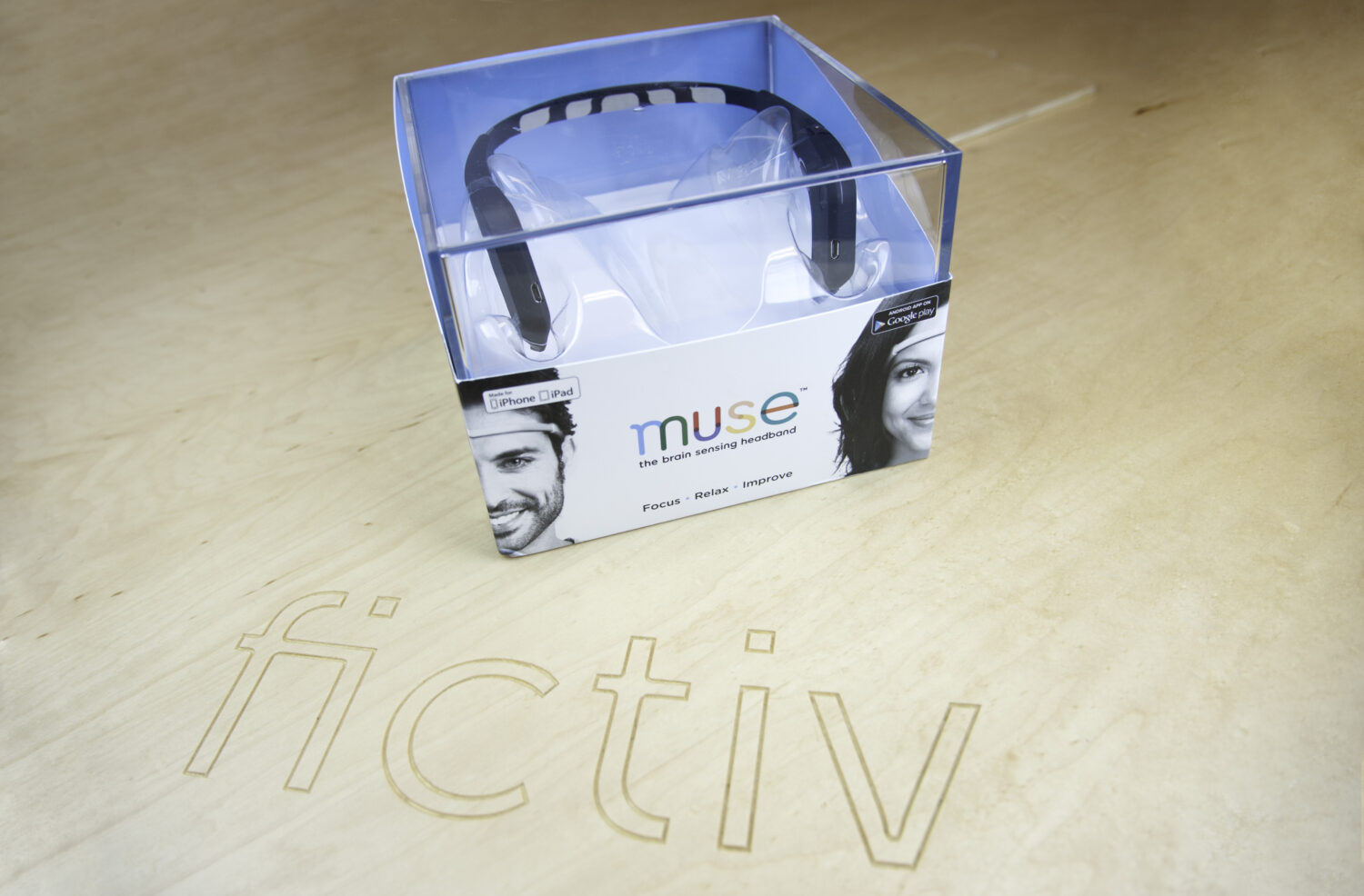

Packaging
Our first impression of the packaging is that it would look really nice on a display shelf in Best Buy (as long as they don’t slap an awful sticker across the front).
Looking a little bit more closely, however, we notice that the product is held down by… tape!
Their engineering team probably thought the vacuum formed plastic would hold the product in snuggly, and then after a shake/drop test realized the headband actually came loose. Tape (and glue) fix all last-minute engineering troubles!
There’s also this slightly awkward pink tab that indicates how the packaging should be separated:
And then, when we take the casing out of the box, the cord is unravelled messily:
Maybe we’re being overly critical, but the first impression of the packaging was so positive only to find the finer details amis.
Also, it’s just a bit much — there’s so much packaging!
