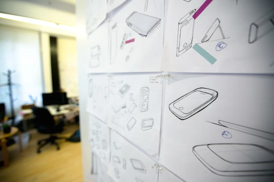

The prototyping process is really something they drill into you at Stanford. In the engineering building they had a sign on the first floor that read, ETC – express, test, cycle. This means that you give just enough form to an idea that allows you to gather useful feedback, then you test it out and gather that feedback and repeat the process over and over. It was the one thing they wanted all engineers to know because without continuous learning and testing, the products you design will fail to hit their mark and truly solve a customer’s problems.
How did that philosophy take form throughout your product development?

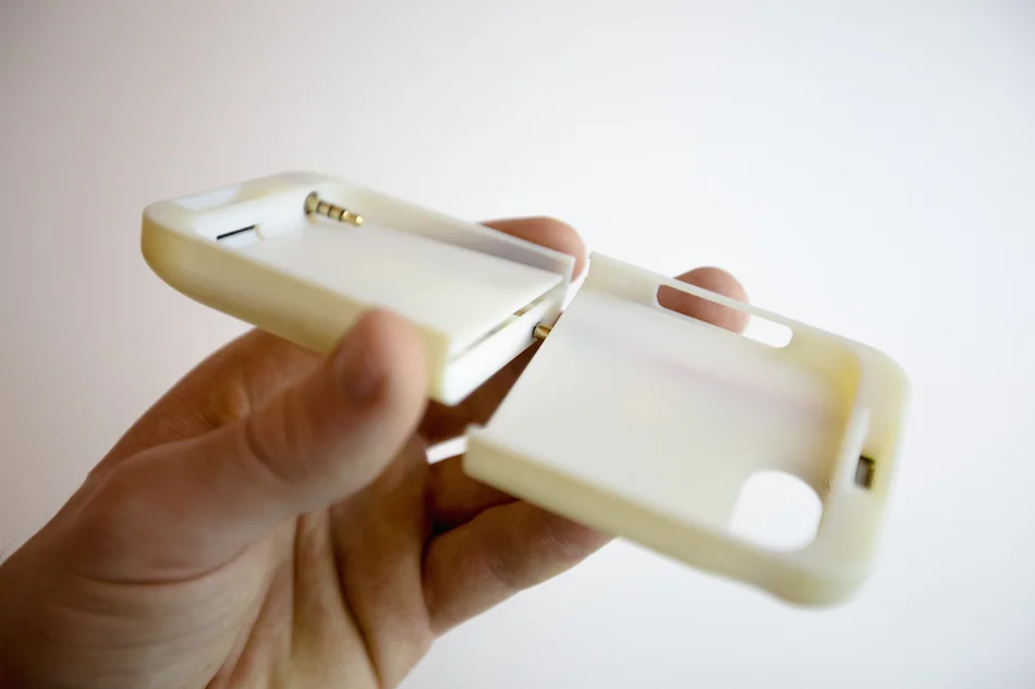

Throughout our process we weren’t afraid of really low fidelity prototypes. Sometimes that actually helps customers imagine what it could be rather than what it is. In the beginning you don’t really want to have too much detail – you just want to get early feedback on the core concept, asking questions like, “if you had a rectangular box on your headphone cable, would you buy it?”
So before we had people test out a fully functioning product, we took 3D printed prototypes, just solid chunks of plastic with no electronics, and handed them to people in a nearby park and asked them really basic questions like, “does this feel good and does this fit in your pocket?” It’s surprising how big a difference even a few millimeters can make in terms of reactions to the physical form of a product. Like, .8mm is a giant GIANT amount of size. I kid you not, .8mm makes or breaks products.
What was the impact of 3D printing in your overall process?
Little things you would never know about just from a rendering will materialize into very big things. Like buttons, for example. You see it in CAD and you’re like, “oh, it looks big, but it’s not THAT big.” And then you print it out and you’re like, “that looks like a button monstrosity, a button designed for a pre-schooler so they would never miss it.” Those are the sorts of things you don’t see until it’s physically in 3D.

After we landed on the right form factor for the product using the basic 3D prints, we decided to make 40 beta units of the headphone adaptor and actually sell them. Eric, the CEO of Pebble, gave us the advice that every customer who interacts with a beta needs to treat the product like it’s the real thing or else they will promise to use it and then it will sit on a shelf for three weeks. So we sold each unit for $100 each and put in extra effort with the packaging and presentation using soft tooling with really nice finishing and these nice little boxes with well designed instruction pamphlets to make people believe the beta units were like a finished product.
What kind of information did you garner from this testing?

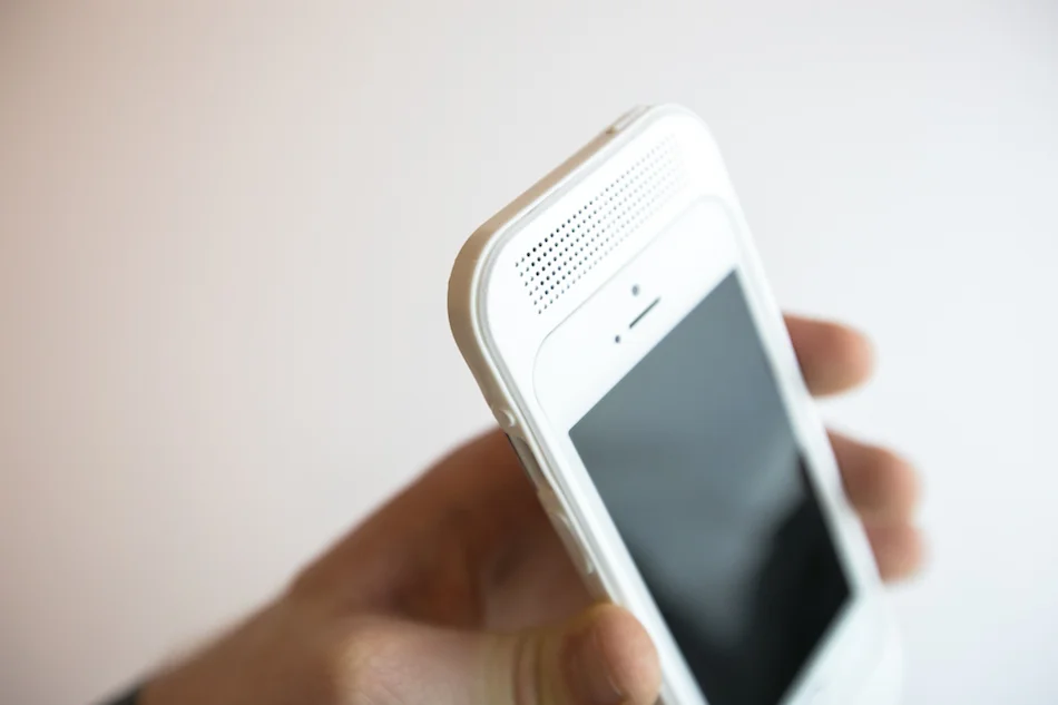

The reactions were great and people really treated it like a real product, giving us extensive and high quality feedback. We learned that people really loved it but complained about having to remember to charge the thing. And if your most enthusiastic customers – your 10 out of 10 net promoters – are complaining about a particular issue you have to listen closely. So that was when we realized we could move toward building a smartphone case rather than the headphone adaptor. With our new product called Amp, which is now available for pre-order on our site, you don’t need any other devices. You get the benefit of having two high quality speakers with you all the time. You have incredible hands free calls, great sound from all your apps, and your headphones sound like they’ve been remastered. That with the added bonus that you don’t have to worry about charging, when you charge your Amp, you charge your phone.

First I’d say that high quality prototyping like 3D printing is awesome, but even before you do that, you should go quicker and dirtier – fold up some paper like origami style and do a gut check. Because that gut check takes you 5 minutes and zero money. Some companies burn big holes in their pockets spending thousands of dollars on prototypes when they could have learned a lot in 5 minutes from a couple pieces of foam board duct taped together.
