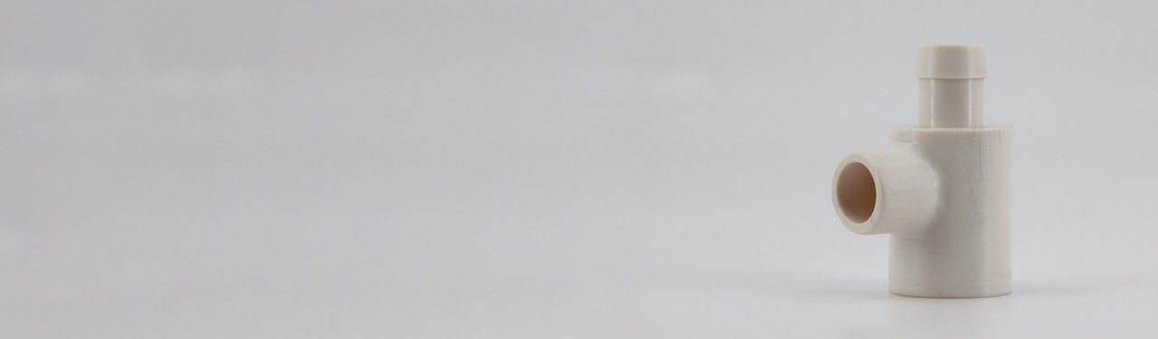

PPS has an opaque, off-white finish when machined. It has a smooth, matte appearance post machining and can be machined to a variety of surface roughnesses.
