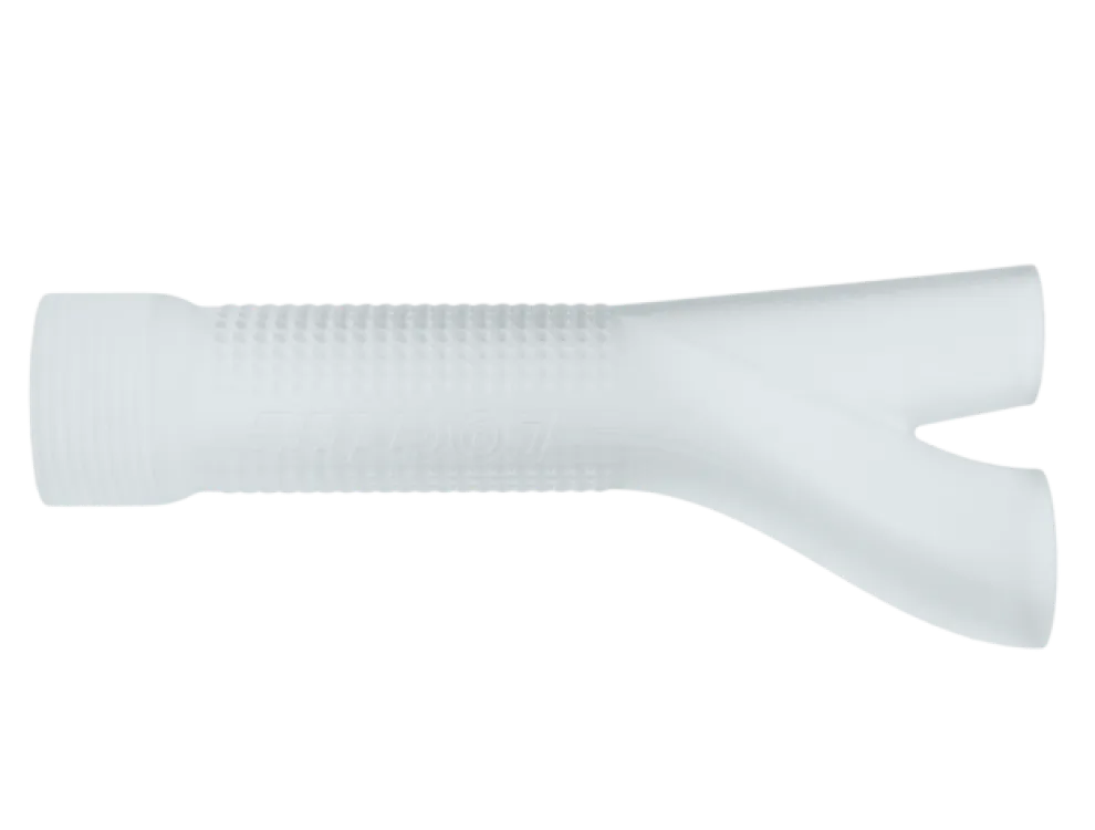

Loctite 3D IND405 Clear thumbnail graphic
LOCTITE 3D IND405 Clear is clear, tough, and semi rigid. The material is produced as a one-part resin. It offers an attractive, frosted clear finish that can be post-processed for enhanced clarity. Its mechanical behavior is comparable to unfilled propylene.
Ultimate Tensile Strength
42 MPa / 6000 PSI
Elongation at Break
n/a
Heat deflection temperature
53°C / 127.4°F @ 0.45 MPa
