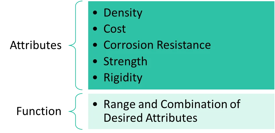

Step One: Screening & Ranking Material Attributes
The first step begins with compiling a full list of possible materials — so start with a list of common materials (Google can show you the best materials or most common materials for your application if you don’t know). Gather as many materials as you can in the beginning, because it will take more work to go back and fill this information in later.
The primary task of this first step is to populate all the attributes that are relevant to your design. This includes those related to the material itself — such as mechanical, thermal, and electrical properties — to the ease of sourcing, and the cost of manufacturing and raw materials. Property limits (ranges for the desired attributes) should be considered at this step. Compiling this data will enable you to remove materials from the list that don’t meet the performance and economic requirements for your design.
Here are some examples of design requirements and their associated material attributes:
Design Requirement | Material Attribute for Screening/Ranking |
Lightweight, so it can float on water | Density < 1
g
gcm3
Must maintain strength, form, and function at 350℉ | Maximum service temperature > 350℉ |
Next, take the shortlist of materials and apply constraints that are intended to maximize performance — not just meet the performance requirements — to reduce the list further. Maximizing performance involves looking at the values of material indices that are a combination of two or more material attributes. Material indices arise from the fundamental design requirements of function, objectives, and constraints.
There are many rules of thumb to follow for maximizing performance using material indices. For example, if you want to maximize the performance of a spring, you should evaluate each material’s failure stress divided by Young’s modulus:
material indice for spring performance, maximize 2E
Fortunately, there are materials property charts that provide analysis of material attribute limits vs material indices, which gives you a quick way to analyze which material meets your criteria.
