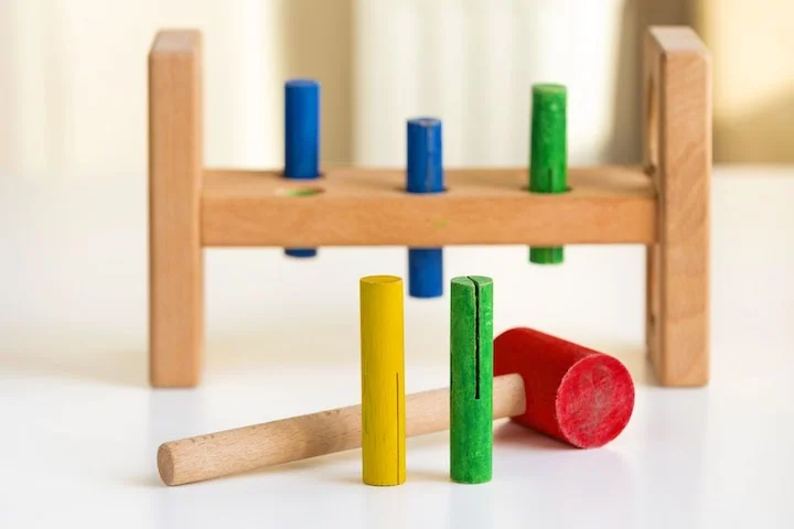

If you have kids or have been around toddlers, you’re probably familiar with a variation of the pound-a-peg toy shown in the image below. A toddler inserts a peg into one of the holes and pounds it in with the hammer. The tapered pegs stop when you hammer them far enough to achieve a press or interference fit.
Is this toy meant to develop hand-eye coordination, or is it part of a larger strategy to expose children to different simple mechanisms and encourage them to enter a STEM field? I’ll let you decide for yourself, but I definitely have an ulterior motive with my toddler!
Regardless of why you’re introducing press-fit toys to your kids, they’re a simple representation of how engineers plan fits in their mechanical designs. Press fits are great for adapting to many situations, aligning parts, and forming lasting bonds between components.

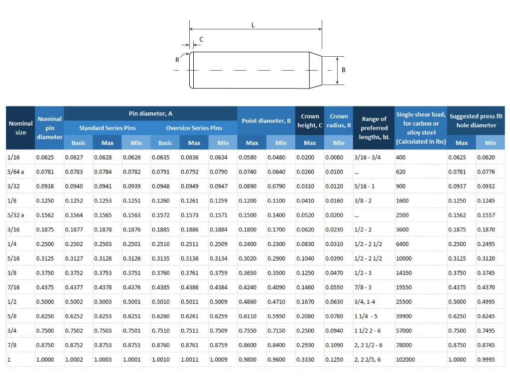

Calculating how tight the ideal interference fit is made easy with dowel pins as an example (other press fits require exorbitant machining). It’s best to refer to common tables for determining interference, although there may be some deviations. The most important question is, how do you know if the interference is enough to hold the parts together in your design?
The answer is first to evaluate elastic deformation. When the pin is pressed into the hole, it presses radially outward, trying to regain its original diameter. Meanwhile, the hole presses radially inward, also trying to regain its original diameter. The stress of these two parts pressing against each other gives us a normal force, which, with the friction coefficient, allows us to calculate the resulting hold. This is the basis for a press fit design.

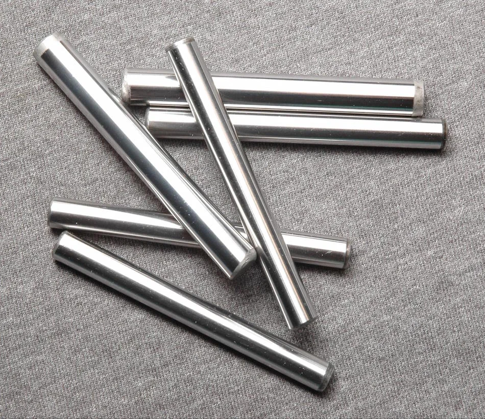

For example, take at a steel dowel pin pressed into a steel plate at a nominal half-inch diameter, one inch deep. (Why nominal? Because the pin is slightly larger and the hole slightly smaller, thus nominal — a half-inch in name only.) A standard series half-inch pin is 0.5002 inches in diameter — two ten-thousandths oversized. With a suggested minimum press fit hole size of 0.4995 inches, we end up with 0.0007 inches of diametrical interference. That may seem small, but as you’re about to see, that’s quite a lot.

In our example of a half-inch pin, using 210 GPa for Young’s modulus, 0.292 for the Poisson’s ratio, 1013.415 mm2 for the contact area (A) and 0.30 for the friction coefficient, the resulting axial force is about 45kN — roughly the weight of a Ford F350.
In comparison, a half-inch bolt can hold more than twice that amount. However, with a bolt, you can drill a hole with a diameter tolerance of 0.020 inches. With the press fit, if your hole is 0.0007 inches too big, you won’t have any interference, so press fit tolerances are extremely important.

The second rule of press fits is never to have more than two pins per assembly operation. A better solution is to use one interference fit and align the parts with a slip-fit second pin. If you must use two press-fit pins, be certain to use GD&T tolerancing, with the first hole as the datum for the second hole, to minimize the error between the two features.

For the traditional use of press fits, where the pins both join and accurately locate the parts, better designs use slip-fit dowel pins for self-locating and bolts to join the parts. In plastics, use locating pins for alignment and snap fits for assembly. These are just a couple of examples, and there are nearly unlimited options for mechanical assembly.
