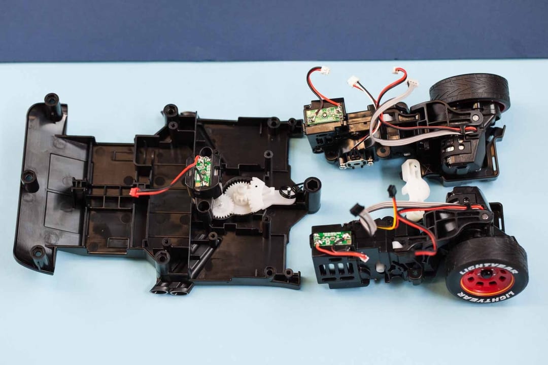

As part of these initial subsystem prototypes, the Sphero team faced a challenge with the very small, complex gear teeth — part of Lightning McQueen’s driving and suspension gear boxes.
Smooth, emotive suspension and high performance driving characteristics were considered two of the highest priority subsystems for bringing this product to life; to give the robot smooth motion that could truly recreate the animator’s intent was absolutely critical. So prototyping these subsystems received many man-months of attention.
“We were having non-stop issues with gear teeth breaking and not coming in smooth,” said Webster. “We were developing these really tiny 0.3 mm gears in both the suspension and drive gear boxes to save space and with our internal 3D printers it just wasn’t going well.”
At this point, the team turned to Fictiv to expand their prototyping capabilities.
“We were looking for a partner that could help us expand our material choices, and that’s where Fictiv stepped in,” said Webster
“We were prototyping so fast so if we waited even two weeks for parts, the design would’ve changed. Fictiv was able to provide rapid turnaround.”
ABS-Like Material for Strong, Low-Friction Parts
Sphero chose Fictiv’s ABS-Like material for its increased strength and smooth surface to reduce gear friction.
“Our goal was to tune the motors and get resistances close to that of the future injection molded production gears, so we could dial in the power requirements,” said Webster. “Without low-friction, well-built gear teeth we couldn’t accurately estimate how much current the motors were going to draw, which was a necessary datapoint for the battery selection and for modelling drive train losses.”
“Getting high-quality gears allowed us to transition from prototype-style design to something much more production-oriented, so we could prove out our ideas quickly,” said Webster. “We were prototyping so fast so if we waited even two weeks for parts, the design would’ve changed. Fictiv was able to provide rapid turnaround.”
