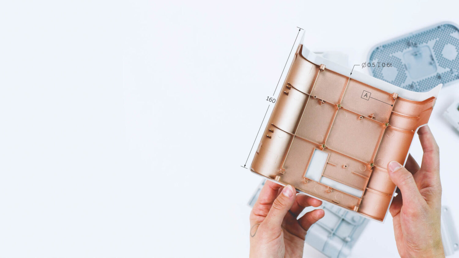

Injection Molding Part Design Features
Recessed undercuts
The Lampix parts required use of lifters and sliders to manufacture recessed undercuts in the parts, which increases the tooling complexity.
Flame-retardant material
Fictiv was able to help the team select a UL-94-rated, flame-retardant, premium ABS material appropriate for the design requirements.
![](https://www.fictiv.com/wp-content/uploads/2019/04/Lampix-Customer-Story_edited-photos-8094.jpg)
Heat staked inserts
To streamline manufacturing, Fictiv works with manufacturers that can perform injection molding and post-processing services in the same facility. These parts included heat staked inserts.
![](https://www.fictiv.com/wp-content/uploads/2019/04/Lampix-Customer-Story_edited-photos-8066.jpg)
EMI coating
Two of the Lampix parts required a special electromagnetic interference (EMI) coating. Fictiv was able to source a factory with experience working with this type of special coating, which helped the Lampix team pass the EMI certification.
![](https://www.fictiv.com/wp-content/uploads/2019/04/Lampix-Customer-Story_edited-photos-8086.jpg)
