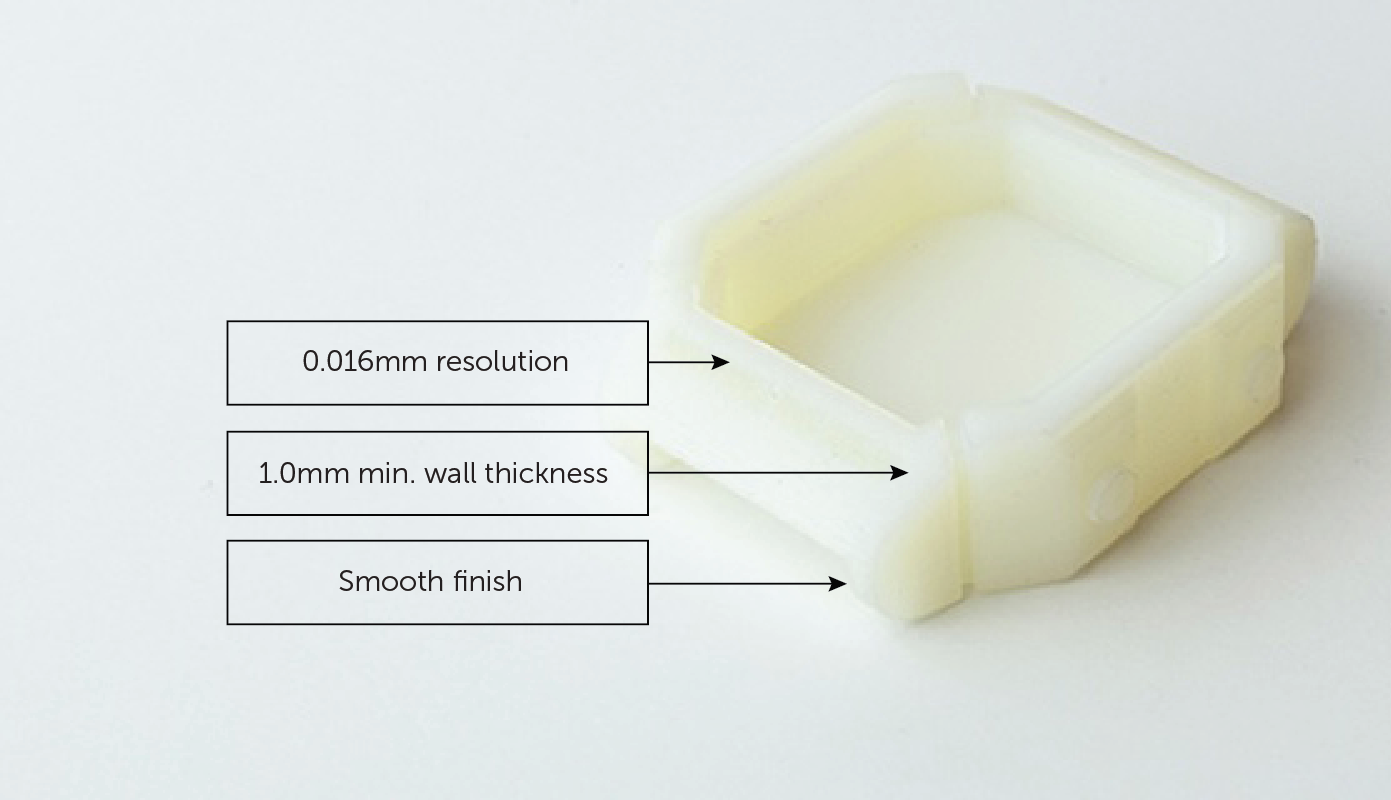

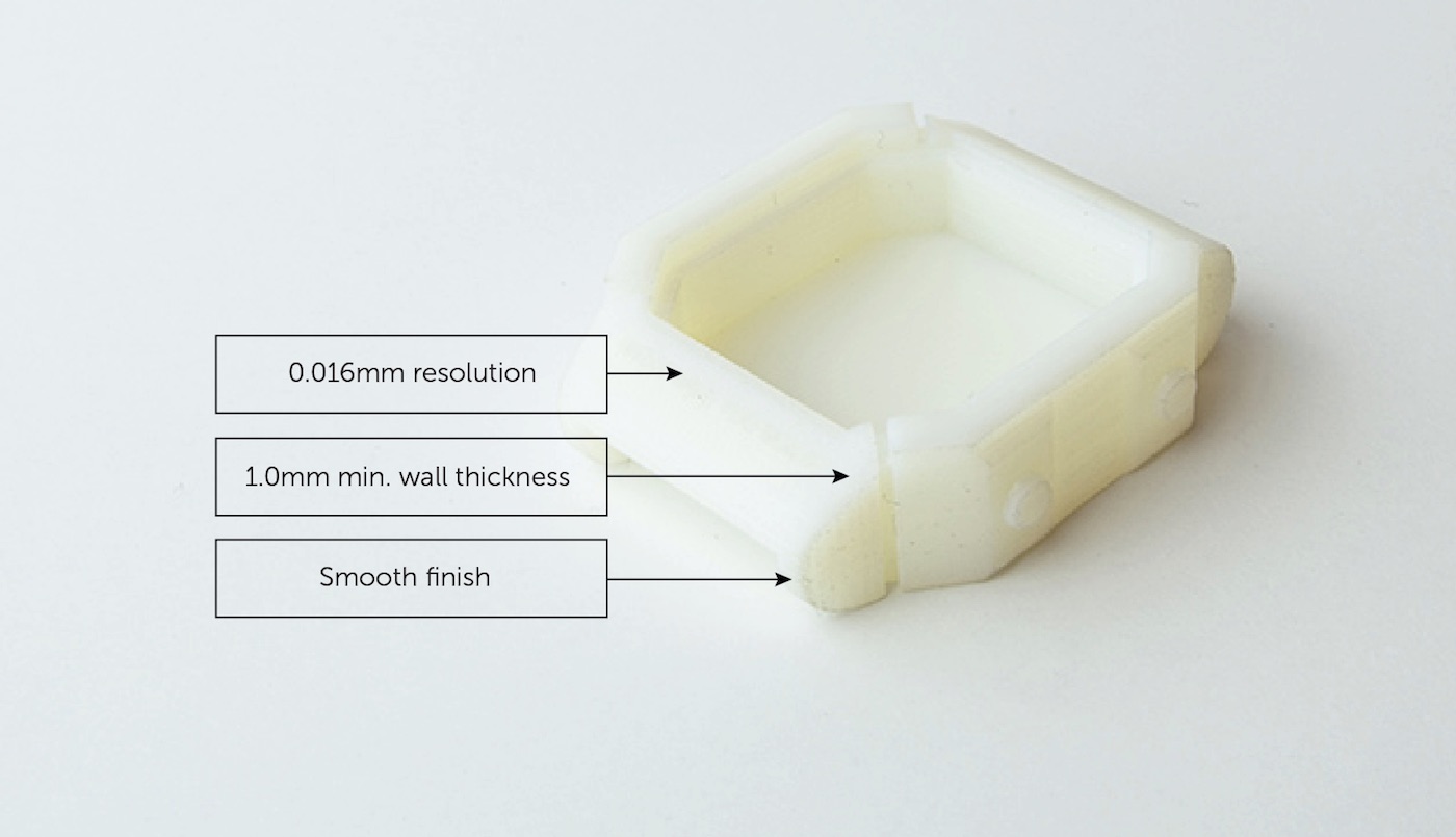

Design Recommendations
Max Part Size [x, y, z]
490 x 390 x 200 mm
Min Part Size [x, y, z]
5 x 5 x 5 mm
Tolerance
+/- 0.2 mm
Min Part Wall Thickness
1.0 mm
  • Gaps for mating parts: 0.1mm off of each wall.
  • Avoid sharp corners.
  • Avoid enclosed designs. To remove support material from PolyJet parts, the machinist must have line-of-sight access to all areas that require cleaning.
  • Ribbing helps avoid warping on long, flat parts.
