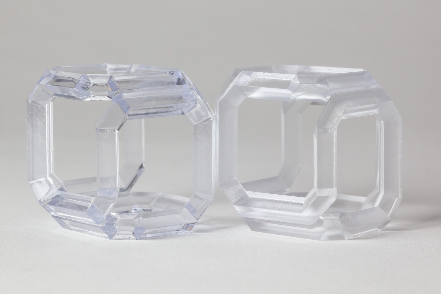

Accura ClearVue is a transparent photopolymer resin used primarily in Stereolithography (SLA) 3D printing technology. Its main feature is its high optical clarity, making it suitable for applications where transparent or translucent parts are required. Here are some common applications for Accura ClearVue in 3D printing:

Accura ClearVue’s exceptional optical properties, including high clarity and transparency, make it a valuable material for applications where visual appearance and light transmission are critical. Post-processing steps, such as polishing or coating, may be necessary to achieve the desired optical finish.
without clear coat post-process, printed part may have frosted appearance

Accura ClearVue has a semi-glossy texture. It is translucent and colorless. Accura ClearVue can also be post-processed with a Clear Coat finish. Parts with this coating applied are basically transparent with a glossier texture.
