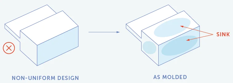

- Sink Marks: Sink marks can have multiple causes, but the most common one is a wall that’s too thick. Because resin cools from the outside, the material in the interior will remain fully molten even after the outer surfaces have solidified. As the core slowly cools, it contracts and pulls the outer faces inward, creating indentations. The effect is particularly apparent on flat surfaces. In most cases, thinner walls supported by ribs are better than thicker walls. Ribs won’t precipitate sink marks and the structure uses less material, too. Below is an example of sink-mark defects:

- Warping: Injection-molded parts will warp if their internal stresses are not balanced. These imbalances can be caused by non-uniform wall thicknesses. For example, when a thin wall section is abruptly followed by a significantly thicker section, the two will cool at different rates. The thicker section will cool more slowly than the thinner section, induce unequal shrinkage, and deform the structure. Below is an example of a warping defect:
