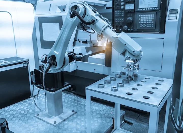

Machine Tending Robot
What is Machine Tending?
Machine tending, in the context of CNC operations, often refers to the process of loading raw material into and unloading completed parts from a CNC machine. Ordinarily, these actions are performed by the human operator, but that means the employee needs to be present for the entire production cycle. This can be expensive, time-consuming, and tedious for operators.
When it comes to large-quantity production runs, cycle time becomes critical since any wasted time is compounded by starting and stopping production at shift end, for example, which is reduced because the CNC machine tending robots don’t switch shifts or have to stop for breaks. This wasted time can mean the difference between meeting or missing an important deadline while also increasing the cost per part — which is why machine-tending CNC robots are so effective at improving overall productivity and profitability.

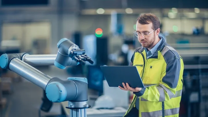

Robot Arm
The robot arm is the core of any machine-tending automation system. Robot arms can either be collaborative (cobot) or traditional. Traditional robots can be hazardous to humans in their operational space, so safeguards must be constructed around them.
Collaborative CNC-tending robots, on the other hand, don’t need to be enclosed behind safety barriers and can operate near humans with minimal risk. They’re designed to sense any human presence and stop if there is a collision risk. They’re also programmed using visual scripting, which makes them significantly easier to set up when compared to traditional robot-arm systems. Some key considerations when selecting a robot arm are:
  1. The required payload capacity
  2. The reach of the arm
  3. Ability to precisely repeat placement actions
  4. The degrees of freedom available on the robot arm
Collaborative Robot

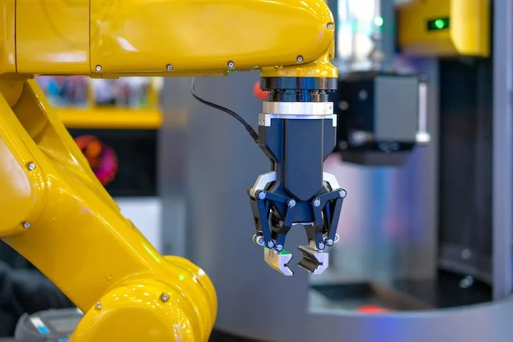

Gripper
The gripper, or end-effector, is used to grip onto the raw material and finished part. Different gripper designs are available, and your choice should account for current and potential future part geometries. Key considerations when selecting a gripper are: the stroke of the gripper fingers, the grip force, and how many gripper mechanisms are available.
Multi-gripper setups significantly reduce cycle time, as the CNC robot can pick up raw material in one gripper, open the machine, remove any previously finished part with the other, and place more raw material into the machine. This allows the arm to perform both the unload and load operations in one motion.
Gripper
Figure 3: Robot Gripper
