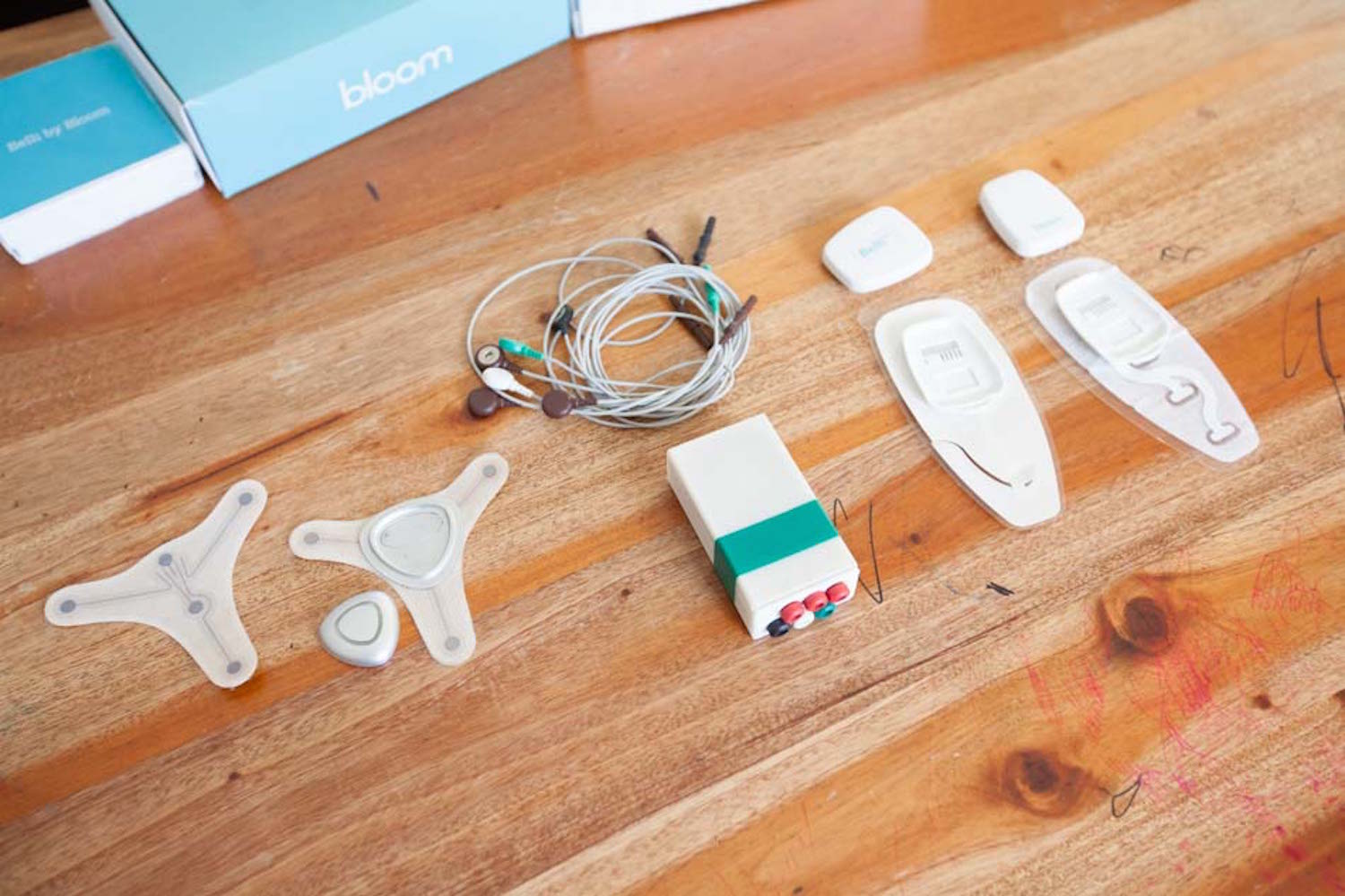

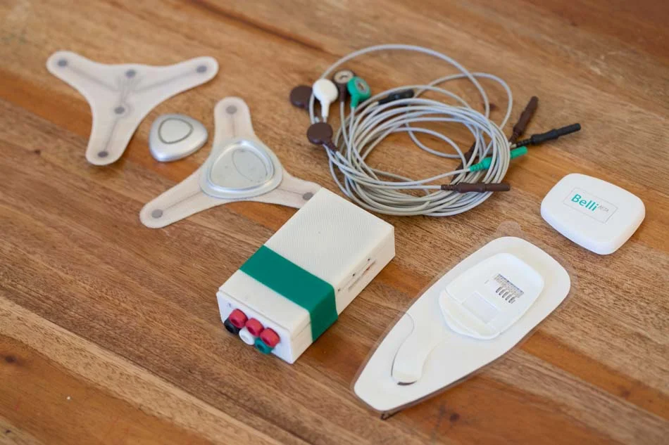

“We did a lot of rapid prototyping. Some [designs] were a little silly, like integrating the device into belly bands that expecting moms often use when their pants can no longer fit, and then there was a pillow you’d hold against your belly with the sensor inside. The thing is, the signals we were measuring had much smaller amplitude than those produced by the heart, so we needed something that would stay put and secure. Too much movement would introduce a lot of noise into the data. We settled on the [belly] patch.”
There were certain design constraints, especially in terms of size and shape. The team was always trying to make the device a little smaller. Eric nods: “There’s always a trade-off between engineering costs and the form factor; the smaller the device the more complex its internal architecture.”
Overall, “we over-engineered it, then scaled it back,” says Eric, clarifying that was intentional, and helped them think through the product roadmap. “We knew we had to have an accelerometer, for example. But we didn’t put in a bio-impedance chip [this injects an electric current with a specific frequency, to measure relative fat content] as that would have been too much.

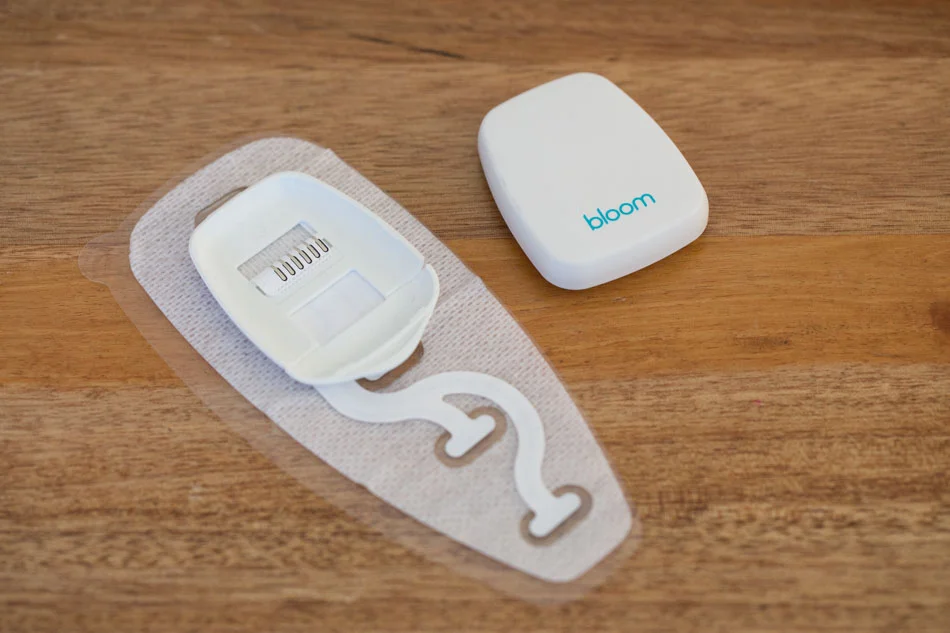

Belli is composed of two parts: a reusable sensor that houses all of the electronics, and a disposable patch that attaches to the body and into which the sensor snaps. “We thought initially,” shares Eric, “that we’d sell the sensor and patch separately, kind of like a printer and printer cartridge. But when we started shipping the beta units—we only had 12—we realized we would effectively lose those units since we were doing a paid beta. So we decided to rent them, which would enable us to get the units back.”
