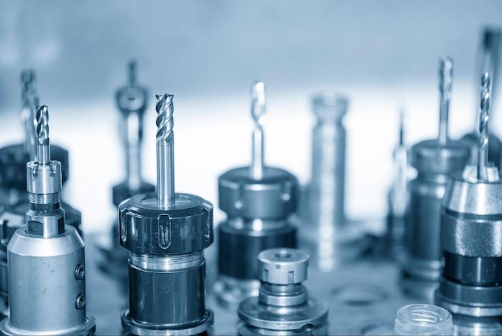

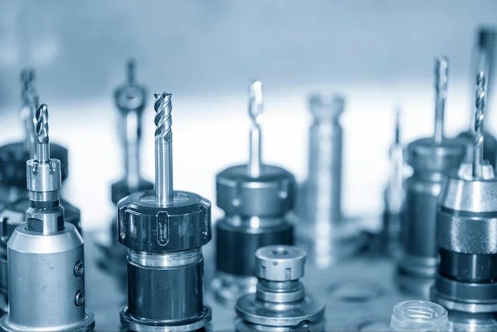

Milling machine tool
Figure 1. Milling machine tool
