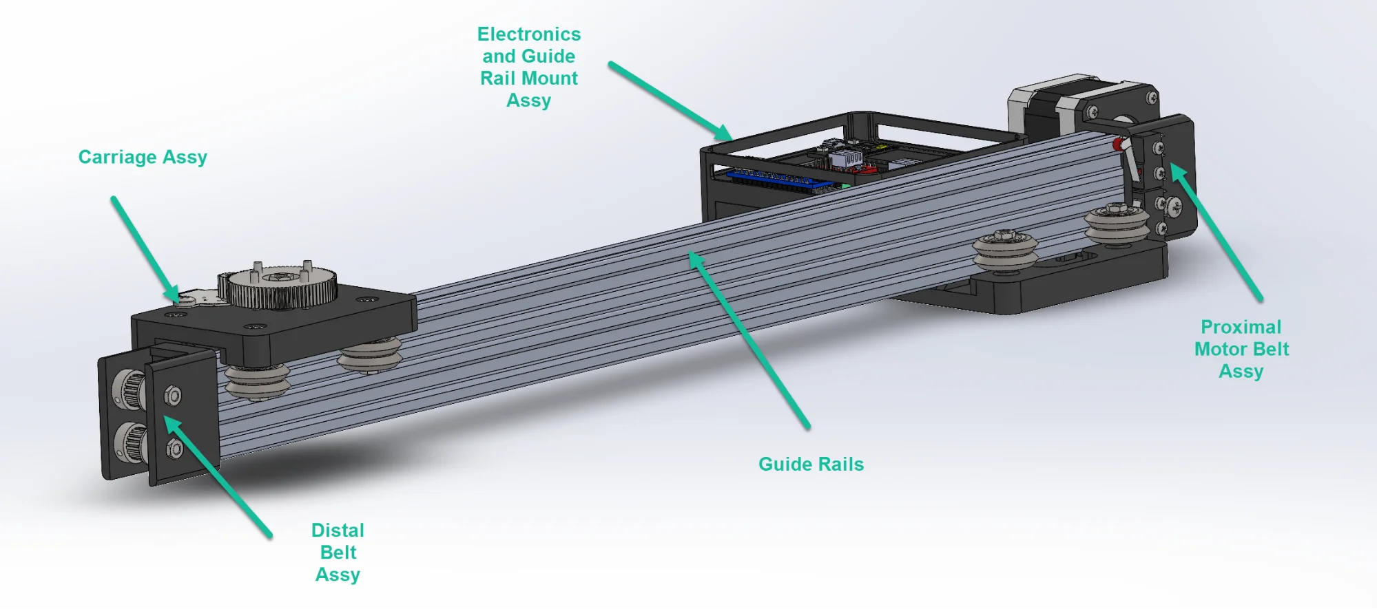

Break Down the Subsystems
The first thing I like to do with a big problem is to break it down into a series of smaller problems, or subsystems. How do you do this? Sometimes there is a super logical method and some days you just pick something and start. Today, we be doin’ it live folks (Lee-Roy Jenkins!) so let’s just jump in.
In the figure below you can see the subsystems for this linear rail:
Figure 2: Subsystem Break down

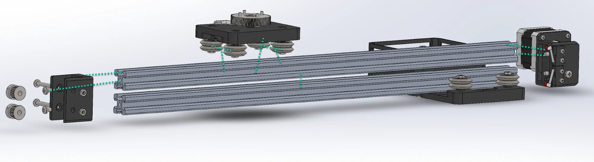

Continuing with the example, let’s take the top rail to start (cleverly named, I know).
Figure 3: Interactions Image of Top Rail

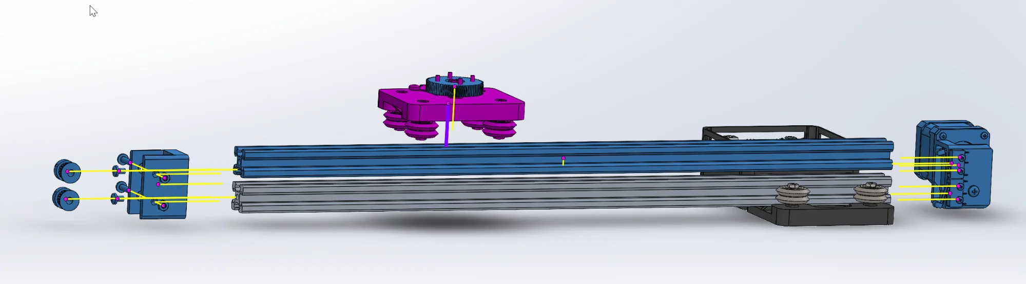

From this quick breakdown I see at least a few obvious interactions between the top rail and other parts.  You can also use the “exploded view” inside Solidworks. And once again, remember you are just trying to get an understanding of what’s going on with the assembly as a starting point.
Figure 4:  Exploded View interactions
Once you’ve set up a simple interaction image you want to lay out which interactions need a tolerance stack by looking at each interaction line. There’s a good chance that there is a tolerance stack in the interaction line. Another good reason to use this method is that it will also help you and your quality engineer from doing duplicate work on your DFMEA (Design Failure Modes Effects Analysis).
Let’s start by looking at the chassis (purple image) and the top rail. If you are doing a tolerance stack, you are attempting to mitigate a risk so take credit for it! Risks are mitigated via a hand calculation, a simulation, or a test (sometimes all three of these, depending on risk).

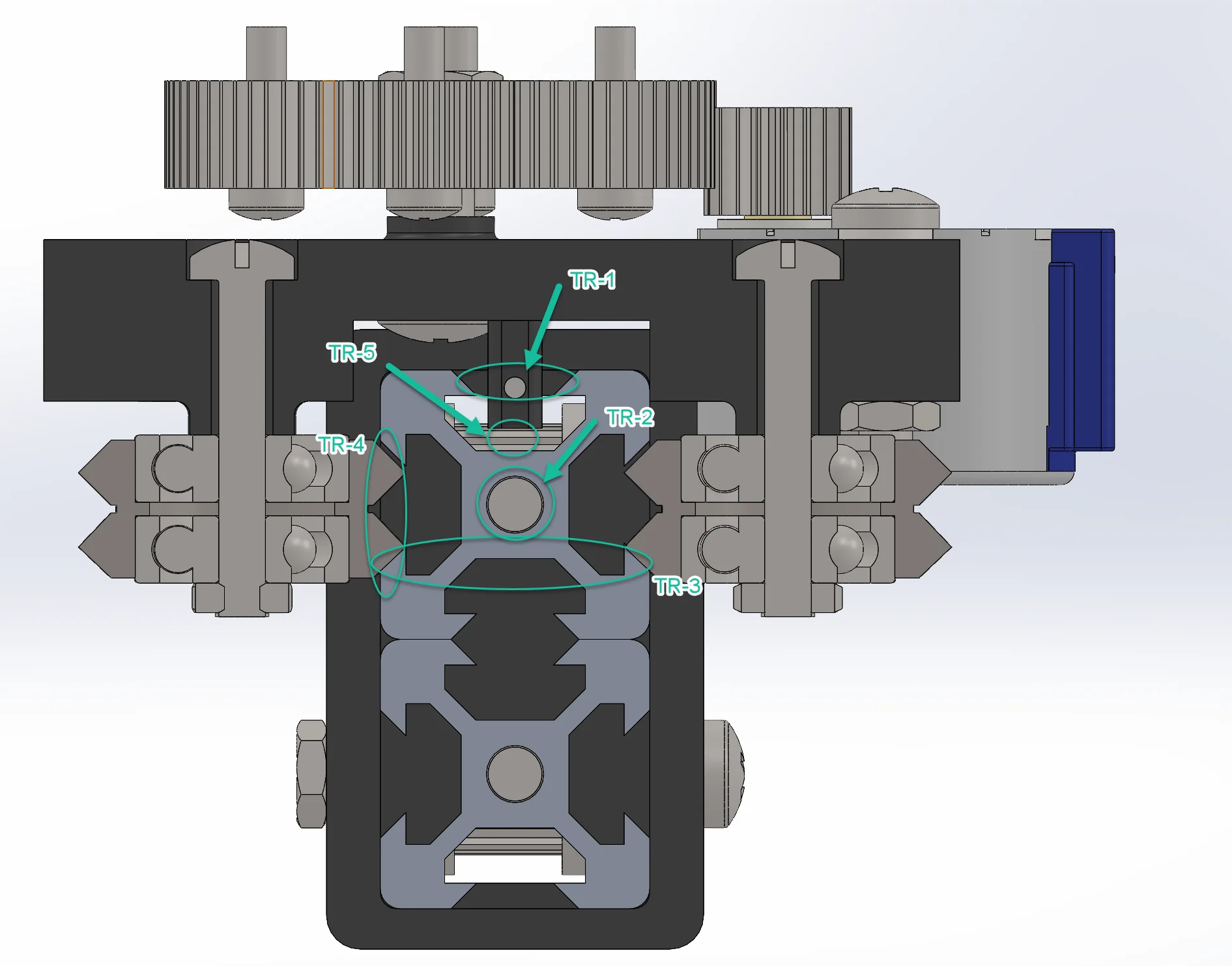

Below I take a cross section for an area of focus and start thinking about what could potentially go wrong or where there are deeper interactions.
Figure 5: Cross section
Figure 6: GIF of Cross-section plane

Next, create a table as the basis of each tolerance stack “score card.” This will ultimately be a big list of tolerance stacks that could result in some type of risk relative to the design—either function or simple assembly.
NameDescriptionFailure(s)Cpk
TR-1Top rail groove width to chassis base guide fin widthFin width too wide — could not fit in TR Groove; causes grinding on rail to chassis base;fin too narrow – n/a2 part fit
TR-2Top rail center thread to screwScrew won’t fit or wont thread2 part fit
TR-3Top rail wheel bevel surface width to chassis bevel wheel spacingToo narrow — chassis can fall off track;Too wide — chassis won’t move or won’t move smoothlyTBD
TR-4Top rail wheel bevel surface width to chassis bevel wheel heightToo narrow — chassis won’t move or won’t move smoothly;Too wide — chassis will sit lower than expected (could cause collisions or fall off track)TBD
TR-5Top rail inner center beam surface to bottom of chassis fin clearanceFin too tall — chassis won’t move or won’t move smoothly;Fin too short — n/aTBD
Table 1: Tolerance Stack Score Card

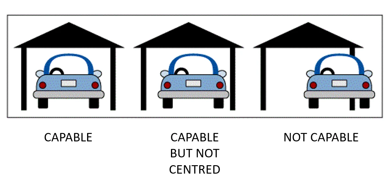

In this example, the garage defines the specification limits and the car defines the output of the process. If the car is only a little bit smaller than the garage, you had better park it right in the middle of the garage (center of the specification) if you want to get all of the car in the garage.
If the car is wider than the garage, it does not matter if you have it centered; it will not fit (Cpk lower than 1).
If the car is a lot smaller than the garage (Six Sigma process), it doesn’t matter if you park it exactly in the middle; it will fit and you have plenty of room on either side.
If you have a process that is in control and with little variation, you should be able to park the car easily within the garage and thus meet requirements.
Cpk tells you the relationship between the size of the car, the size of the garage and how far away from the middle of the garage you parked the car. The value itself can be thought of as the amount the process (car) can widen before hitting the nearest spec limit (garage door edge).
  • Cpk = 1/2 means you’ve crunched nearest the door edge and those mirrors are gone (ouch!)
  • Cpk = 1 means you’re just touching the nearest edge (the mirror)
  • Cpk = 2 means your width can grow 2 times before touching
  • Cpk = 3 means your width can grow 3 times before touching

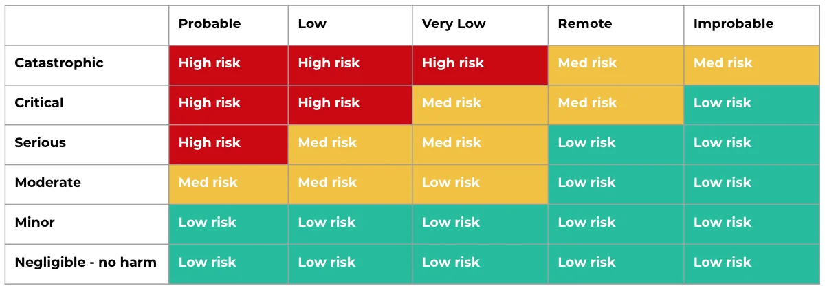

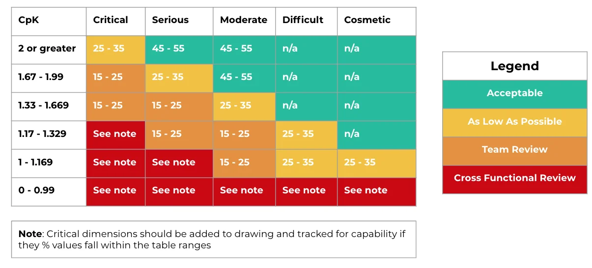

Relating Risk Zones to Desirable Cpk Results
My next two tables relate “risk zones” to your desirable Cpk results.
Table 2: Risk Zone Chart
Table 3: Cpk to Risk Severity Chart
Looking at these two charts, you can see how Cpk relates to the probability of a risk happening!
(okay, pause here to look at the charts, reread portions, let it sink in…)
If you understand this, pat yourself on the back—you just leveled up!

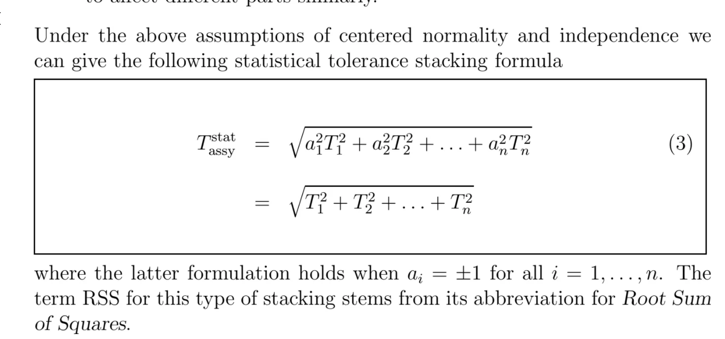

In the example, we’re going to talk about RSS (Root Sum Squared) tolerance stacks, because pretty much every engineer has access to a spreadsheet.
Before we start a couple quick things to keep in mind for RSS stacks:
  • RSS formulas most likely use alpha = 1 (this can change; see article)
  • Normality is assumed  (you need to check this ultimately, because garbage in = garbage out)
  • You need at least 3 dimensions or more. RSS does not work for two part fits. (If you must know why, read this paper from University of Washington professor Fritz Scholz and do some math)
Figure 9: RSS calc formula; from Tolerance Stack Analysis Methods by Frtiz Scholz

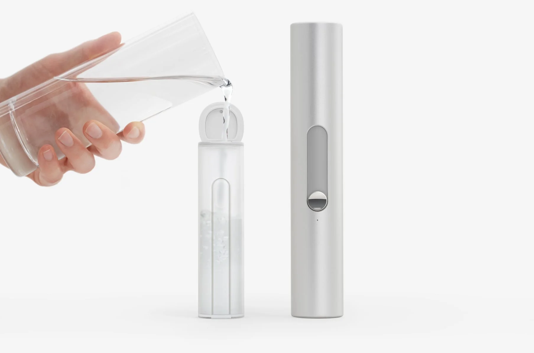

My friend Zach from Sonny has allowed me to share some images from his product that’s moving along in development (check out his indiegogo here).
Sonny Portable Bidet

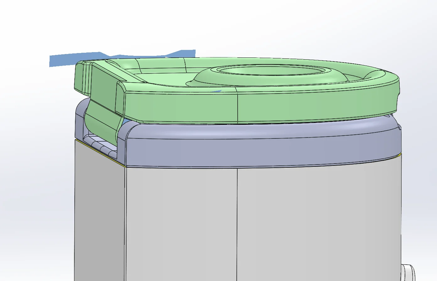

The product has been having difficulty sliding a fluid canister into the device. See GIF and zoomed in image of cap below.
Figure 10: Sliding action of canister into housing (left)
Figure 11: Canister (grey), collar (dark gray), lid (green)
Step one here is to do a tolerance stack as a root cause; the phenomena has been seen that the canister jams/gets stuck or is hard to translate.
So I have an engineering issue that has an occurrence rate of “probable” (as it’s been seen in the first 10 devices) and if this failure were to occur in a sold product or on the production line it makes the device useless. So from a product perspective this is “serious.”
So moving to the Cpk chart (table 2), I go over to the “serious” column. Looking at the different colors, I want to be in the green zone “Acceptable” or yellow zone “As Low as Possible”. If you can’t get into these zones it likely means either a design change or some type of inprocess step handed to the manufacturing team to mitigate/control the risk is needed. That’s why anything in the orange or red zones requires an internal team/managerial review or a cross functional team review to keep everyone informed and find a solution.

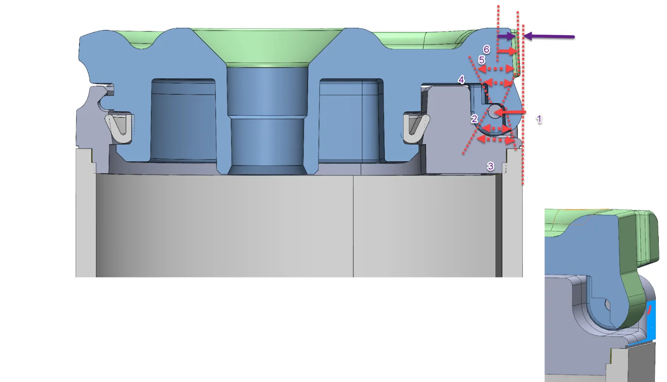

  • To fully control risk, I should do a calculation and/or a test with the design as-is, to prove progress forward (or do design change to eliminate the issue; sometimes it’s easier to know my tolerance stack from a “calc” perspective is finished if I can get a 1.33 CpK or better).
  • I take a cross section of the canister and show that I don’t want the “green” cap to be able to stick out beyond the sliding surface of the main canister body (shown with my purple arrows).
  • I complete the loop by doing the tolerance stack method.
You can download our free tolerance stack calculation workbook here as a template to perform your own tolerance stacks.
Figure 13: Cross section of canister assembly
Figure 14: Tolerance stack loop
Figure 15: Tolerance stack results

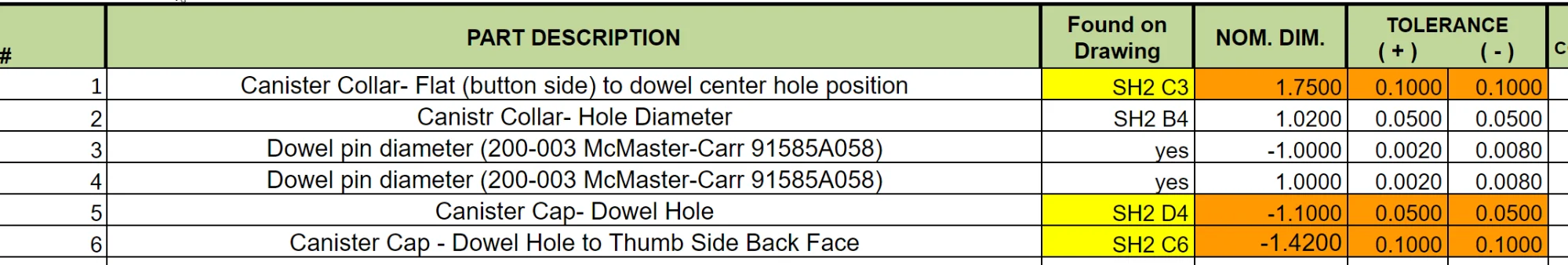

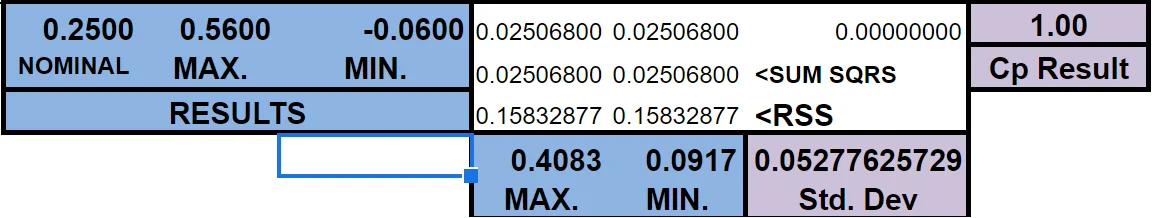

When you do the loops you create your image and you need to remember that you have to pick a direction (in my case for this one, to the left is positive); things that are interference are negative.
In this example, I was taking measures from drawings already created (or CAD if not present) and using the tolerance stacks to review if the drawings had all the applicable information. “Orange“ cells in the table were for me to remember that they weren’t on the drawing—meaning the risk is not being managed. The way to manage the risk would be to add to the drawing. Then the risk is being attempted to be controlled.
In this design you also need to set limits for your Cpk analysis. What’s important to understand when setting the limits is that it is very specific to the direct problem you are trying to solve or the condition you have identified with your arrows. You are looking for a gap and the gap needs to be greater than 0, such that if it were negative the cap would not drag the canister body.
So theoretically if the part was gone, the gap would be infinity but it wouldn’t drag so this is a theoretical solution to the problem. But for this I could have said my USL (upper spec limit) is 5, 1—it doesn’t truly matter as long as it’s greater than 0. So my lower spec limit (LSL) is, well, 0.
Figure 16: Cpk Results
From the results we can see that the lower spec limit is being calculated at 1.58. This isn’t quite what I need to retire the risk.
At this point you might be wondering what the numbers inside the chart mean. These are ‘influencers’ and if you were doing a CETOL or vis-vsa analysis, those 3D tolerance stack softwares will tell you by % which dimensions are driving your result. If you use these tools and see something in the box that is equal or greater than 30% in our example, that’s an immediate critical dimension! Once again, your goal is to try to eliminate this issue with engineering drawing controls or a design change.
Here’s the Cpk to Risk Severity chart again for reference:

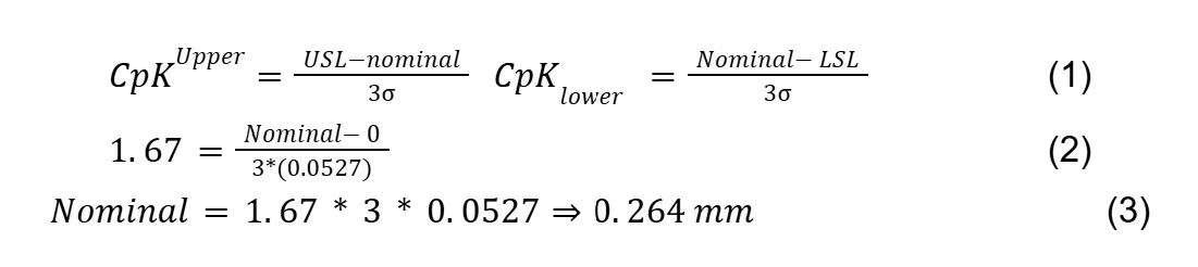

Now that I’ve finagled and messed with my tolerances, I can see I’m not quite getting the desired result. So how do I figure out what I need to do? I back calculate my equation to determine what I need:
Figure 17: Cpk equations (As Low as Possible)
You now know what your nominal clearance needs to be to drive your design to be in the “As Low As Possible” zone. You could repeat this for Cpk of 2 (nominal = 0.3162mm) and if it doesn’t introduce another risk, do it. Eliminate it and avoid the ‘why’d you do that?’ shame bell look from your manufacturing team four months from now.
