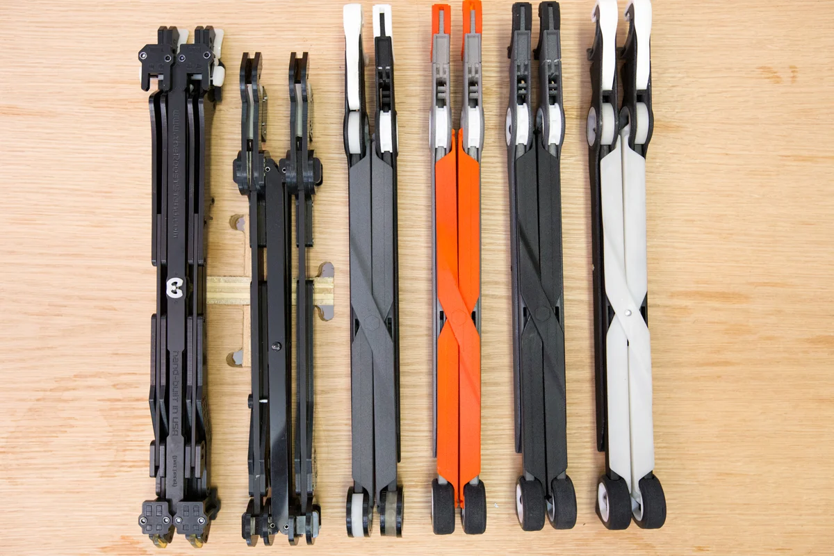

Now James is working on V2 of Roost. The biggest change in the development of the second version is the introduction of injection molds to increase production volume. With the first Roost stand, both the prototypes and production units were machined with laser cutters and the same materials, so there was no difference between the two; if the prototype broke, then the production unit would break.
With injection molding, it’s an entirely different process. You need to understand the structural elements of your prototype, done with different materials and tools and then through testing and analysis predict the structural features of your final injection molded part.
This is where James’ aerospace background goes to work. Using very intentional and detailed analysis, he’s able to assess the structural elements of his prototypes created with plastics, and then extrapolate those results to understand how an injection molded part will perform.

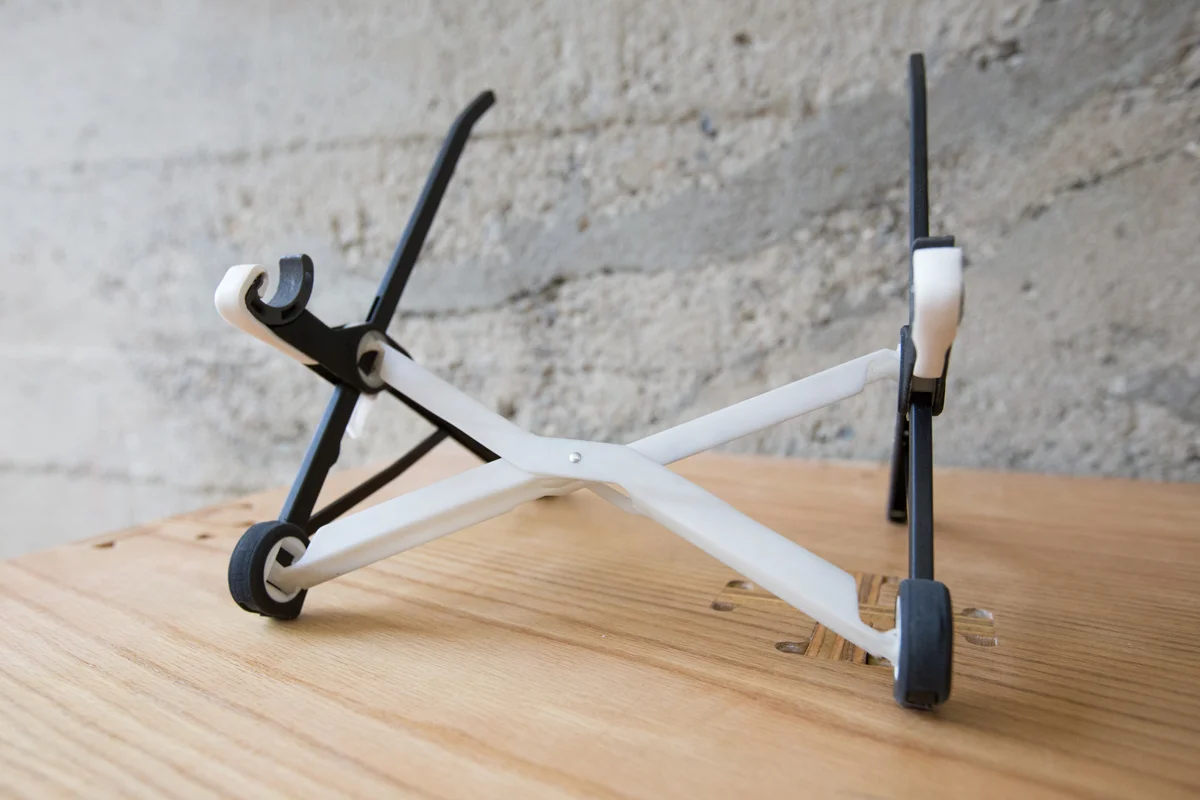

For Roost, the most critical design components are strength and stiffness. The Roost stand is designed to be extremely strong and stable, for a lifetime of heavy usage. So that’s where James placed his focus.

For the final production material, James is using glass-filled nylon, which replaces the carbon fiber used for the first Roost product and has very high stiffness. “Stiffness is really the most important component to optimize for since you don’t want your laptop to wobble at all on the stand,” James says. “So I chose a glass-filled material, which is used in car parts and will provide that critical stiffness.”

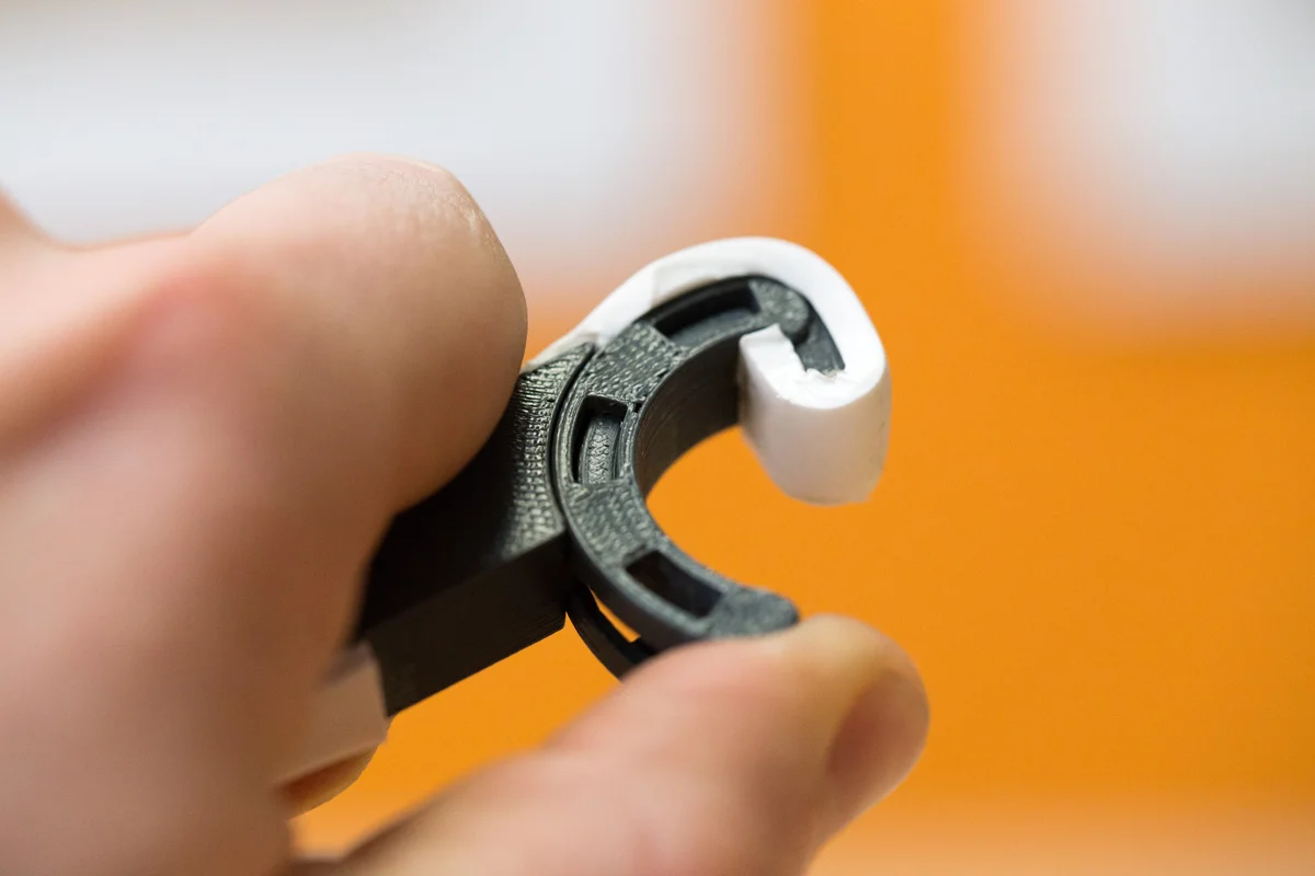

Of course glass-filled nylon is not the material James used to iterate with for all his prototypes. So the main challenge for James in finding the right material to work with for his prototypes was to find something that would compare in stiffness to the glass-filled material. “I finally found a 3D printing material called Bluestone that’s actually very brittle,” James shares. “It doesn’t have very high strength, but it does have very high stiffness. Since the stiffness compares with that of the injection molded material and it doesn’t break under an un-abusive load, then with production material of the same stiffness and four times the strength, the structure will work in final production.”

Another new material James uses in this second version of Roost is silicone on the pivoting grip mechanism that latches to the laptop. “Silicon is interesting because it’s an A and a B component where you mix it together and a chemical reaction happens such that the final shape is permanent,” James notes. “Plastic, on the other hand, is in a constant, albeit slow, state of deforming.”

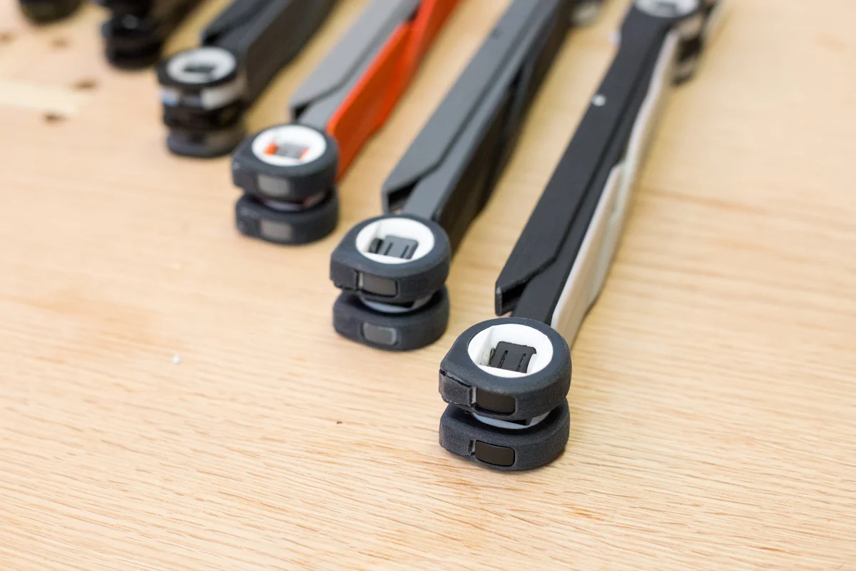

But translating that theoretical geometry into a real product is still another thing entirely. “Never assume you’re going to have it designed right on the computer, no way,” James emphasizes. “For a long time I was 3D printing different shapes out of different materials and judging, ‘well, if the injection molding material is going to be four times stronger but the same stiffness, and this one broke at 10 pounds that means it should hold up to about 40 pounds when molded.’ There were tons of these comparisons.”
So while it may seem clear on paper how to optimize for stiffness and then compare the relative strength of a 3D printed material versus an injection molded one, there was a lot of testing involved in James’ process. He tested multiple materials with different properties and price points under different amounts of weight to understand with confidence which material was best.
Then to bolster his predicted analysis of the final production parts, James plans to use a statistical analysis of fits on the first 25 injection molded units to validate the tolerances. “I’ll build a few parts with tolerances above and beyond what you would usually want for an injection mold because you get shrinkage,” James say. This will help to understand, for example, the tolerances needed for one of the components which is a perfect circle. “Perfect circles are not a good idea in injection molds, but it can be done,” James adds. “You just have to spend a lot of time tweaking the tool.”
