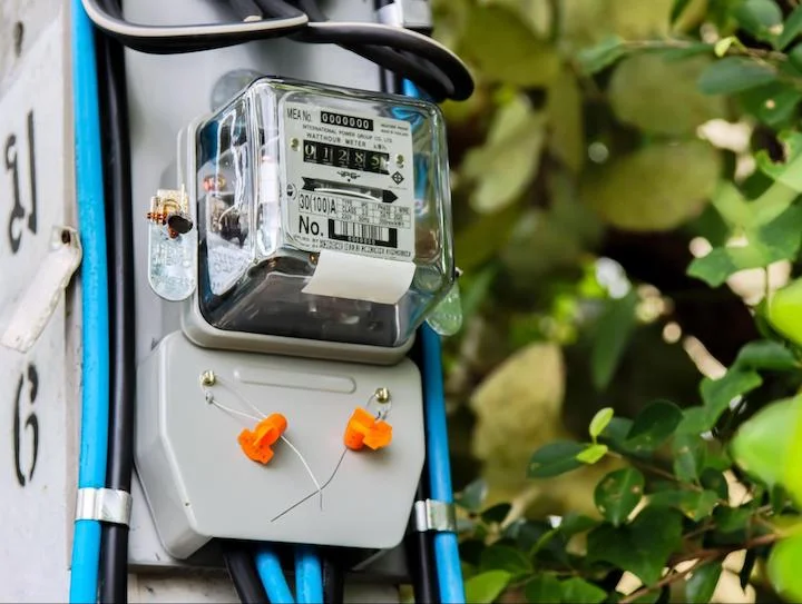

 ASA plastic
ASA plastic is a good choice for transparent housings for outdoor electrical meters.
Acrylonitrile Styrene Acrylate (ASA)
ASA plastic is tough, strong, and resistant to impact, wear, and ultraviolet radiation. It also withstands weathering, heat, and weak acids and alkalis. ASA parts have glossy surfaces and retain their color, gloss, and mechanical properties even when exposed to outdoor environments. It’s easy to smooth layer lines after 3D printing, and this UV-resistant plastic is available as a resin for injection molding and as extrusions or co-extrusions that can be CNC machined. ASA’s main downside is that it absorbs moisture over time.
Applications for UV-resistant ASA include electrical housings, commercial siding, lawn furniture, sporting goods, and garden equipment. This UV-resistant plastic is also used in automotive applications ranging from exterior panels to side-view mirror housings. If you’re considering acrylonitrile butadiene styrene (ABS) plastic for your project, know that both ABS and ASA have similar mechanical properties — but without adding a UV stabilizer, ABS won’t resist ultraviolet degradation.

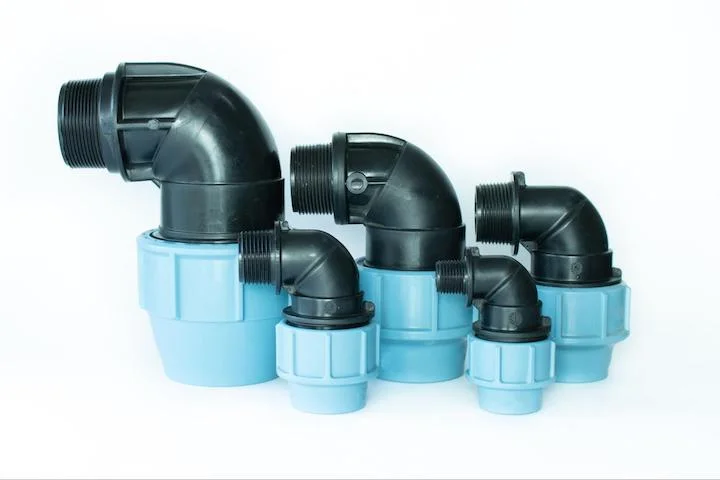

HDPE plastic
HDPE plastic won’t absorb water and is used in plumbing components for outdoor use.
High-Density Polyethylene (HDPE)
HDPE plastic combines UV stability with strong and broad resistance to rain, wind, snow, and extreme temperatures. Unlike ASA, this UV-resistant plastic does not absorb water or moisture, which helps to prevent swelling, warping, or weakening of the material over time. Among its many advantages, HDPE is flexible, lightweight, and easy to recycle. Along with its excellent chemical resistance, HPDE provides exceptional impact resistance and can withstand mechanical stresses without breaking or cracking.
Applications for UV-resistant HDPE include playground equipment, outdoor furniture, agricultural containers, and water storage tanks. HDPE is also a popular construction material for outdoor structures and is sometimes called plastic wood, a product that has the appearance of natural wood without the risk of deterioration. Not all HDPE is designed for structural applications, however, so designers may need to consider flexural strength and compression strength along with UV resistance.

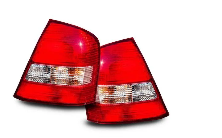

Polycarbonate
Polycarbonate housings protect automotive tail lights that use LEDs.
Polycarbonate (PC)
PC plastic provides greater impact resistance than HDPE and can withstand significant temperature changes. This UV-resistant material is also lightweight, easy to machine, electrically insulating, and fire-resistant. Although polycarbonate has a strength that’s 250 times greater than that of glass, PC is prone to scratching and is also more expensive than other UV-resistant materials. So, during material selection, part designers must balance polycarbonate’s UV stability against other considerations.
Applications for polycarbonate include outdoor signs and lighting systems. Special LED-diffusing grades of PC are designed to diffuse light from lamps that contain light-emitting diodes (LEDs). Structural applications for PC plastics include sunporches, carports, and other outdoor structures. With their excellent electrical insulation and ability to meet flammability requirements, polycarbonate materials are also used in electrical and electronic products, like outdoor switchgear in substations.

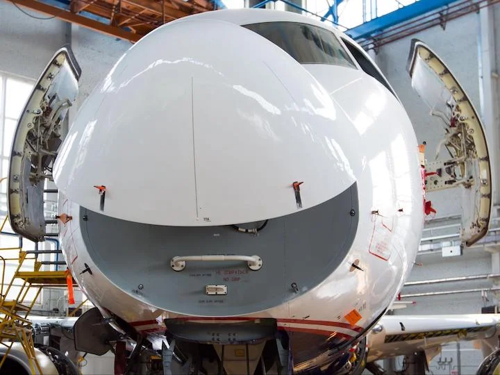

PAI plastic
PAI plastic is used in airplane radomes, which are subject to ultraviolet radiation.
Polyamide-imide (PAI)
UV-resistant PAI combines UV stability with exceptional resistance to creep and wear. This high-performance plastic also has high levels of tensile strength and compressive strength for mechanical loading. Although PAI absorbs water and is mechanically rigid, it exhibits low thermal expansion and high thermal stability for dimensionally-stable components. PAI is used in 3D printing and has good machinability, but is relatively expensive and can be challenging to injection mold.
Applications for UV-resistant PAI include aerospace and automotive components and systems, electrical and electronic devices, and the green energy industry. In aerospace, PAI is used in fins, wings, antenna mounts, and radomes. Electrical and electronic applications include cables and connectors. In the green energy industry, PAI is used in large-scale battery power storage units that capture energy from wind or solar power for on-demand distribution.

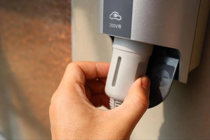

PVDF
Fire-resistant PVDF has applications in EV charging.
Polyvinyl Fluoride (PVDF)
PVDF is a high-purity plastic with excellent chemical resistance, flame resistance, and UV stability. There are two main types of PVDF plastics: homopolymer and copolymer. Homopolymer PVDF has greater stiffness and a higher heat deflection temperature than copolymer PVDF, which offers superior impact strength and stress crack resistance. Both types of material provide excellent thermal stability and have high fatigue resistance during cyclic loading.
Applications for UV-resistant PVDF include coatings for solar panels and outdoor building surfaces such as metal roofs, facades, and curtain walls. PVDF is also used in waterproof membranes, protective films, and outdoor electrical components for EV charging systems. Industries that use 3D printed, CNC machined, or injection molded PVDF include aerospace, automotive, sporting goods, petrochemical processing, and semiconductor equipment.
