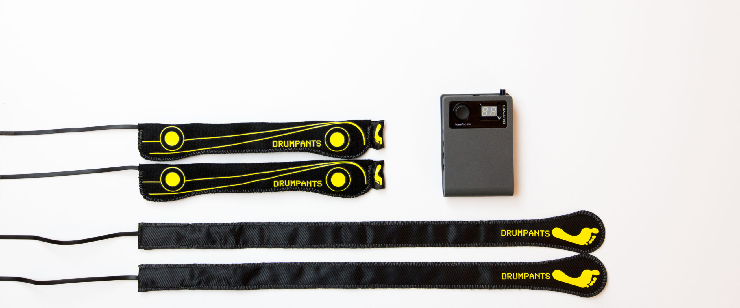

In this week’s Hardware Spotlight, we had the chance to sit down with Tyler and Lei, co-founders at DrumPants. They founded the company with the vision to pioneer a more natural way for humans to interact with their devices from their bodies. We chatted about their first prototype, development challenges, and advice for bringing a product to market.

Tyler: For the very first prototype I took a giant yamaha midi keyboard and wired up my pants directly into the circuits where the keys should go. Then I took all the guts out and put it in a plastic case which I then put into a backpack that I carried around. I also had these gloves with wires in them so when you hit the pants it completed the circuit.
Lei: (laughing) When I first met Tyler he was like, “here it is!” and it was literally sensors duct taped to his jeans. So we started with sketches and really thought about how the product would be used. For example, the case we have now is grey but the original design was white. The reason we chose to make it a dark color is because when you’re on stage you don’t want a bright object that could be seen by the audience. We then used very low fidelity mockups using foam board and glued the pieces together to figure out the thickness of the case and get a feel for the product by putting it in our pockets. We wanted to test everything.

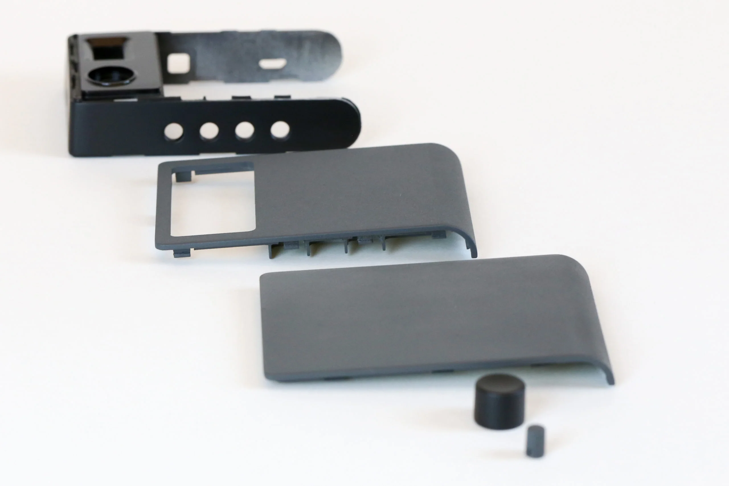

Tyler: First we used a PIC controller and then moved to Arduino once it came out. Then we brought an electrical engineer to the team who created the first custom board and built the first iteration of the housing. After our Kickstarter funding we also hired an industrial designer and a wearables developer. Then we did a series of 3D prints. Really shitty, cheap 3D prints — nothing like Fictiv.
When we said what we needed, Fictiv knew exactly which machines and which types of plastics to use.
What was the difference between Fictiv and the first 3D printers you worked with?
Lei: When we said what we needed, Fictiv knew exactly which machines and which types of plastics to use. And on top of that there is a huge world of difference in quality between those first 3D prints and ones Fictiv did. When people see this (holding up the first prototype casing) and you tell them it’s a 3D print they are very forgiving of it because they think the final one is going to be way better and that all the little issues are going to go away. It’s not real to people. But a Fictiv printed case actually feels like the real thing. It’s so tangible.

Lei: We had to play around with different shapes to figure out which ones would be comfortable to wear. When testing one of the first controller iterations people really liked it but said it was too long and stuck out of their pocket — a similar problem that the iPhone 6 is having right now. Also, we originally we wanted users to be able to open the case to change the batteries but then we decided that we really needed to get rid of any inefficiencies taking up space.
Hacker Note: Secrets await the curious engineer who hacks into the board. (Disclaimer: you might not be able to put the case back together again.) ((duct tape!))
