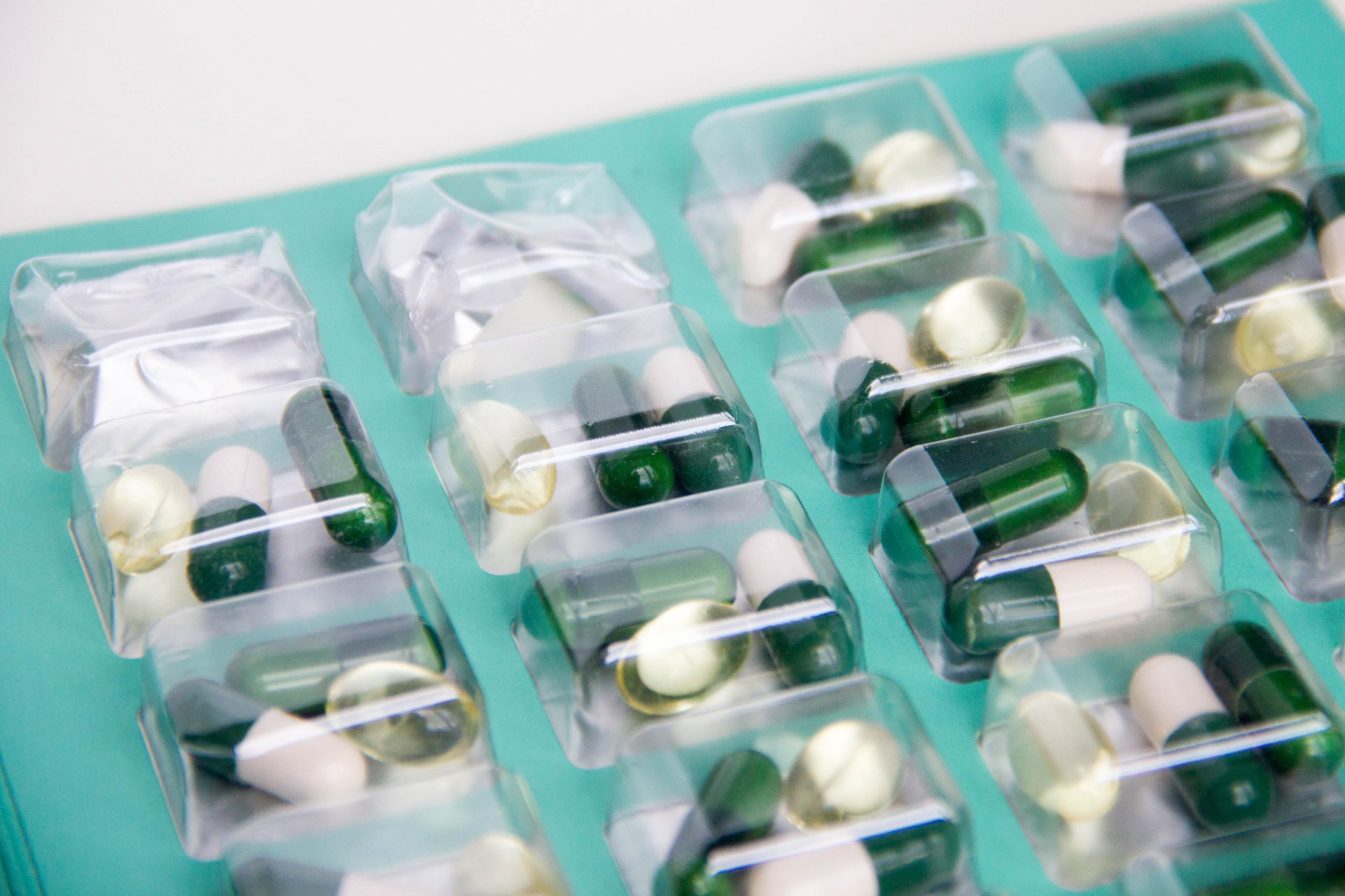

It also does well at making thin-gauge parts. Widely used in the packaging industry, thermoforming can easily create disposable cups, containers, lids, and trays cost effectively. Thin material also allows for more leeway with undercuts.
<img class=” size-full wp-image-1777″ src=”https://www.fictiv.com/wp-content/uploads/2019/10/simone-van-der-koelen-HtDQ9Z64Vpo-unsplash-scaled.jpg” alt=”thermoforming-packaging” width=”2560″ height=”1706″ data-align=”center” data-caption=”Figure 3: Blister packaging like this pill pack is a great example of a thermoformed part made from a stiff clear plastic like PET.” data-entity-type=”file” data-entity-uuid=”615b263b-fa0f-4634-924a-b87a52e0189f”>
