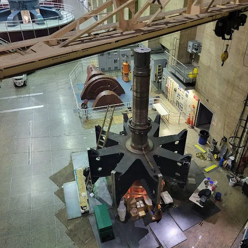

While different electric motors serve vastly different purposes, their core function remains the same—to convert electrical energy into mechanical energy. Motors are the opposite of generators, because they convert electrical energy into mechanical energy, while generators convert another form of energy into electricity (you can see a huge deconstructed generator undergoing maintenance at the Hoover Dam below).

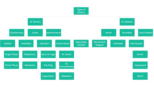

Many resources highlight the characteristics of each unique motor on the market, but motors can be simplified into two overarching categories: AC (alternating current) motors and DC (direct current) motors.

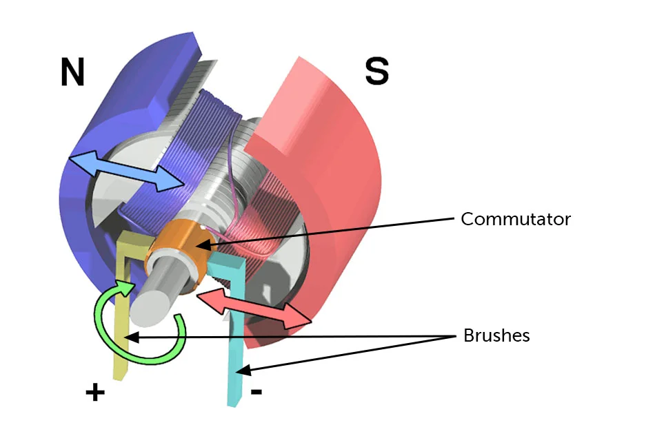

DC Motor Build
The job of a DC motor is to supply a stable and precise output, which makes its construction a little more complex. Returning to the battery example we used earlier, we want the battery to supply a consistent 1.5V to our circuit board, not switching from +1.5 to -1.5V hundreds of times a second that AC power gives us. In that same way, in order for a DC motor to convert the consistent voltage supplied to it, we need a motor construction that will precisely convert that voltage into mechanical energy.
To do so, we need some mechanical functionality to create a rotation that moves the motor. Again, this was easy with AC motors, because AC power naturally swings back and forth, which varies the magnetic field. With DC, the magnetic field will remain the same.
So to counter, we have several rotating coils at the center of a DC motor that connect to a “commutator.” The commutator makes contact with stationary “brushes” of opposite polarities at the exact moment that it needs to change the direction of current to rotate the shaft.
It may be obvious, but the major downside here is loss of efficiency, due to the friction caused by the contact between the commutator and brushes. The loss in efficiency leaves in the form of heat (and sometimes sparks) if you overload the motor.
