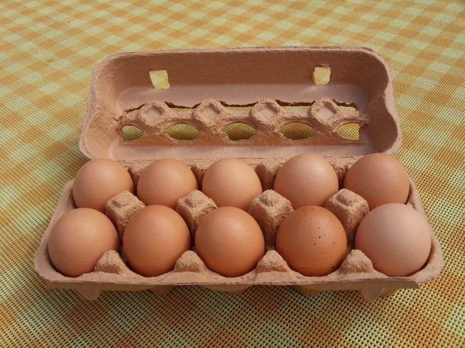

Ten years ago, most new electronics came supported in a made-to-order molded plastic cradle. These days, many companies are turning to molded pulp, an eco-friendly alternative that functions just as well but can be made with recycled paper. Though the dry-pressed pulp looks like an egg carton, the wet-pressed pulp looks great in high-end electronics designs and is easily dyed to adapt to even a colorful brand aesthetic.

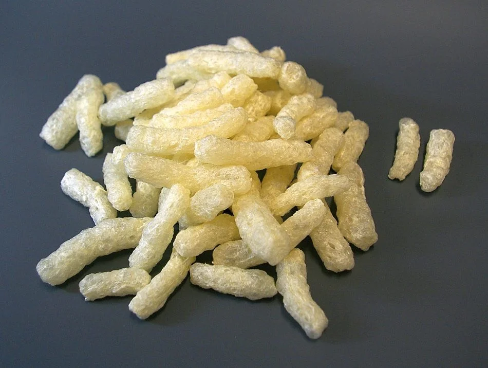

Another packaging pitfall we’ve been able to (mostly) say goodbye to is the use of foam peanuts. As much fun as they were to scatter throughout the house for your parents to clean up (I love you, Mom!), adding shock absorption for rough handling is another great application of recycled paper, this time shredded instead of pulped. It’s fluffy, it doesn’t stick to the cat, and it will protect your electronics nearly as well.
Of course, if you really need the shock absorption of foam, you should consider materials made from corn starch and other bioplastics, which are especially great when you consider the end of life (but I’m getting ahead of myself; read on!).

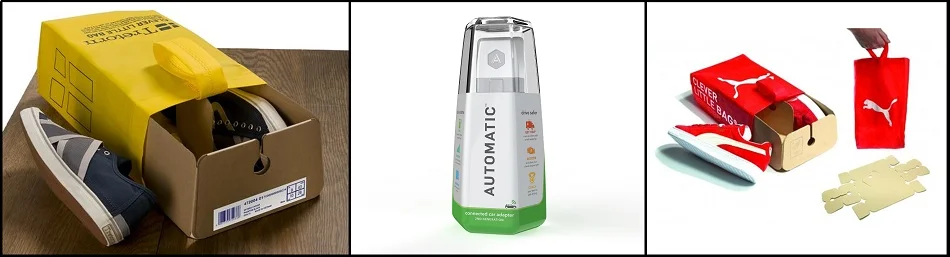

Sustainable packaging design is minimalist, which fortunately fits well with modern design philosophy, even outside the environmental movement. Consider ways of eliminating packaging components, as well as minimizing the use of materials within each component.
I know you want your earbuds to be prominently displayed, but is it really necessary to package them in a Dostoyevsky-novel sized box, when Sennhesiser is doing such a beautiful job with small, stamped cardboard boxes? And not all watches need bulletproof cases surrounding them; could your sports-related electronics brand be better represented with a playful cut-cardboard box?
Even top-tier electronics like computers can be packaged in a more sustainable way, in a form-fitting box that doubles as its shipping container, as demonstrated recently by the appropriately-named Litl webbook. One of the best things about slimming down the package itself is that this single change has a trickle-down effect on reducing the number of pallets required for shipping, which saves on the environmental cost of shipment, not to mention the company’s bottom line.
Thinking beyond delivering the product to the end user, can your packaging design be used in another application within the consumer’s home? I was thrilled when the bag that I was given to carry my laptop home from a Microsoft store was actually a large, reusable shopping bag—it’s the primary bag I use for my weekly shopping trips now. Besides my own glee at the bonus, Microsoft is getting free brand publicity every time I go shopping.
Microsoft isn’t the only one taking advantage of the continued lifespan of packages: A car-tracking adapter comes packaged in a bonus travel cup, and Motorola announced a soon-to-be-released design for the package on an upcoming phone that will double as a charging stand during the phone’s life, then can be used a shipping container (with the included prepaid envelope), once your phone is ready to be recycled. Speaking of recycling, what happens to your design when it’s served its purpose?

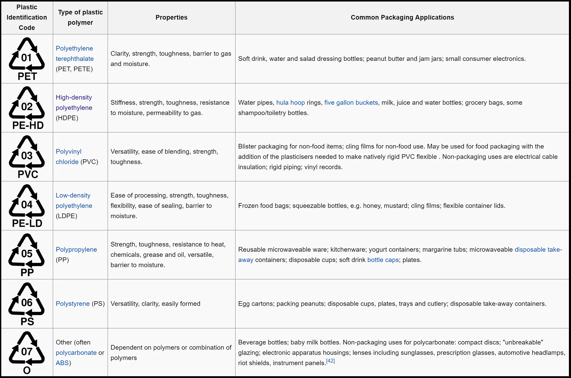

Material selection is important, as only some types of plastic (look especially at HDPE and PET, recycled as no. 1 and no. 2, which are more easily recovered than other types) and paper are easily recycled. Equally important, though, is avoiding mixing materials. Think of the categories an average household will need to separate: metals in one bin, plastics in another, paper in a third, foam peanuts on the cat (kidding!).
Now what do you do with a plastic bag with a shiny metal lining? It goes in the trash. A paper container with plastic coating? The trash. Two materials that could be recycled separately become nothing but waste when combined together. It’s important to make separation easy and clearly label the different materials for recycling in the appropriate way.
